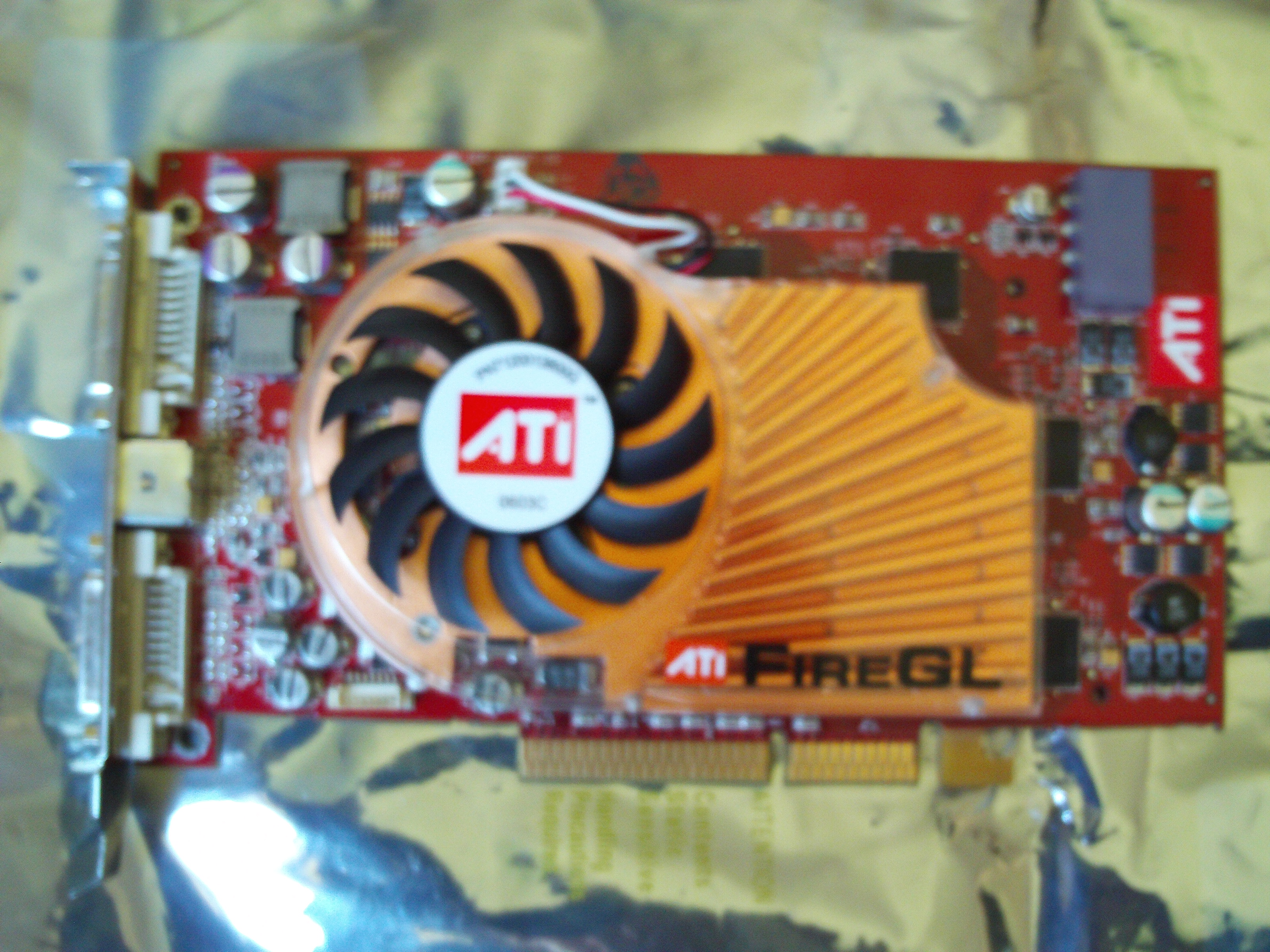

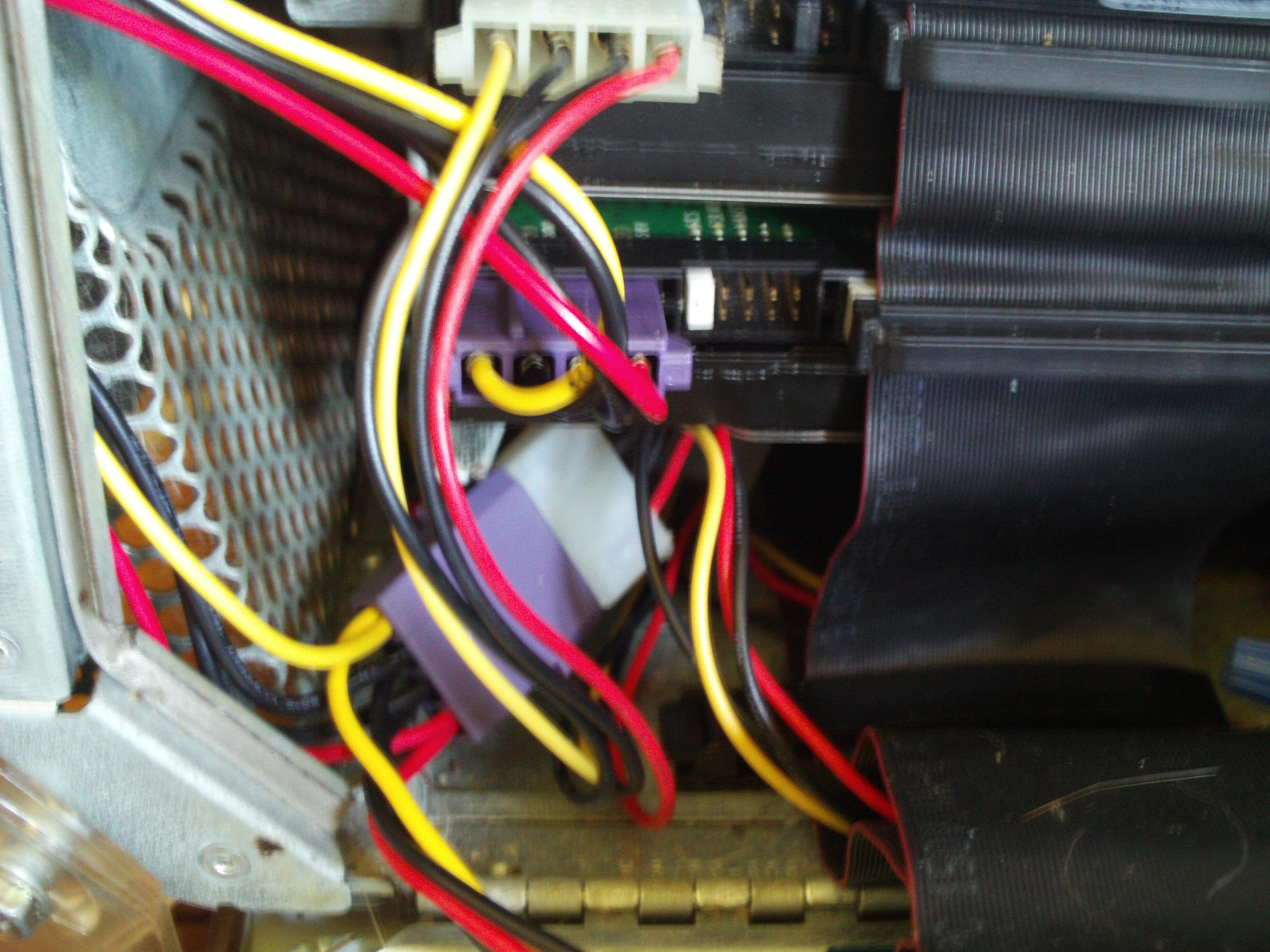

My eMac I think, is getting to the point in it's life where it will not beable to be up to par to be continued to be used as a Daily Driver PPC. I will be getting a FireGL (pre-flashed and pre-taped) for my MDD. So here is the point in this thread:
What to do? Since it's pre-flashed and pre-tapped it's just drop in and boot up (after connecting it to the pSU of course) right?
How does this thing preform in Tiger and Leopard?
Can i watch 720p Video?
How well will this preform over all?
you also Need to install the ATI Video drivers since your fireGL will most likely have a reduced rom with out an NDRV which the ATI drivers add
You definitely need drivers-I've run into that more times than I care to count with my flashed version of this particular card. It will come up with a wonky grayscale screen if you don't.
The FW800 MDD has an extra socket at the back of the AGP slot. Working from memory, you may need to remove the retention tab at the back of the card to get it to fit. Test it first, though-leaving the retention tab is always a good idea if you can.

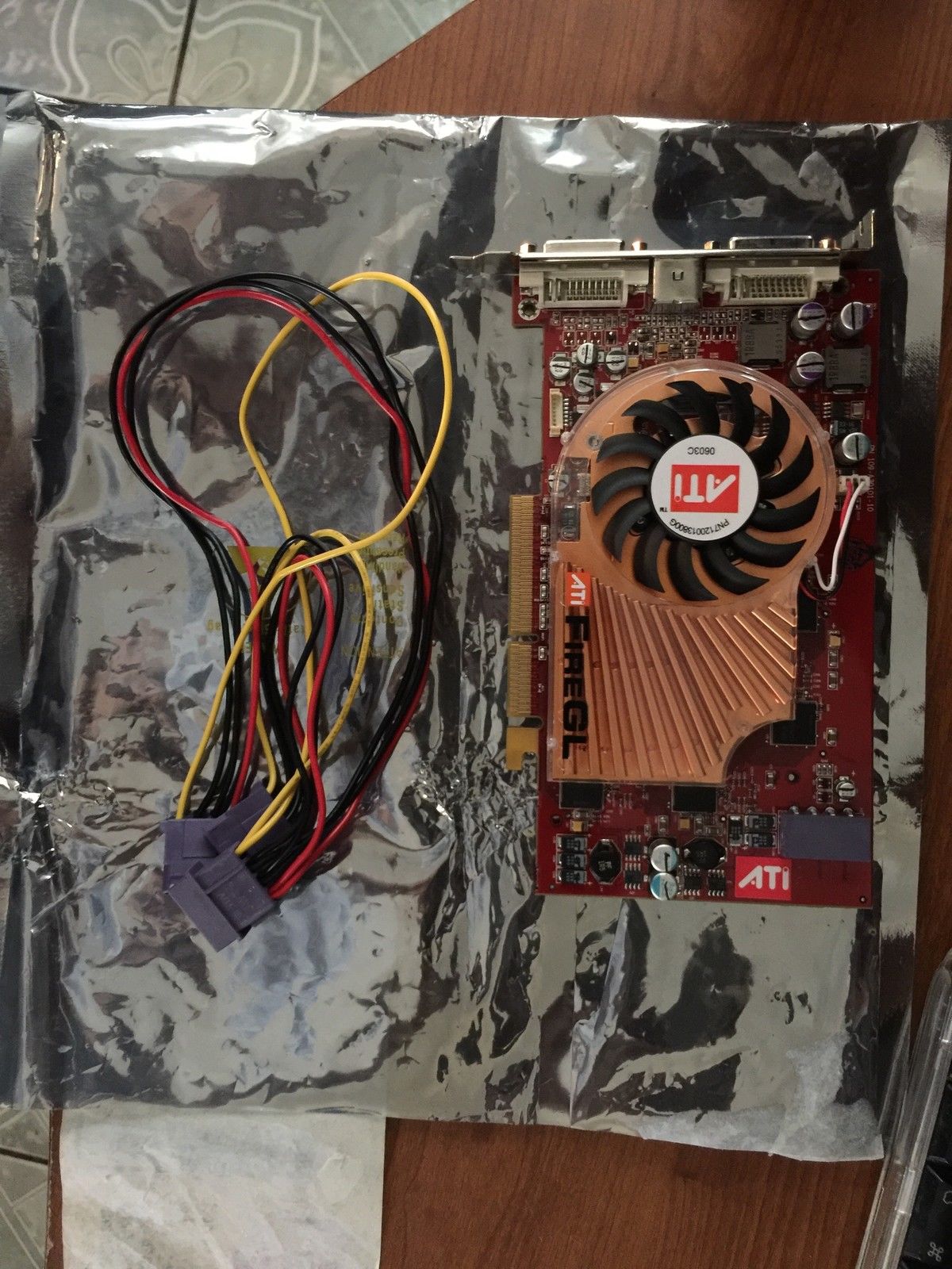

Thanks Bunns! I have ordered the card and it should be here between saturday and wednesday. I will probably install the driver tomorrow after work as I have no time today. I believe that, based on the pictures:
That the card should fit right in. The retension tab shouldn't have to be snapped off. This was the 1st upgrade because the failed DVI on the GeForce 4MX makes using the Mac a pain in the ass. Next, I will probably invest in one or two Sonnet Tempo SATA cards.

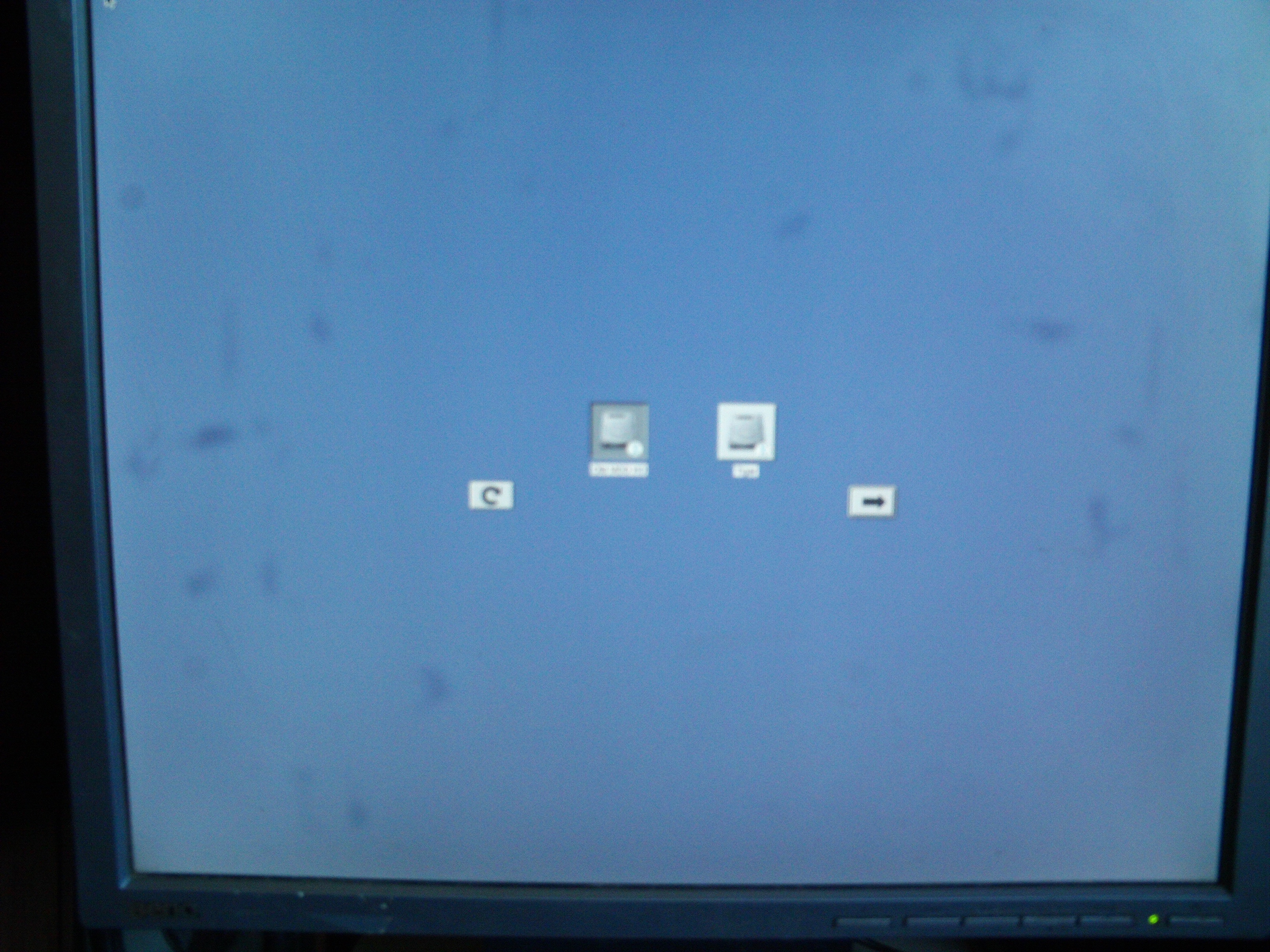

Could the lack of this driver possibly be the reason a flashed and taped FireGL X3 card just boots to a blank-black screen on my MDD?

sorry my bad for not checking the link http://support.amd.com/en-us/download/archive/macosx10-4x-3x-radeon this one should work (choose the 4.5.7 version one) the black screen do you get an open firmware boot screen? if not then I doubt the drivers will help since these drivers take effect Just as the OS loads the window sever... if you have a boot screen then the screen goes blank then these drivers might help

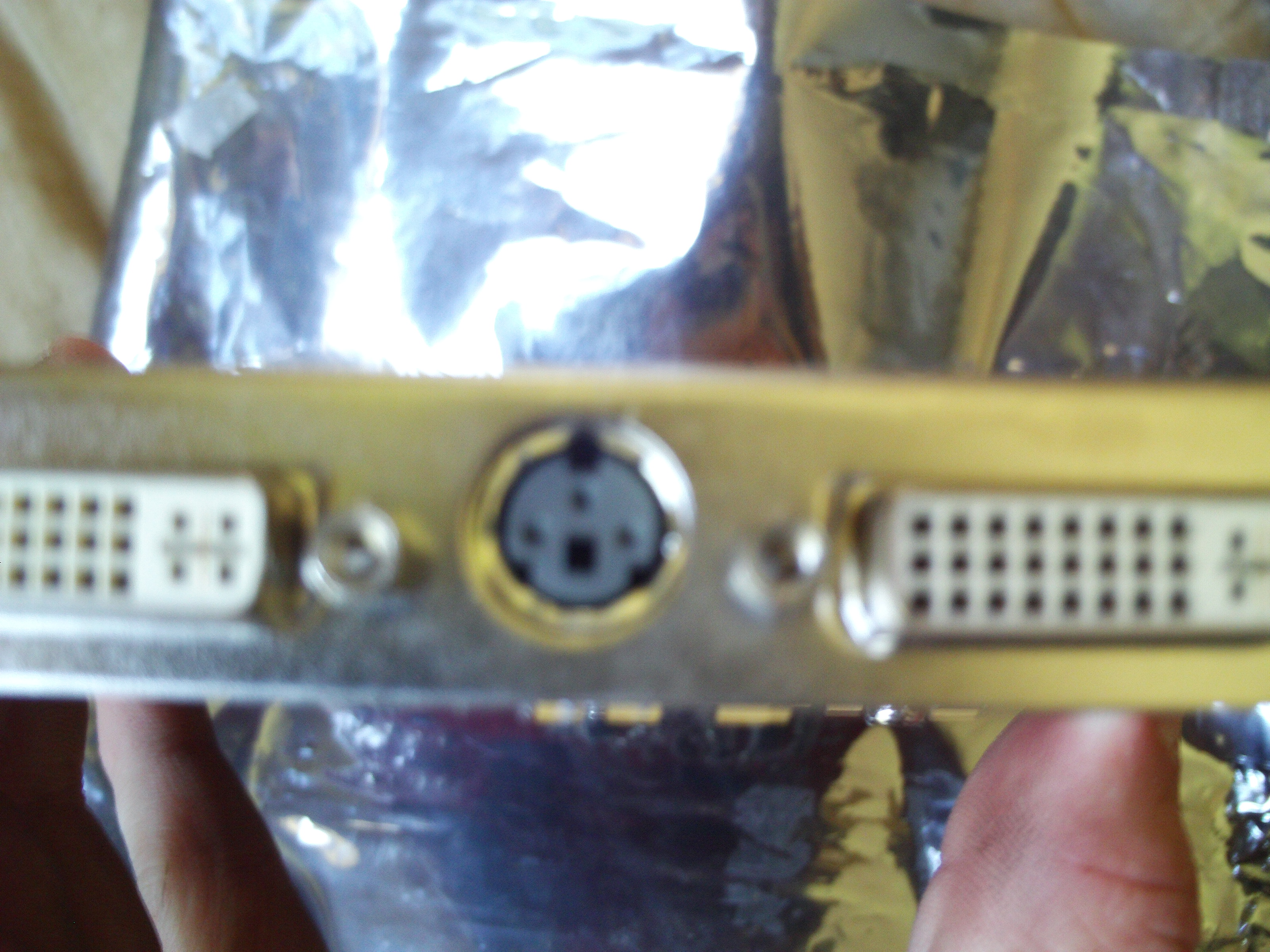

That port looks like an S-Video port.
Nice card!😱
It actually looks to me like the port on the old Appletalk boxes for "daisy chaining" computers together. S Video has four wires.
Not really sure what it is-it may be some form of S-video without sound, although I don't know why it would use the non-standard(for this application) port.
Mine has the same port, but I've never paid attention to it. I don't think it works in the common reduced Macintosh ROMs floating around out there anyway.
