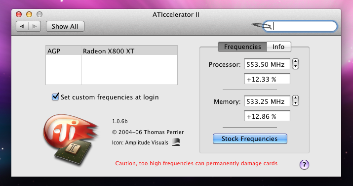

hey guys is it safe or a good idea to use ATIccelerator II on this card? Here are my settings so far:
with stock cooling in a MDD? thats like sticking a Magnet to a HDD to hold it up somewhere...

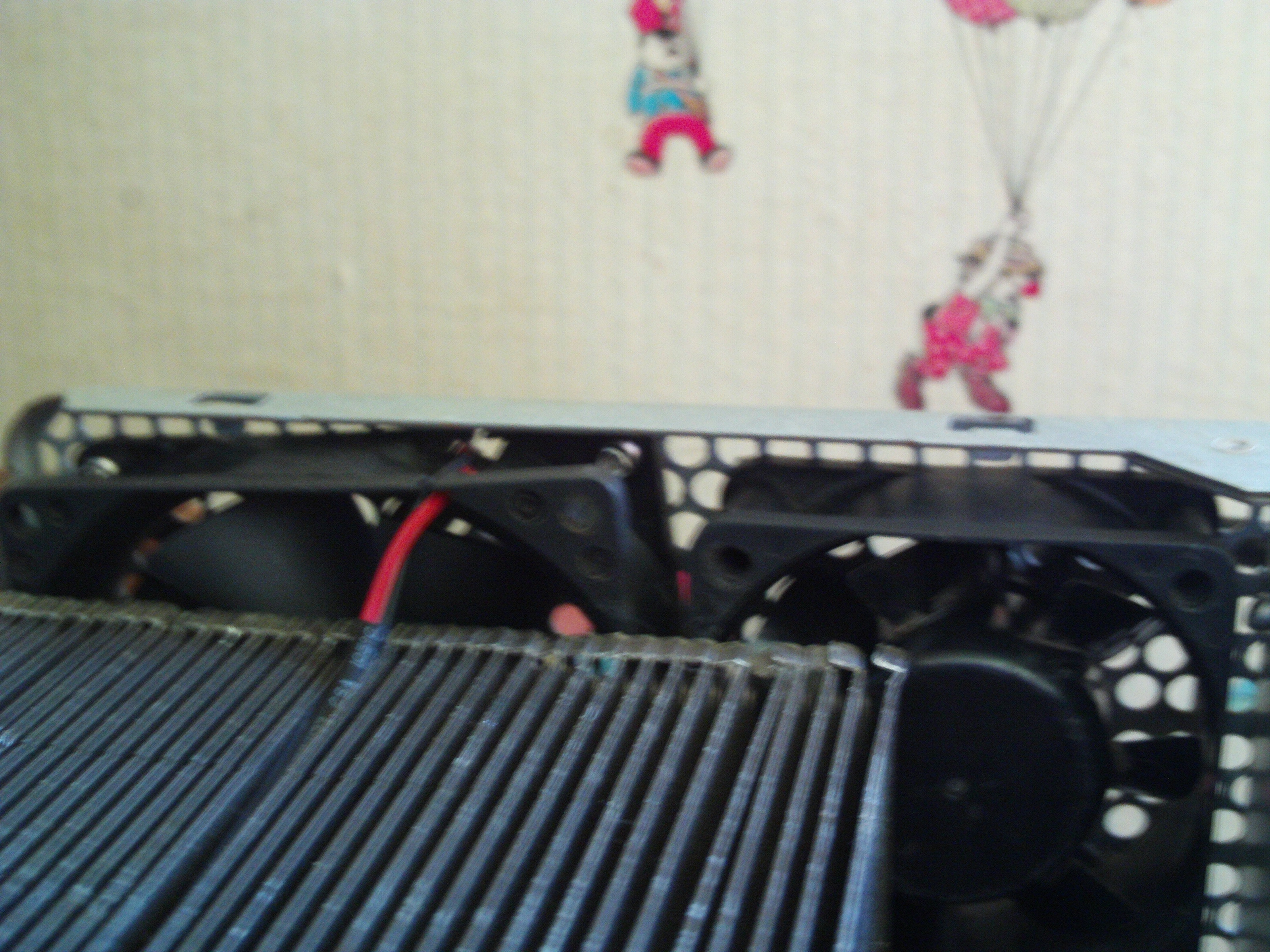

LOL. My cooling is far from stock tthe 1st thing i did when i bought this thing was add fans. The main fan is wired to the PSU to run at 7V, the ODD fan, and the 2 fans I added behind the CPU all run at 12V:
even with those fans your going to end up cooking it if you don't put on a Bigger cooler on the GPU it self... when I said stock cooling I was referring to the GPU so I would remove the OC
Thanks for the tip. Already done. My paranoia got the best of me and I didnt run it OC'd for more than 5 minutes

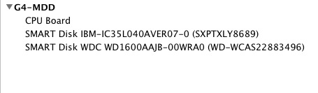

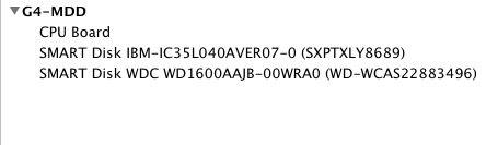

Does temperature monitor show the GPU? That would be a good way to see if the cooling setup is adequate.
Is there any programs that will monitor the SYSTEM temp and the GPU temp? Temp Monitor only does 3 of the 4 HDDs and the CPU
I don't think the MDD has the right "wiring" to read anything other than the sensors you are seeing.
Interestingly enough, virtually all 7400-class CPUs have internal diodes. These can be read with the correct programs in OS 9, but I don't think that there's any way to access them in OS X.
I installed two different programs on one of my computers(I'm thinking maybe a Cube, but don't recall exactly). One gave wildly off readings and reported the CPU temperature at 5ºC. The other gave what I thought were reasonable readings that actually fluctuated with load.
If you want temperature sensors on a PPC Mac out your rear end, get a G5.
You would think ATI would have a program to read it's own temps. Why does Tempature Monitor only give me ONE CPU reading and not both?
Temperature Monitor has one sensor on the CPU circuit board, and not on each individual CPU as one would like to see.
