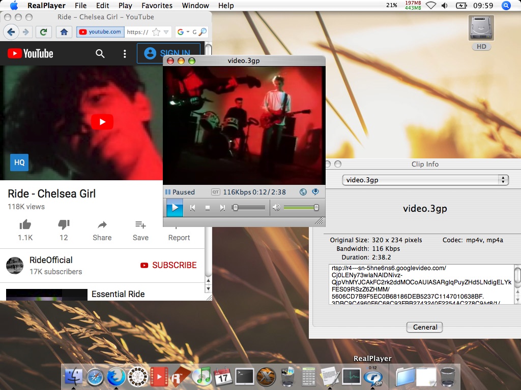

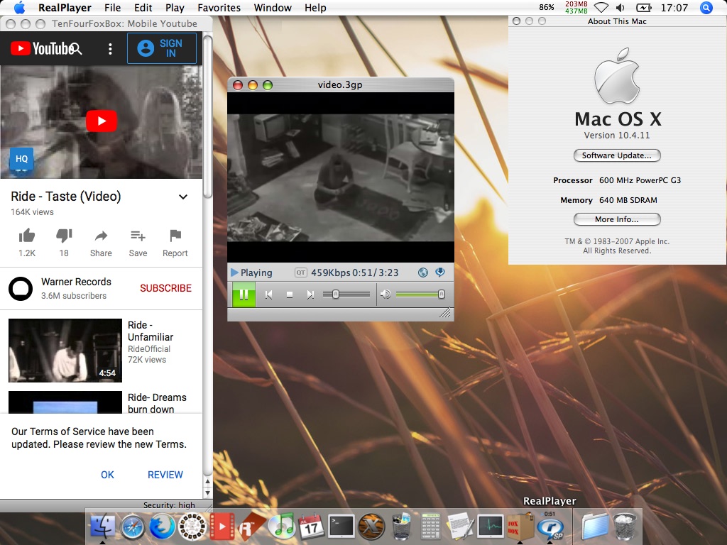

As of now (certainly on Tiger) the way to reach Youtube on low end machines is with ArcticFox and it's already installed downloader plugin then change the UA overide for Youtube to:
NokiaN90-1/3.0545.5.1 Series60/2.8 Profile/MIDP-2.0 Configuration/CLDC-1.1
This will force 3gp streaming playback into QuickTime or in my case, RealPlayer which is better (on my G3 600Mhz iBook):
On a G3, like you showed in many threads, Realplayer is the way. Some very old version of VLC seems to be very good at playing back low quality 3gp even on very low end models, but the quality is less than desirable (as using Tiger on those).

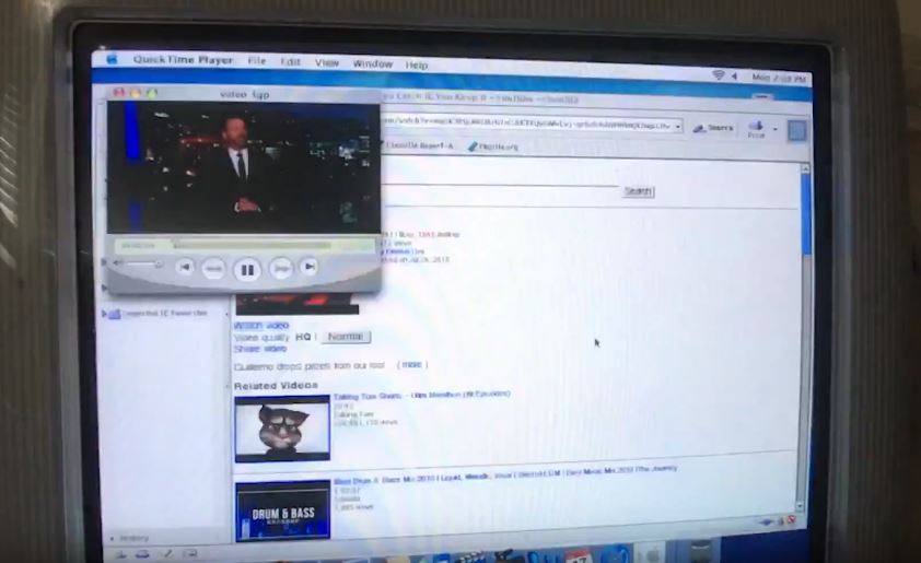

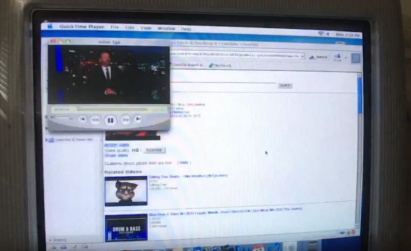

What about YouTube on Classilla? (10.3.x and earlier but not OS 9)
clicking a video launches Quicktime automatically and plays the video.
And shouldnt the same work for TFF with Classilla UA?
Photo credit:
Reactions: Dronecatcher
