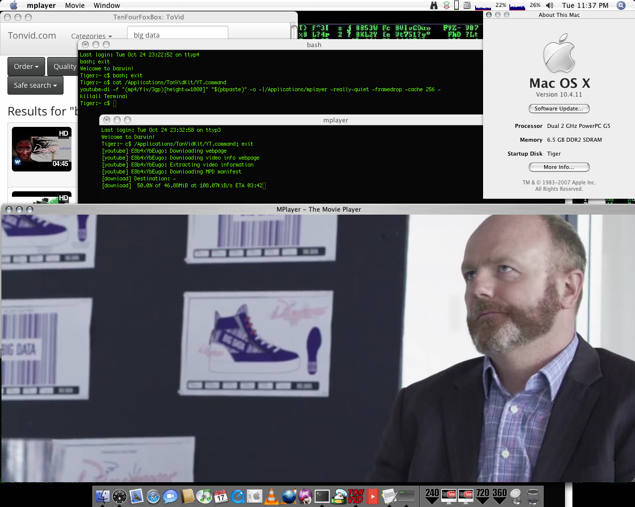

Ive been lurking here for a bit getting my PPC mac up and running and just had to join to thank you for putting this together. Its works AWESOME on my duel G5 running Tiger. Here is some 1080 action. Whats holding me back now more then anything is my adsl line. If I start the video then hit SPACE and let it buffer for up a bit is plays mint.
