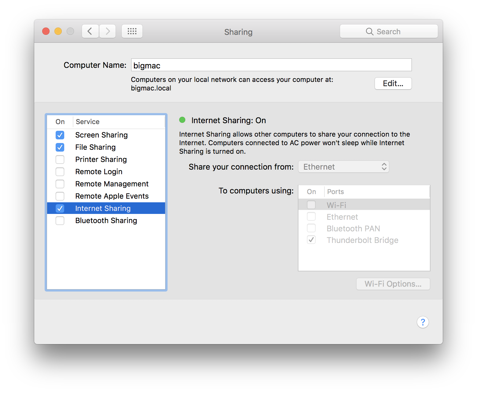

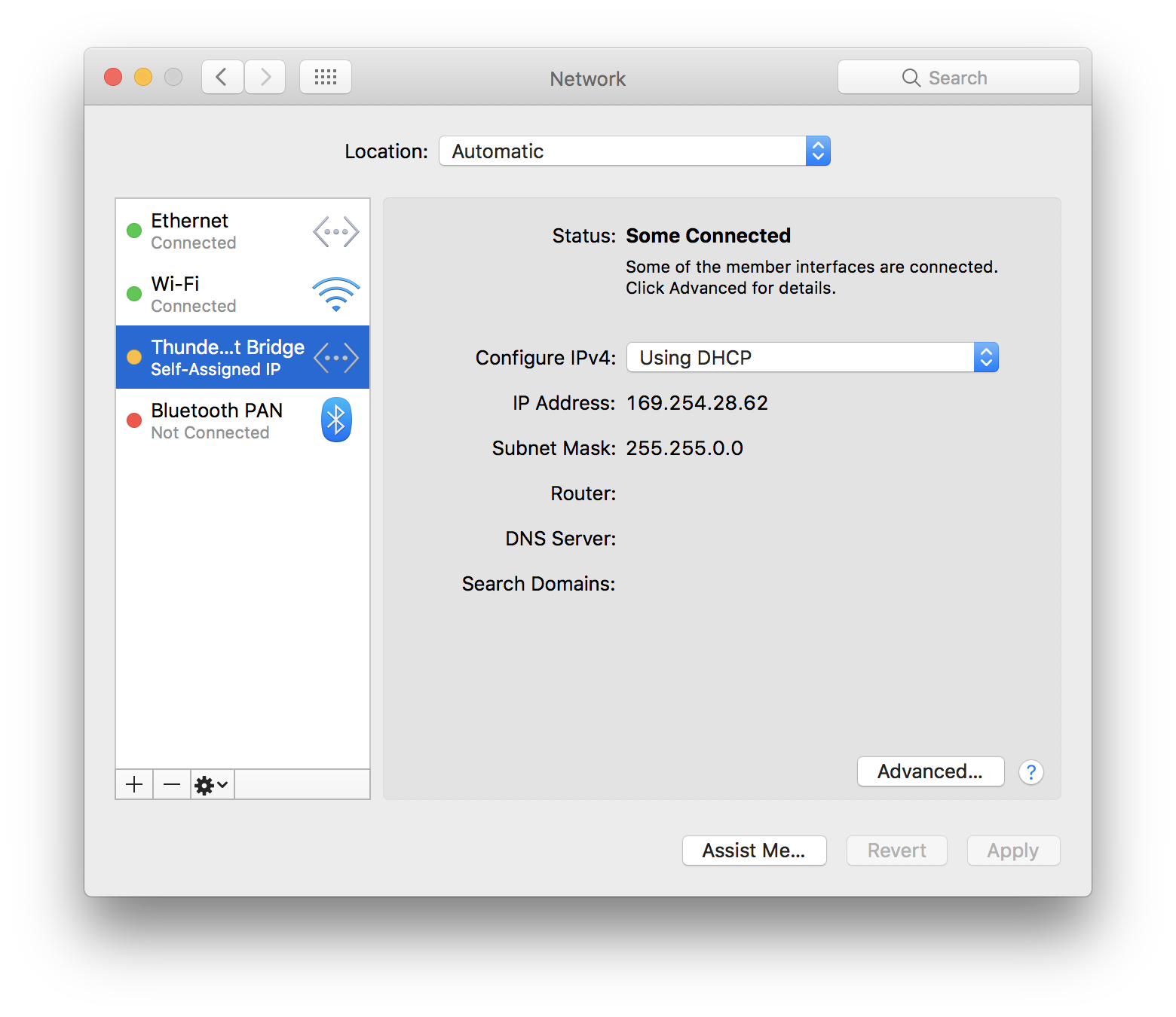

Connect the iMacs via thunderbolt, go into network settings on each machine.
In my case I am sharing the network connection from one Mac to the other over the thunderbolt since I only have one Ethernet jack in my office.

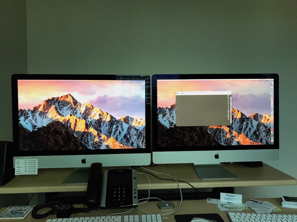

New iMac on the right, old one on the left. Screen share...

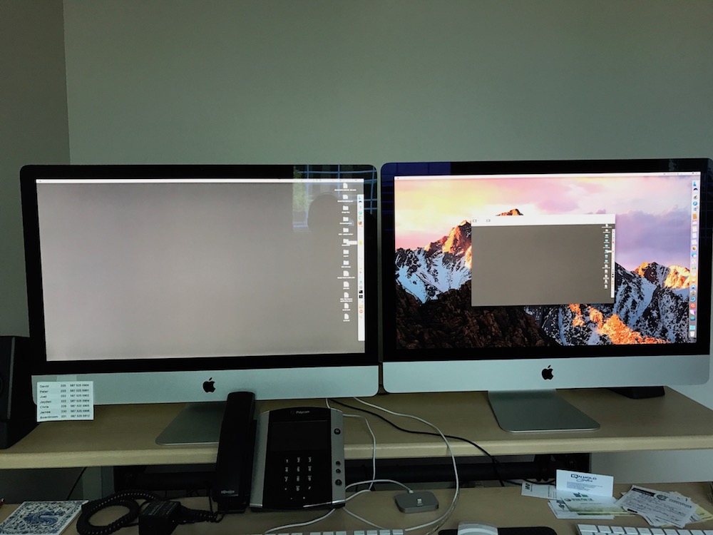

turn on target display more on the old iMac:

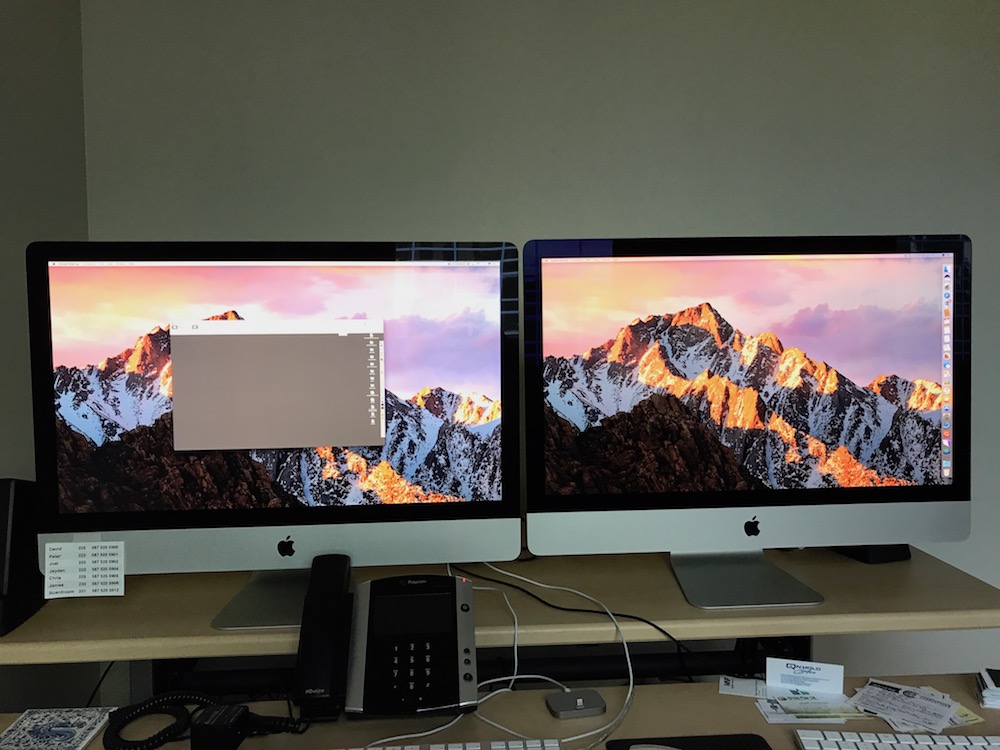

move the screen sharing window to the screen of the old iMac.

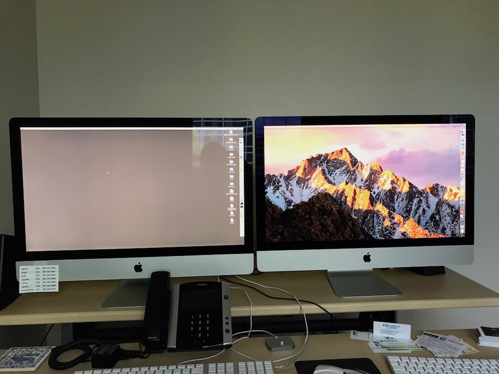

maximize the screen sharing window:
One can drag files from finder windows on the left to the desktop on the right, at about 350 MB/second, which is probably as fast as the SSD in the old Mac can read the data.
