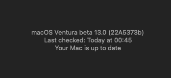

Beta 11, still no resolve. If I hook up with usb-c to HDMI, it works, but not at 5K like the monitor is...
Is this an Intel MacBook Pro issue? I am looking to upgrading when the new M2 when they finally come out, but would hate to spend the money on that when I can't hook up my 5K monitor to it.
here we go again guys, I just updated mine and the issue has returned
I have a Mac M2 Air Running Mac OS Ventura 13.0 Public beta 11
(22A5373b).

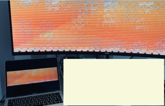

Have a customer that uses a macBook Air 2019 with a Wide Philips screen, same problem. Shift startup works for now.
See photo of screen / machine.
