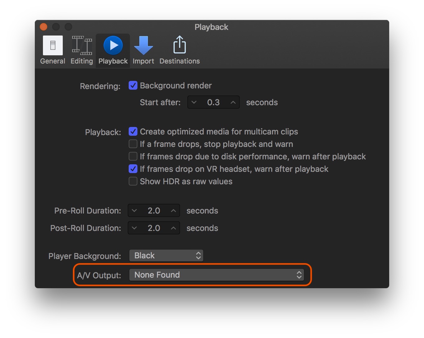

FCPX can set a dedicated screen / TV just for media play back inside preference.

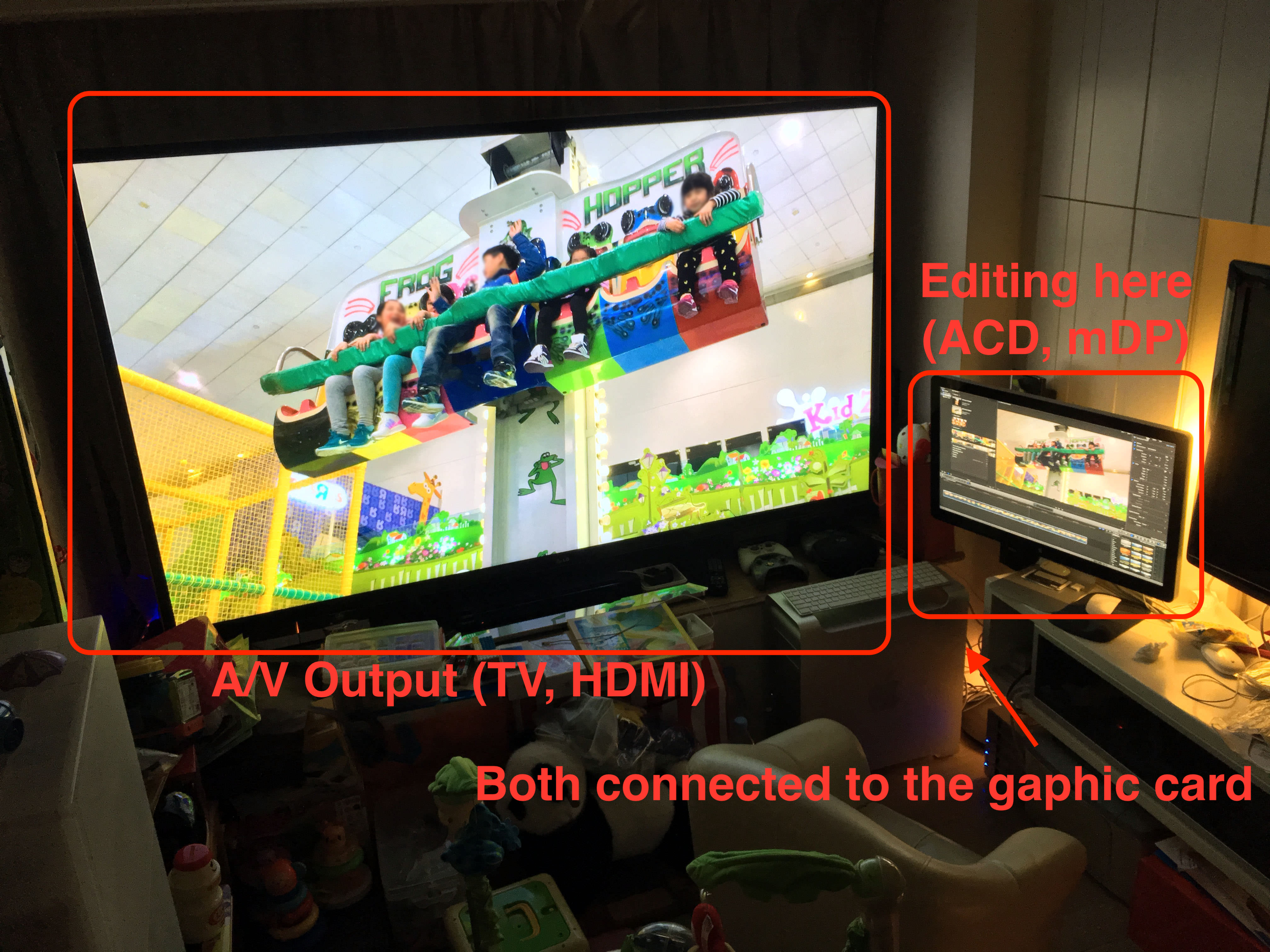

If you want a physical switch, I think pretty much any switch will do. Since you mention it's a TV. So, I assume HDMI work best. Just connect a simple HDMI switch (e.g. 2 input, 1 out, Computer input 1, empty on input 2, TV on put). And switch the input to The computer will let your TV work at A/V output display. And when you switch the input to an empty slot, the TV should be disconnected. In this case, the low tech switch should work best, prefer mechanical switch if you can find one. If the switch box is too high tech and support HDMI link, it may let your Mac stay connected even the input source switch to empty.
I think there is some switch is the other way around, 1 input, 2 output. This should also work (switch the output to empty to disconnect the TV from the Mac).

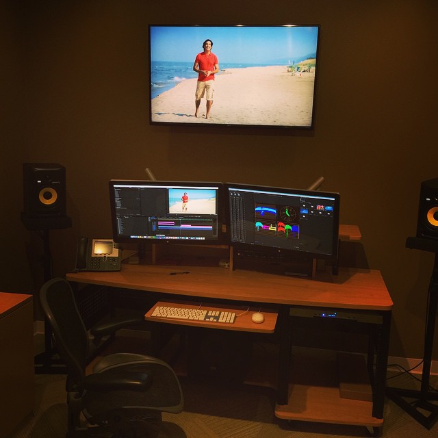

So...I guess I'm just confused. I think you're over thinking this. I have a similar setup in one of my bays and it works just fine. I only ever turn the 50" 4k TV on when a client is in there. 2 ACD's for editing and the TV acts as a third display when it's on. In Premiere Pro for example, I can send playback to one of the editing displays and the client preview TV at the same time. Another poster showed that FCPX treats HDMI (TV) signals as full screen preview output only. I've used that before in this setup as well.
When you're not using the TV, you just click the power button on the remote control and MacOS reverts to a two display setup. I really think you're over complicating it here. In system preferences, you can arrange the three displays anyway you like so you're not confused as to where your cursor is. Very rarely has that ever screwed me up. I use this every single day, it's not tricky or confusing at all.
Yep, this works in both of my bays. 2012 cMP with RX580 and a 2013 piece of crap that's currently sitting on a repair bench at the Apple store waiting for someone to decide how they're going to fix it.

@rawweb wow nice setup 😀 so clean and neat
yep im not shore i understand why it's to complex to turn the display off, or grab a switcher etc.
Thanks @orph! I tried hard. Currently designing a new video production suite for a new building right now. The corporation I work at is growing so rapidly, they want their conference rooms back!
