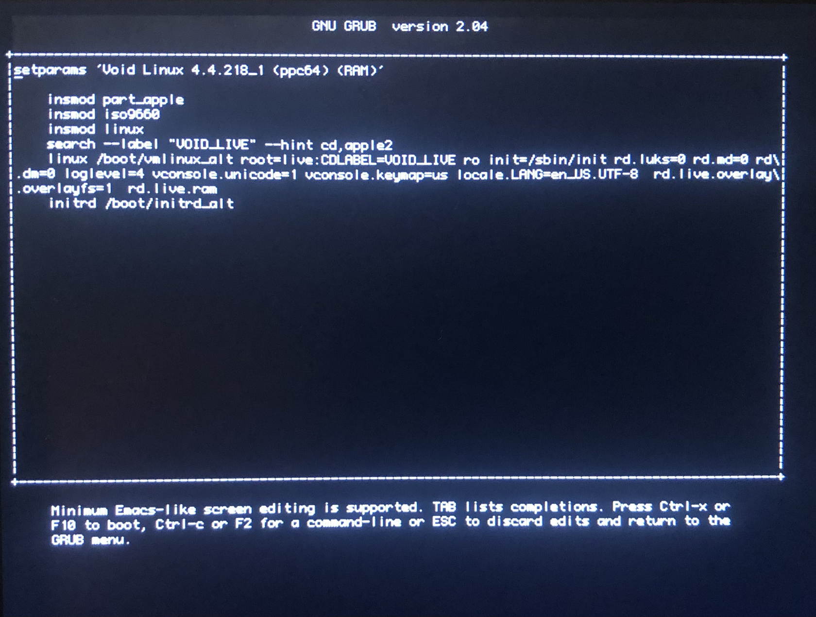

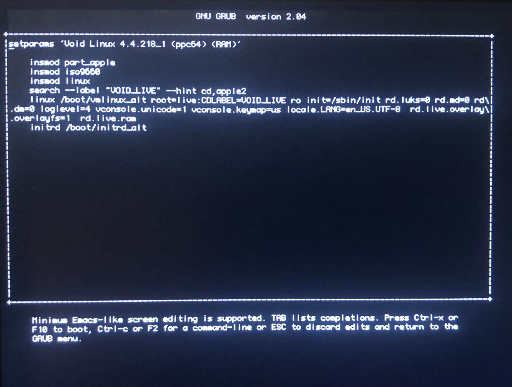

You can edit grub at boot. Using the grub editor I had to add video=TV-1:d to grub for my GeForce fx5200 to work on void64.

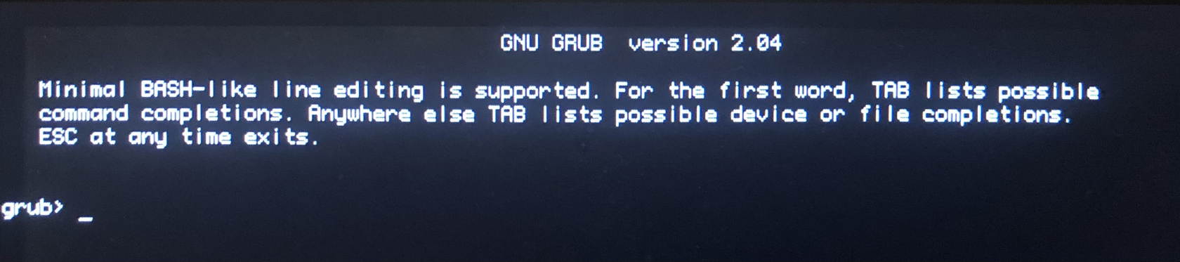

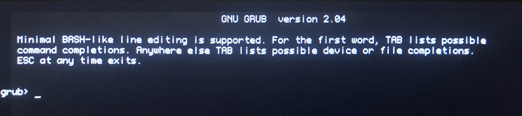

Looks like that i need a little bit more instructions
i can press "e" then i get this:
or i can press "c" and get this:
Linux for Dummy's until I understand the Basics of GRUB, please.
