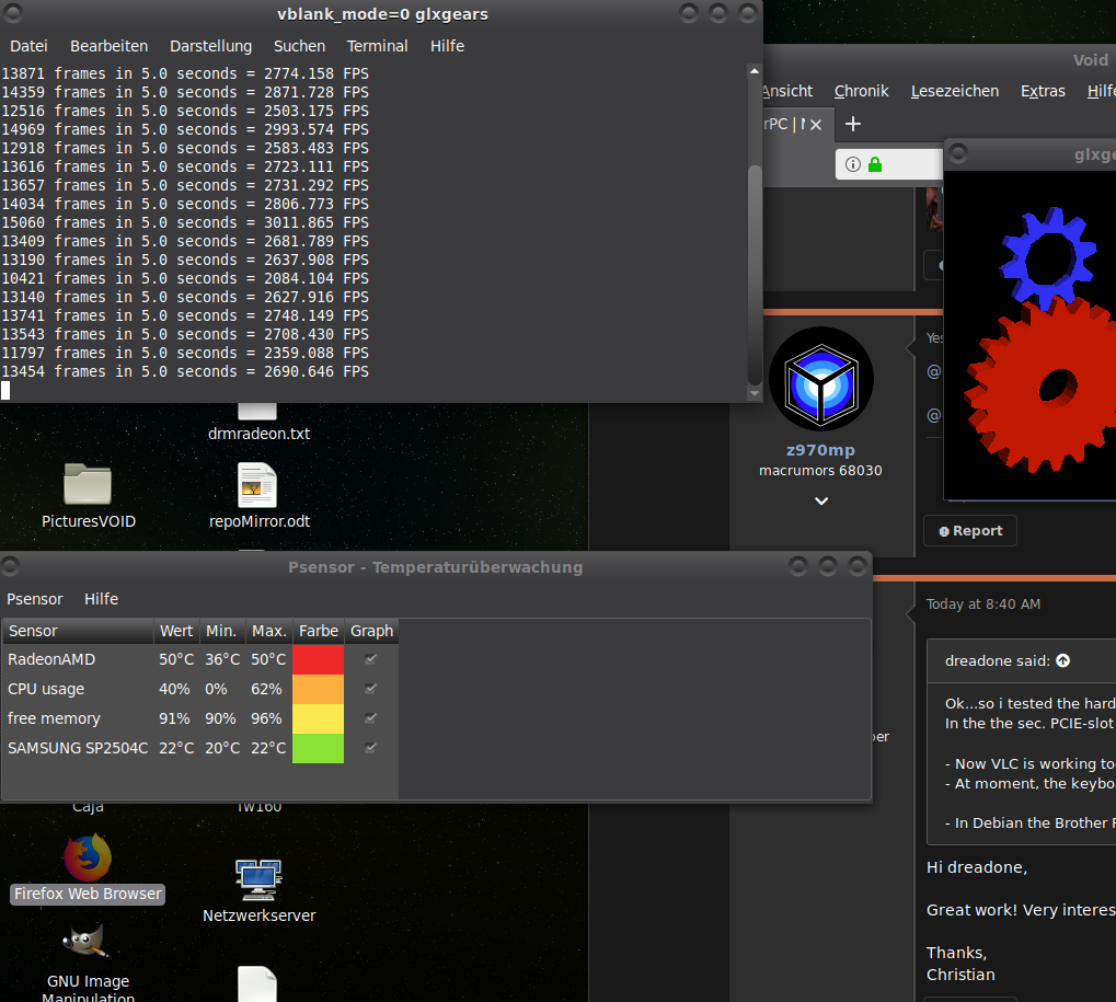

Hi dreadone,

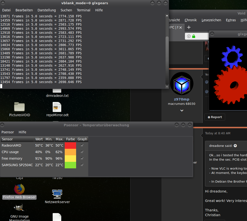

Great work! Very interesting! Could you please post the output of “vblank_mode=0 glxgears” with your Radeon HD6970?
Thanks,
Christian
Here is the output:

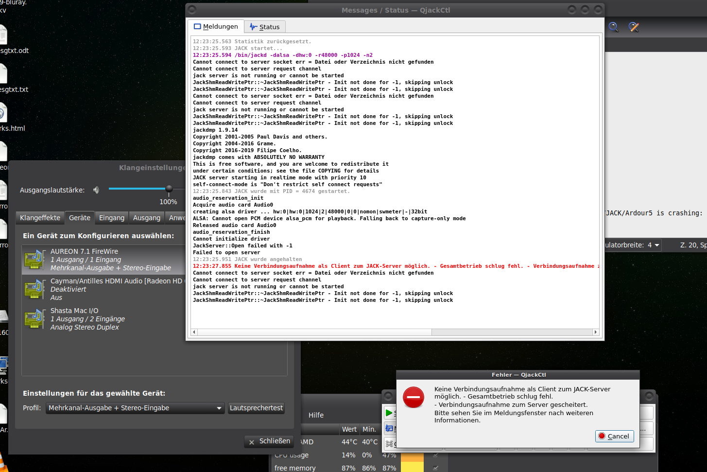

- Firewire Soundmodul terratec aureon 7.1 works (VLC for example), but in ALSA/JACK/Ardour5 is crashing: see pic.

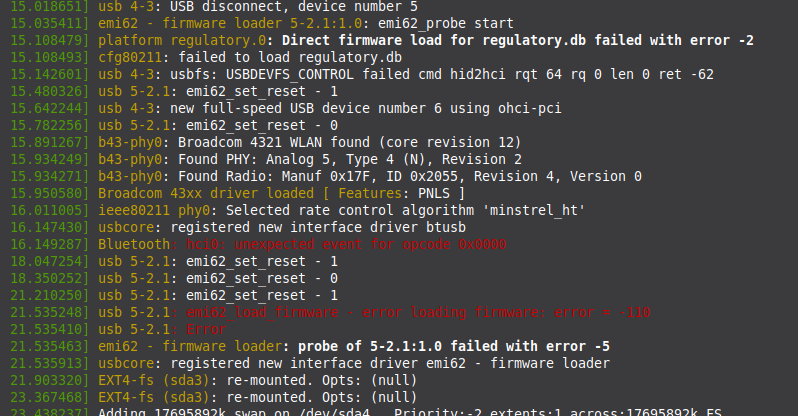

- USB Audiomodul Tascam us-428 is not recognised. ALSA contain Tascam 428 firmware and .conf in /usr/share/alsa/firmware. Maybe there is something missing?
- USB emi6/2 audiomodul: firmware is in the lib/firmware folder. May be the firmware loader is not working correct?

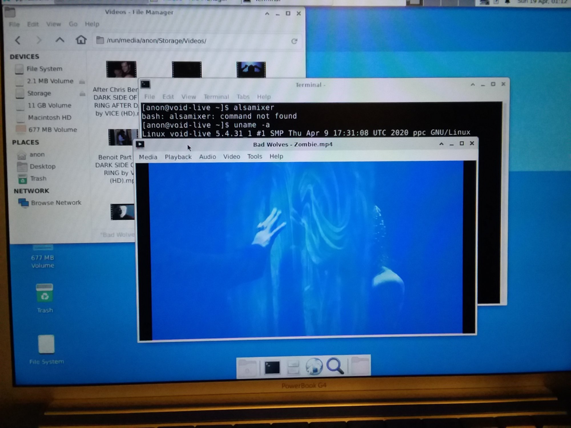

Hmmm. So i was going to install the new 32-bit iso on my powerbook again to play with, but then i noticed it has the same endianness color issues i ran in to with spiderweb/interweb with online videos, but this time for regular downloaded videos. RGB is reversed. :-/
Can anyone else verify this? Or try another player on an installed system?

@wicknix another player is likely to work alright, probably an endianness bug in some gstreamer component, likely a specific codec plugin, since gstreamer otherwise seems fine
