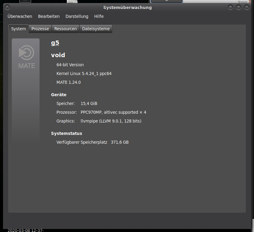

Kernel here is: 5.4.24_1 ( see picture).

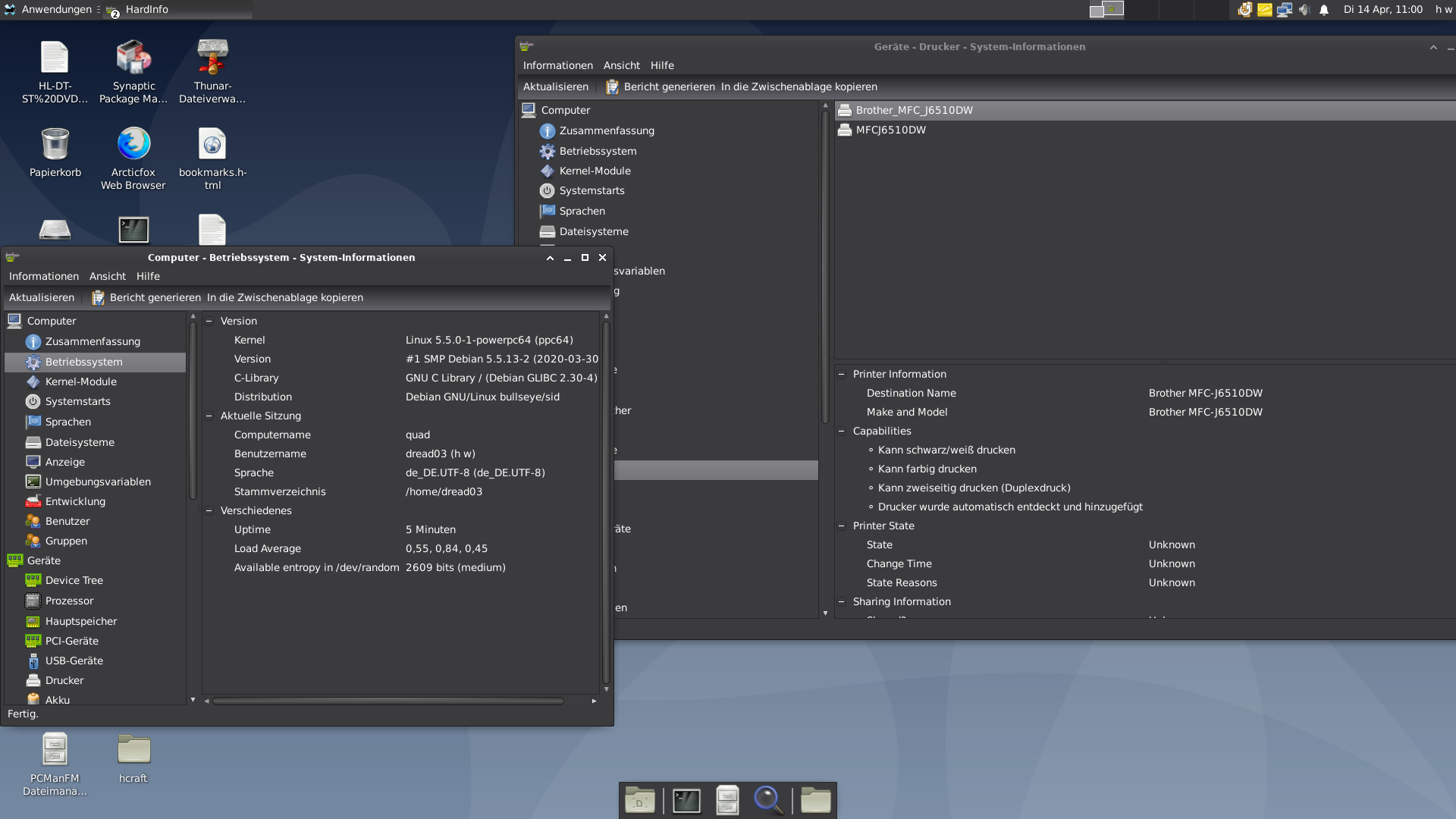

For the Brotherprinter: in debianppc i installed the driver from the brother website and it works.

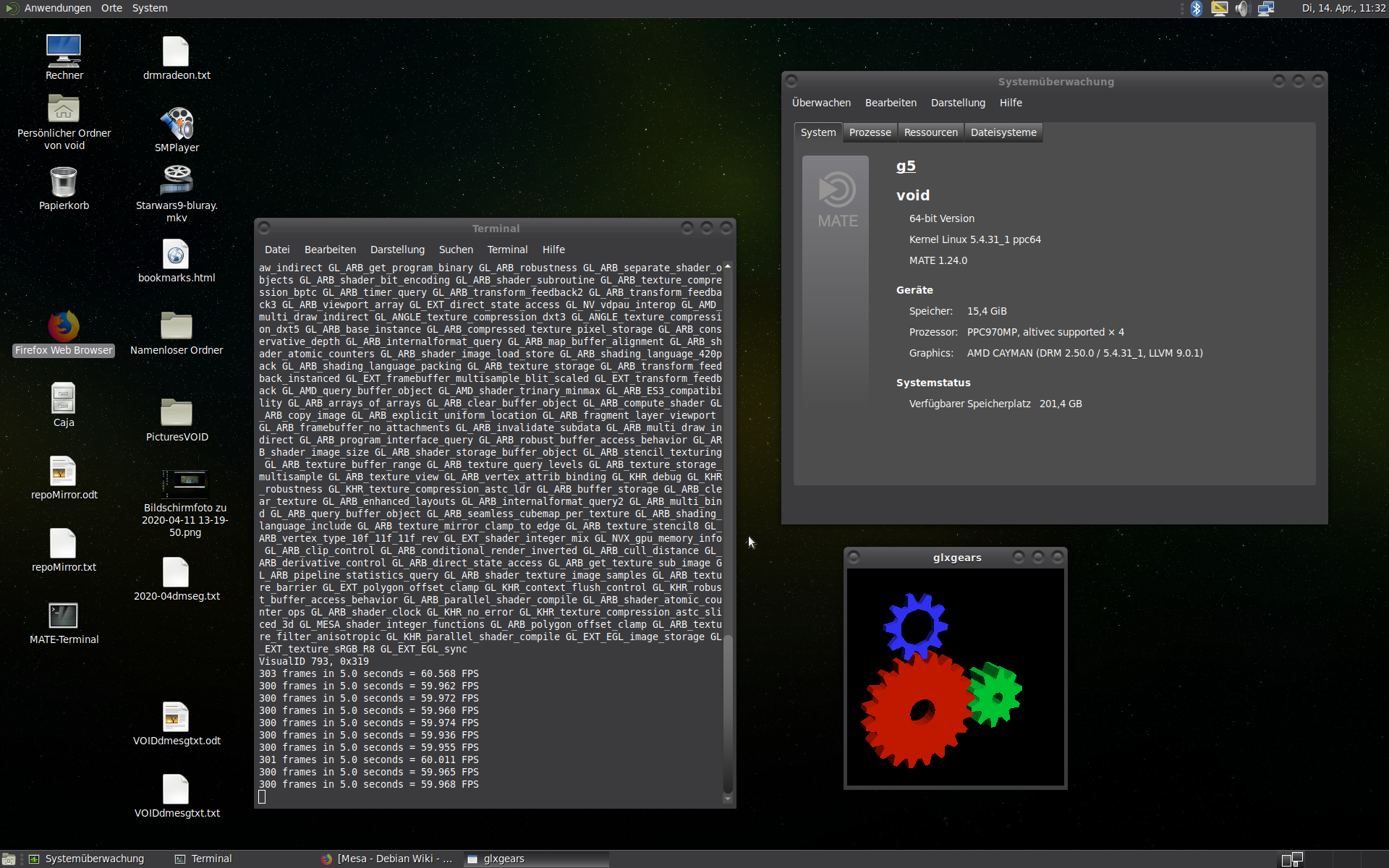

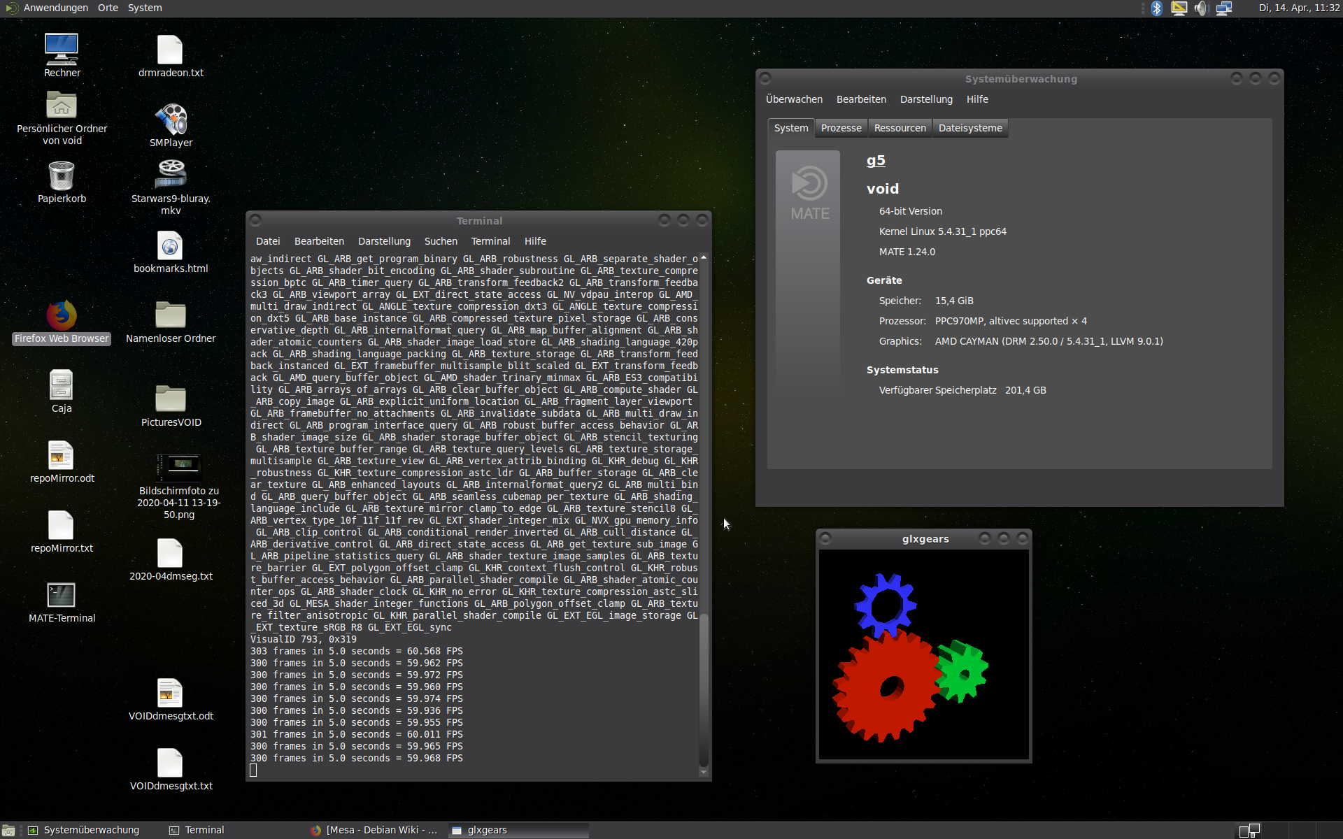

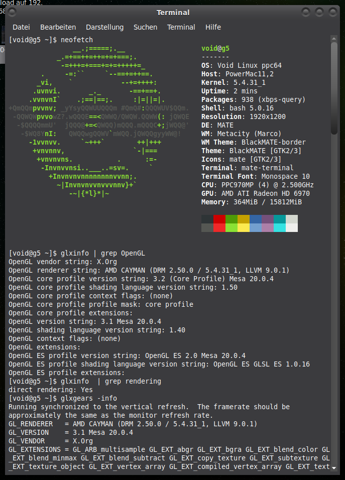

Ok...so i tested the hardware-acceleration:
In the the sec. PCIE-slot the cards working, also the AMD6970 Cayman (see pictures).
- Now VLC is working too.
- At moment, the keyboard-fault is to solve. It is really exhausting for me, to write. Changing the keyboard-layout does not help.

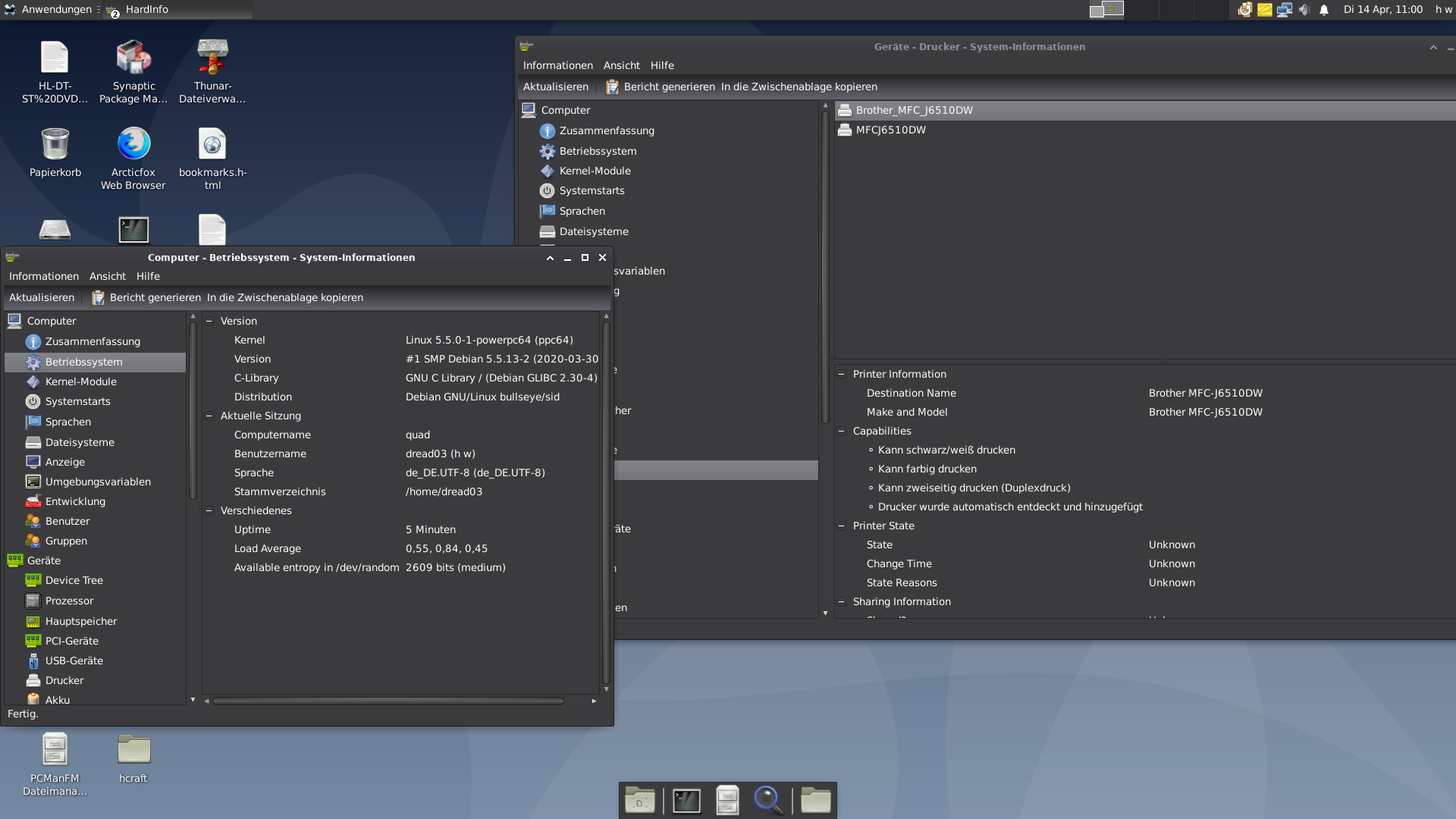

- In Debian the Brother Printer is working, with cups (s. pic.).

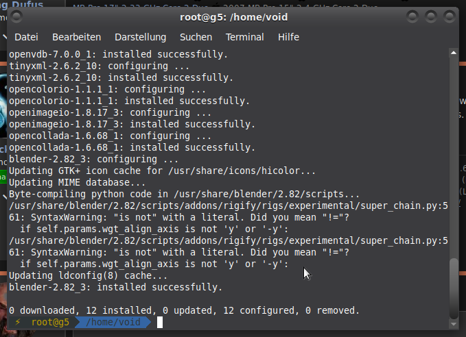

Hi, I tested some app in my configuration (g5quad, voidlinux) :
- So I installed "Blender" successful (see pic), but the app does not start and in the taskmanager it is not listed.
Hi dreadone,
Great work! Very interesting! Could you please post the output of “vblank_mode=0 glxgears” with your Radeon HD6970?
