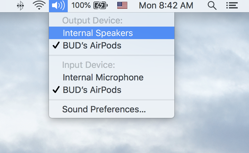

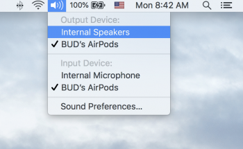

I have not an iPhone, so i do all with my Macbook Pro
-At the step.7: Don't adjust to 100% volume, 70% is fine.
-Step.8: (If you using a Macbook ) press and hold option key + click on speaker icon -> Choose "Internal Speakers".
-After step.11: press physical play button on the ipod for shuffle playing. Then enjoy 🙂
Try agian if the first time doesn't work.
P/s: If you hear crackling sound, don't worry, just turn off bluetooth then turn on again.
