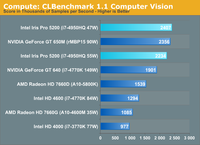

In compute HD5200 was faster than GT650M. Person who complains that software is not able to use the hardware, and blames hardware for it is either stupid or uneducated.
HD580 will only increase the differences.
GT650M core config: 384:32:16 Cores/Tex/ROPs
HD5200: 340:40:4 - as you can see ROP count is bottleneck here, thats why EDRAM helps with performance a lot.
GTX 960M - 640:40:16 - ROP count the same as Kepler, 25% higher number of Texels, and much higher number of cores.
HD580 - 576:72:9. If you would ask me, because the nature of iGPU ROP is still bottleneck here, but you can see the leap of Texels. It will not be bottlenecked by filtrate(TX), nor it will be bottlenecked by Memory(EDRAM). Graphical performance of HD580 is higher than GM107, but it lacks a bit in terms of amount of execution units. The core count is also very reason why HD580 is rated at 1.15 TFLOPs of compute power.

Thank you for CAD and Photoshop benchmarks 😉 And what dinosaur is 650m?

So explain to me, why HD5200 was faster than Kepler if you say that Intel iGPU was rubbish? Why Vegas for example shows that iGPU was faster?
Why does compute performance matter in video editing, for example? At this point you are trying to prove me that:
A) I do not know anything about GPUs.
B) That you are right, and I am wrong.
But in all this you completely miss the point of iGPUs, and dGPUs, and their compute performance.
You show some opencl benchmarks. As far as I know nvidia develop they cuda and dont bring much effort in opencl. Also little kepler is strictly gaming not compute card.
For god sake...
Even if GPU is not compute focused it has Compute performance regardless, because that is how GPUs are currently developed. OpenCL vs CUDA. Its obvious why Nvidia develops CUDA - its their own proprietary API, that locks people to Nvidia hardware. OpenCL is open Source, and can be used on any hardware, any platform. It focuses ONLY on Compute performance of GPU. There is no magic here.
P.S. CPU + iGPU 1.15 TFLOPs of compute power in 45W Thermal envelope.
CPU + dGPU - 1.3 TFLOPs of compute power in 95W thermal envelope. You could park second CPU with iGPU in that thermal envelope with much better result. That is efficiency.

It's actually held up surprisingly well. I can play most video games on it. And I use it for game development, video editing and image editing. The fact that the Iris Pro will blow it out of the water is what makes me think that an iGPU isn't completely crazy as an idea.
