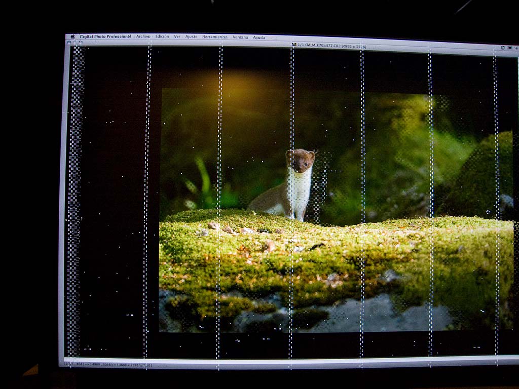

Mine is assembled in China too... and the frequency of this garbage screen and crashing is increasing... OMG can someone at Apple give some answers or some insights on what the F@#^ is going on?

Exactly the same problem many times a day here with a 3.0 GHZ 8 core and ATI Radeon.
After many calls to the inutile technical service at Apple Store ("Unplug and plug the computer..., repair permissions..., Reset PRAM....") I asked for a new computer. After two weeks some days ago I received another new one... with the same problem again (see photo).
I have been working profesionally as a Graphic Designer and photographer with Macs from 1982 and never had a so bad product from Apple. Lots of Mac forums have the same problem in Spain, Germany, Australia, USA... It seems Apple has lost his traditional quality control.😡

I reported earlier on the same common freeze issue on a since-replaced machine. On the new machine, I've had a dancing pixel issues that I haven't seen anyone report here (or I missed). No outright crashes yet though.
I've noticed the following on the new machine and have been able to recreate -- dancing pixels in very dark/black areas of images and desktop backgrounds. It happens most of the time with large black patches on the screen, but not otherwise. I was able to re-create with the default Leopard outer space background, a couple of the mostly black backgrounds in the Black and White folder, and some jpgs blown up to full screen with large black patches. It's quite odd. Has anyone else experienced this? As I mentioned, no outright crashes with the vertical lines (the common one) that I had with the old machine.

Edit -- should clarify what I mean by dancing pixels... white/light pixels randomly flickering around the affected area.
