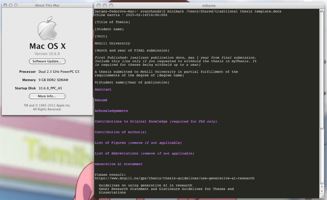

Anyone interested in a terminal document reader/converter? No dependencies (zlib at runtime), basic, but with support for math symbols, emojis, Asian scripts and some layout.
minimark in PPCPorts
Alright, here's that for ya. Ran into a small snag with dependencies but that was dealt with real quick; shouldn't adversely affect these results.

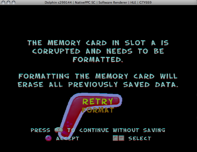

I've been kinda going back and forth between different projects, making little bits of progress wherever I'm having the most fun.
I can mostly boot GameCube games in Dolphin now, but a lot of porting work is still required:

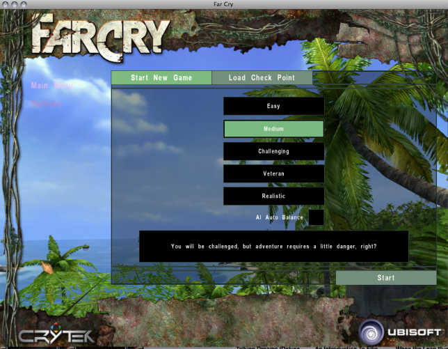

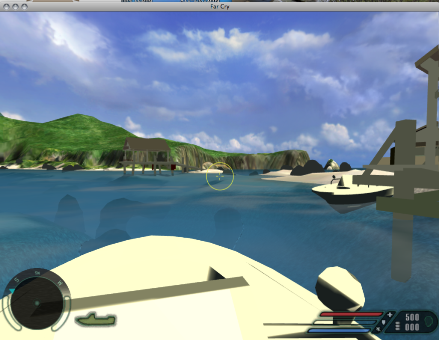

Here's a work-in-progress port of Far Cry/Cryengine (On my G5 Quad running Leopard):

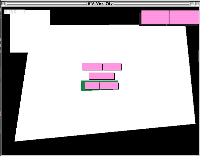

Starting to get the hang of this OS 9 porting thing. Kinda got Vice City working:

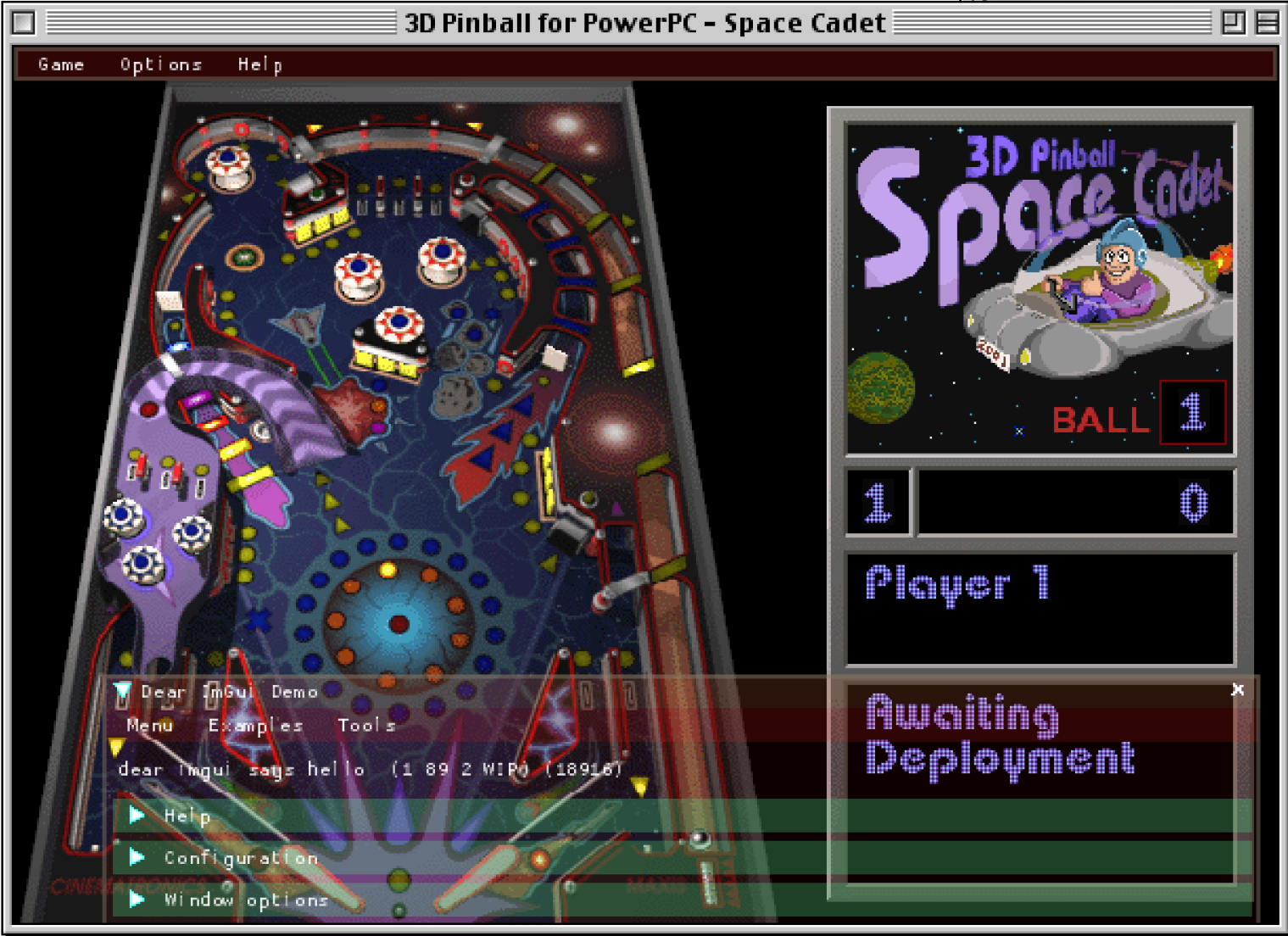

Pinball.. (and ImGui)

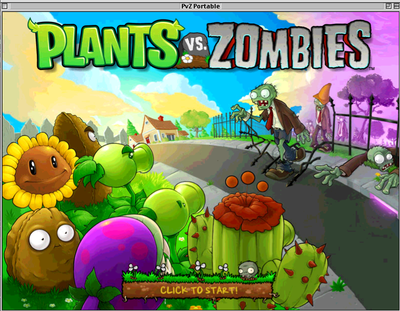

PvZ...

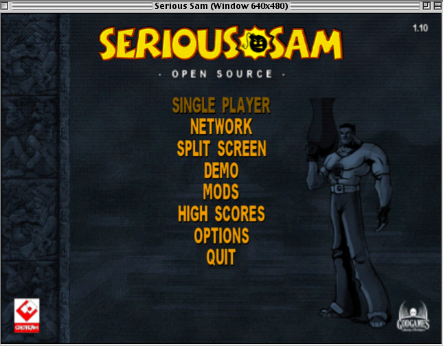

Serious Sam:

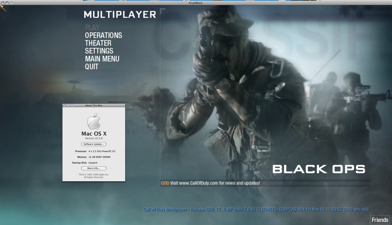

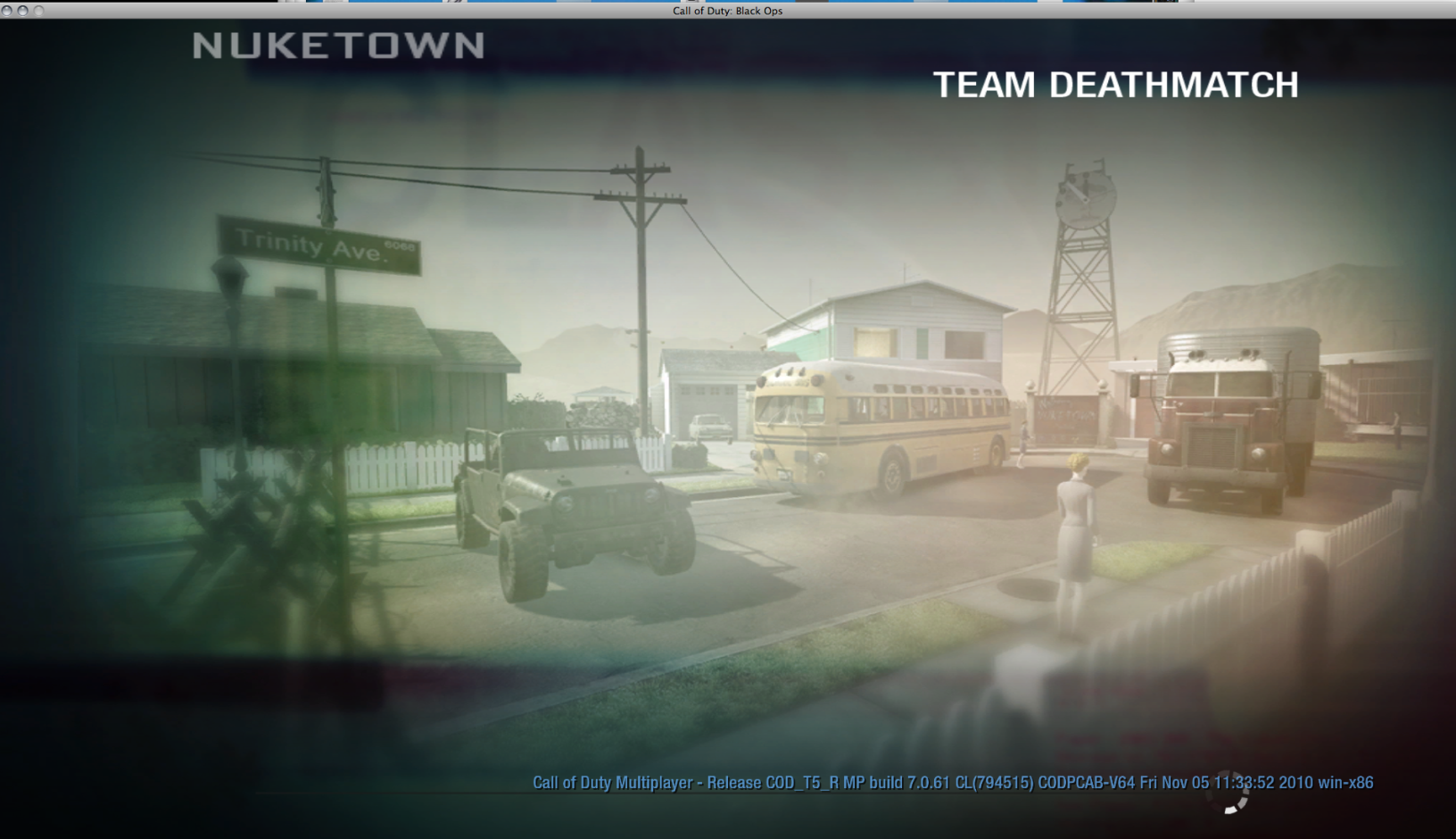

Took a look at that Kisak-COD project and a Linux/OpenGL port that someone else had been working on..
It was surprisingly easy to get it building this far, and because CoD 4 and Black Ops have pretty low scene complexity relative to the newer games in the series, these games should actually run pretty well on PowerPC.
Pretty cool stuff.

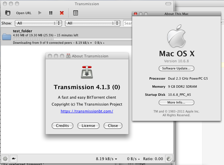

@srp How difficult would it be to port 3D Pinball Space Cadet to OSX, and what made you port the Windows version instead of just using the Maxis original?
SpaceCadetPinball is already for OS X - I ported this a while ago but haven't released it because @Matias_
was going to release his own port (not sure if it did end up released or not).
The OS 9 port is just a backport of the existing OS X codebase at https://github.com/doctashay/SpaceCadetPinball, which itself is a fork of https://github.com/k4zmu2a/SpaceCadetPinball! Only reason I worked on this project was because of the decompilation, so the Maxis original wasn't really on my radar.
Reactions: AdamBuker
I didn't even know Transmission had a Qt frontend to begin with, let alone on a Mac. TIL

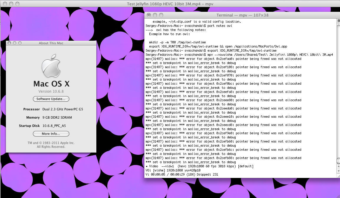

Did you see mpv playing video in Wayland btw?
All updates are in, then `mpv --vo=wlshm` should work (check `port notes owl` for how to run wayland ports).
P. S. Install `mpv-devel +wayland` for this.

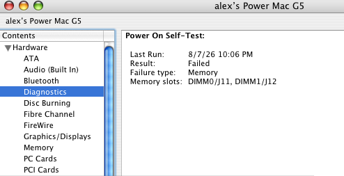

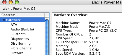

I may be 21 years late, but I am now experiencing the G5 for the first time. Or should I say, two G5s. For reference, I have had G4 and G3s over the years but never a G5. Or a dual CPU powerpc system for that matter.
You know at this point, if I bought a used mac of this era and it didn't have someones personal info still on it with auto login on I'd be surprised. Nuked that immediately, installed tiger via the same USB I used on my mac mini G4: https://forums.macrumors.com/thread...revision-g4-mini-users-please-report.2485054/. The only command that has ever worked for me is boot ud:,\\:tbxi . Any and all variations result in the prohibit sign in my experience.
Somehow I lucked out and have an optical drive (yes I wanted one for burning discs, my Mac Pro 1,1's optical got replaced by HDDs). Then looking around I saw this...
Damn... I was trying to avoid this issue by ordering a complete, working system. Then I looked at the memory:

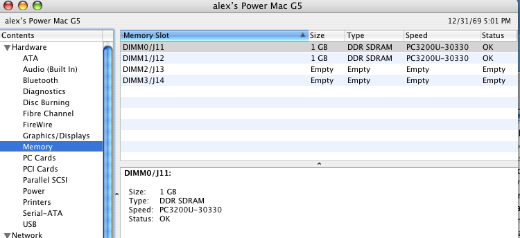

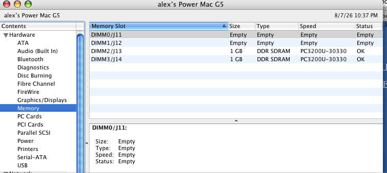

Fingers crossed, I swapped the RAM around (wow they were hard to get out):
OK i can work with that. 2 bad sticks can be replaced. And 2GBs on Tiger is like 32GBs today anyways... I thought 2GBs in this was weird, so makes sense.

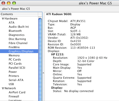

GPU:
Still pretty happy.

You gotta be kidding me. The RAM isn't even bad (probably). There are two 256MB sticks, and two 1GB sticks. 2GBs is showing, and performance was absolutely crawling because they didn't do matching pairs
I recommend you download a service manual for your model. The ram DIMMs must be installed in pairs and in particular order for them to work properly. Also RAM specs are quite strict.
BTW. what G5 is this and how many RAM slots in your machine?
Booted up my G4 Powerbook 15" and upgraded the browser with PowerFox, which albeit needs some tweaking, but already seems to be working better than Tenfourfox which was getting a little old in the tooth.
So this is a dual 2ghz early 2005 with 4 slots: https://everymac.com/systems/apple/powermac_g5/specs/powermac_g5_2.0_dp_pci.html
So what I actually belive happened is the original owner bought it, put in 2 1GB RAM sticks (in pair) so that it was at one point at 2.5GBs. The 2 256MB RAM sticks that are showing as bad are most likely the original RAM sticks. Apparently as long as it’s a pair (2x256MB and 2x1GB) this should work, but the 256MB RAM sticks do not show up and fail system diagnostics so I thew them out after verifying the ram slots themselves are not bad by swapping around the RAM. I have 2 1GB sticks coming to get this to 4GBs.
