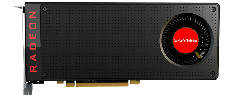

I use a sapphire one (think its 4gb though) - I've heard x after 480 is a bad thing?
Anyway, the one is this video is great for fcpx
http://www.unboxfresh.com/computing...md-r9-380-nitro-graphics-card-macpro-2010-51/
Fast renders / exports, everything is very smooth and the card is very quite compared to the flashed 7950 that I briefly used from MCV
Using it in a 2010.
I had to take the baseplate off - it just won't fit but this was v easy - a few Philipps sized screws

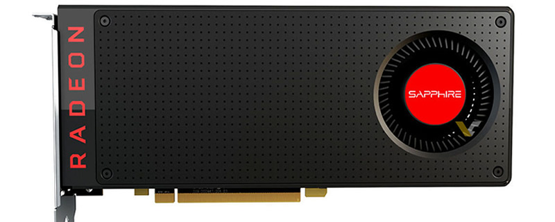

I went with reference cooler RX 480 8GB. Dual setup has been running in my 5,1 since mid July. With 10.12.1 drivers, it's been very reliable.
Thanks for the info! What do you mean by "reference cooler"?
EDIT: I'm also following your thread about the RX 480. Thanks for all the great work and the guides! Much appreciated! 🙂

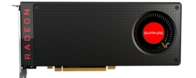

Reference = the way manufacturers intend their cards to be. For the RX 480, it's 1266MHz and 2000MHz memory speed with a cooler that looks like this.

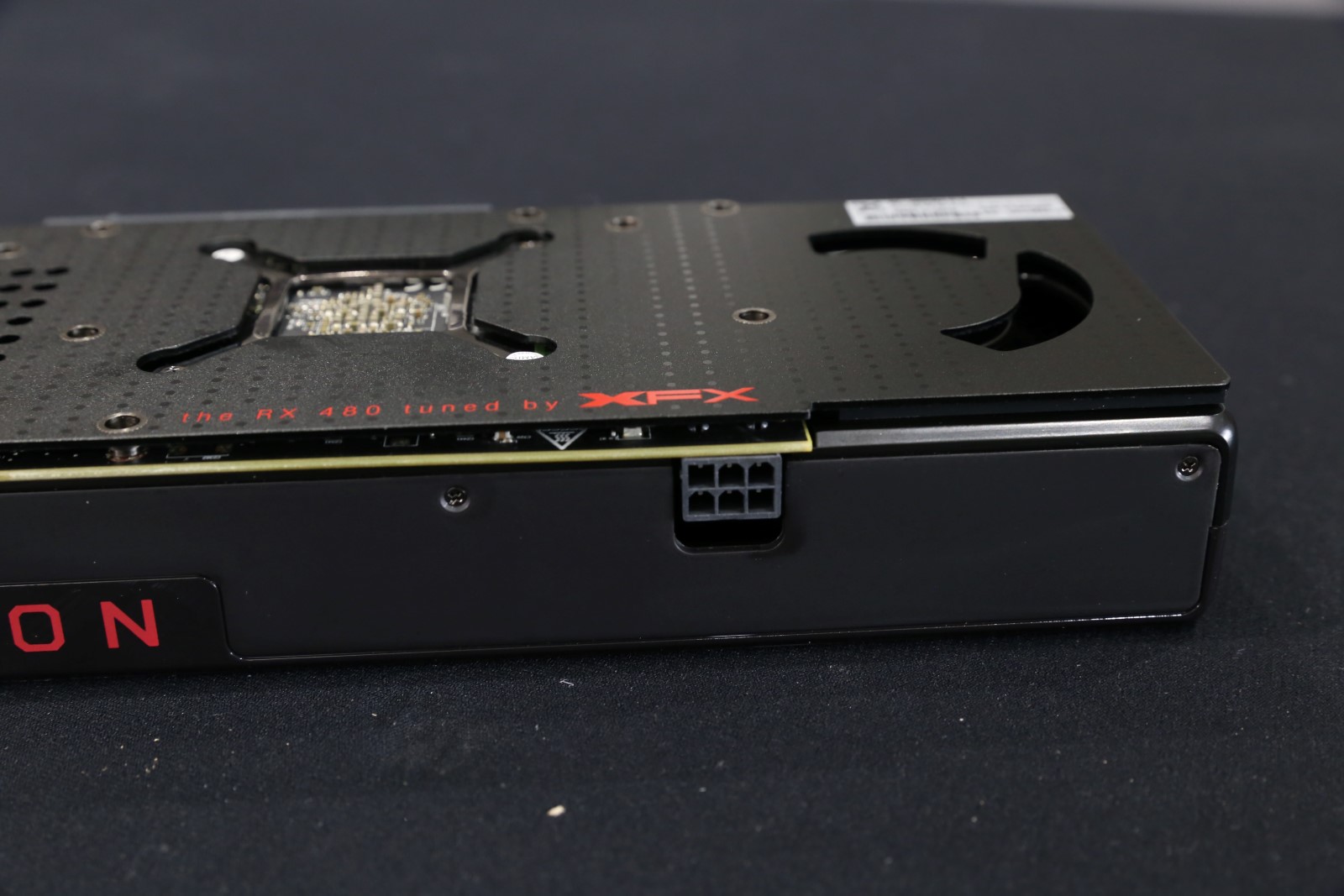

Just a heads up I have 2 of these and under windows they will pull too much power for a single pcie power cable. If you use under windows and or your planning on using just 1 card do yourself a solid and run 2x6 pin to 1 8 pin to ensure you don't have any weird shutdowns...
Thanks! I am planning on running just 1 card for the time being. But the 2x6 pin to 1 8 pin sounds like a good idea.
I don't think the 8 pin connecter would fit in the card.
Is there a work-around for getting 2 mini 6 pin connectors to fit?

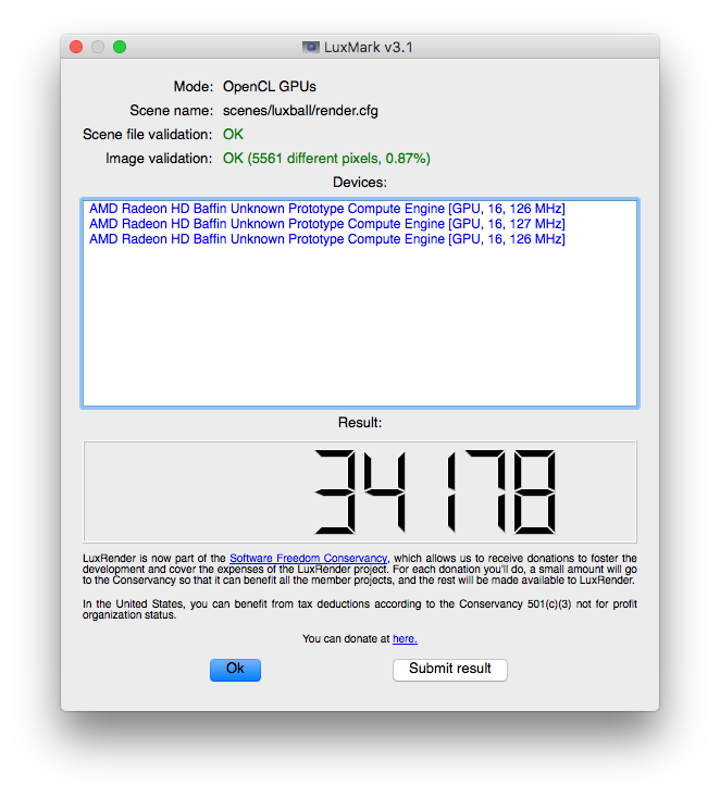

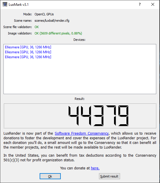

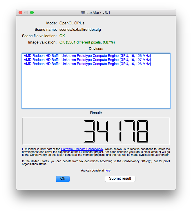

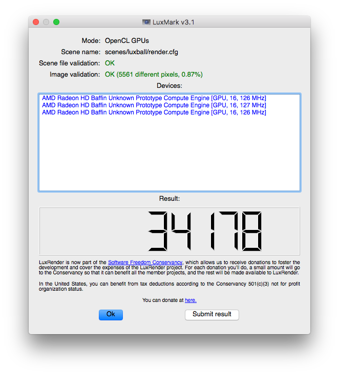

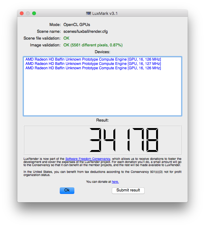

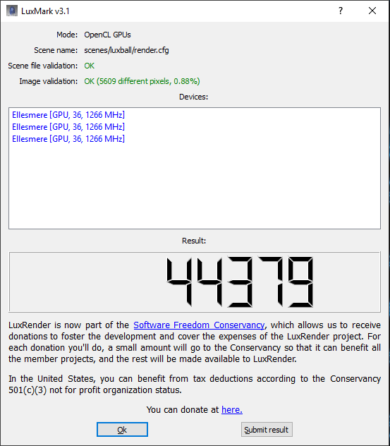

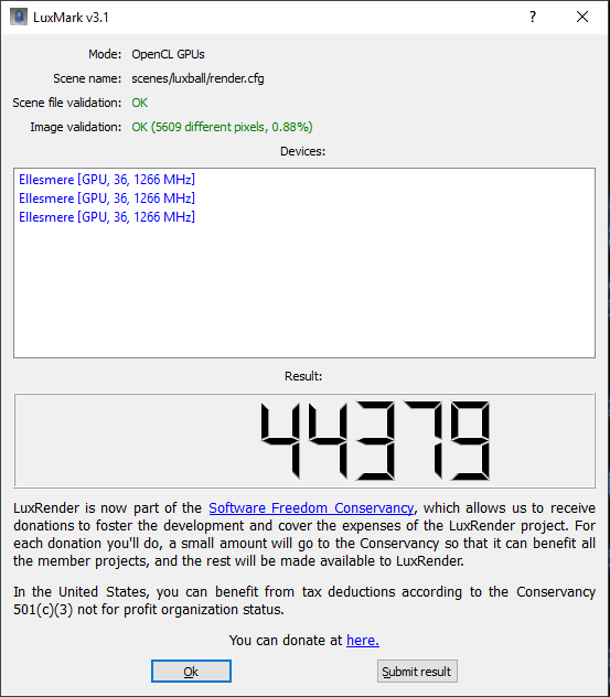

Damn, hope someone can find a way to get the additional CUs enabled or Apple decides to allow a toggle for the CUs for power/performance.
If Apple did it, it'd probably be for Metal performance anyway, not OpenCL?
