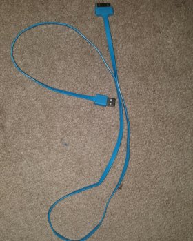

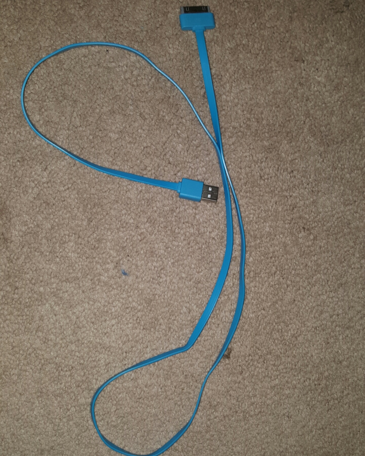

Thank you so much for your response and input! Appreciate it greatly! The charger is not an offical apple cable... it is a $6 charger i got at walgreens a while back... although i do use the offical apple usb wall adapter.. which was very hot when i pulled it out)...the cable is not charred or kinked, it is also not exposing any wires or anything... the cord is plastic... i have had about 3-4 other occourences ( the phone was no where near the room) that the smell has seeped out of that specific outlet.. from plugging in other things on other outlets in the same room..i never had this smell problem until i plugged in the iphone though.... ever since that even when i switch on my ceiling fan for a little while i get the exact same smell.. the outlet does not look burnt or anything... although i did used to plug my hair dryer/straightner into that outlet alot for a prolonged time a while back... and i did have the cover to that specific outlet pull off many times when i used to yank out the plug to my hair straightner.....
Do you think the phone itself is safe to turn back on and does not have any problems? Or could this situation have fried the battery or something?
[doublepost=1515553043][/doublepost]This is a picture of the

This is a picture of the cord that was being used...
I think your phone is fine. I think the problem is the plug. A hair dryer can pull 1800 watts and a curler can pull another 200... its possible your wiring was never intended for that sort of current. using a cheap charger doesn't help and i would dump it and only use official apple chargers and cables.
that said i think that plug is a hazard snd you shouldn't put anything in there until you can have it looked at.

Thank you so much for your response!! It is greatly appreciated... the cord itself is a plastic cord and i was using the offical apple usb wall adapter.. the adapter was very hot when i pulled it out though.. is it possible this whole problem/smell could have been created from the charger cord itself? I have never had any problems with any other chargers in my room or house... ever since the iphone incident i have had 3-4 other occourences that the smell actually seeps out of that outlet when i plug in other things in other outlets in the same room.. (phone is nowhere near the room).... do you think the iphone itself is okay and has not been somehow damaged? Or caused any problem with battery? (I turned it off and have not turned on since) i attached a picture of the cord i was using...
the phone is probably ok.... the cord also looks ok...
there is a chance the adapter damaged the outlet or the outlet damaged the adapter... but something is wrong with the outlet now... please be careful
Thank you again! I will definetley dispose of that cable.. and invest in an offical apple charger cord and charge the phone out of my room until i find out more behind this problem.... i really do hope the phone is fine... it has very important information which i do not have extra copies of.. could the smell somehow have traveled up the cable and unto the phone? Since the phone itself has a slight (not heavy) smell of it?...
