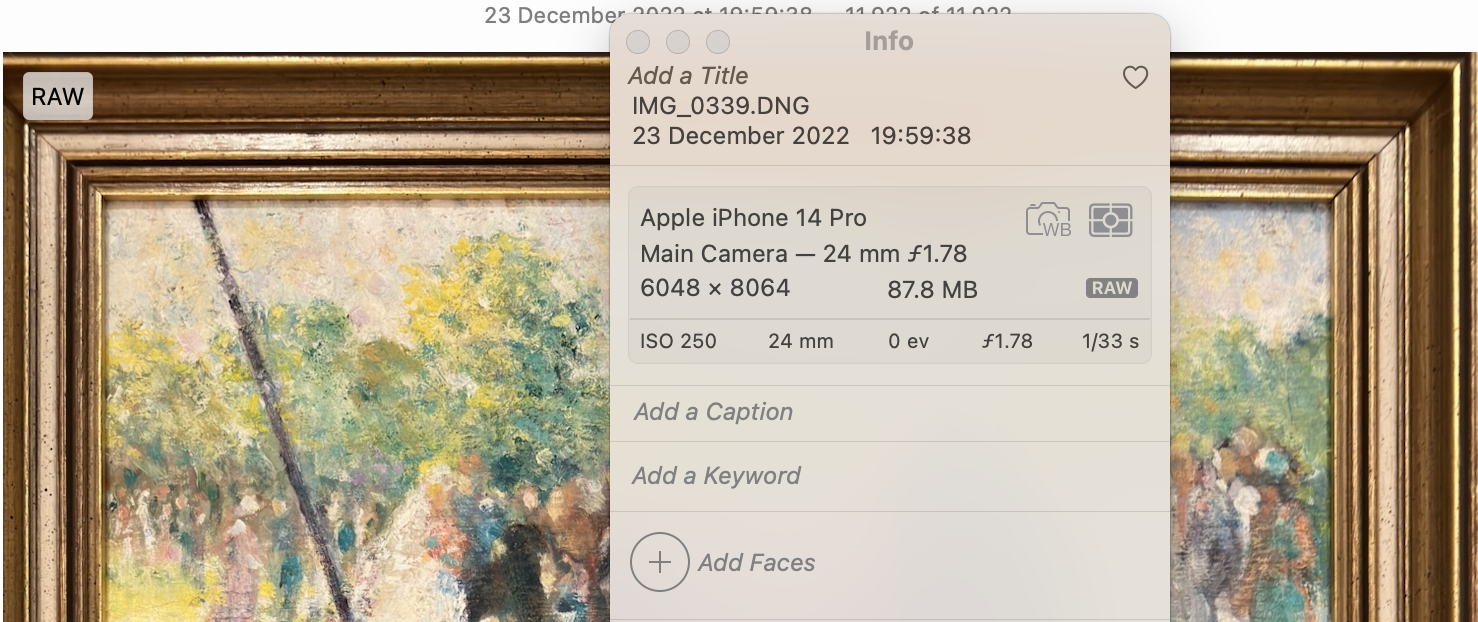

I've made a test photo or two which have come out well, but it appears that they are too big to show them to you here.
8064 × 6048 76.4 MB The quality (to me) is outstanding. When magnified on my 27in iMac screen, the detail is just amazing.
