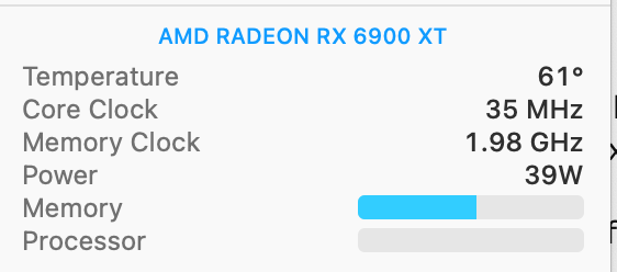

Do you use programs like iStat Menu? Tell me, does it reflect the statistics of the rx6900xt GPU, video memory, and also the temperature?
Yes, that is what is reported once the Mac OS is fully booted up and running.
I do have iStat Menus as well as iStatistica Pro. Both are reporting the GPU stats.

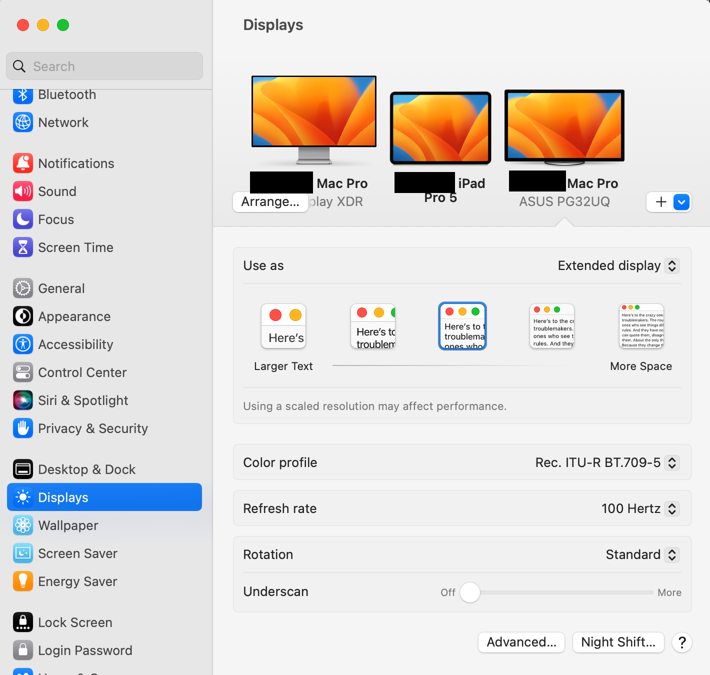

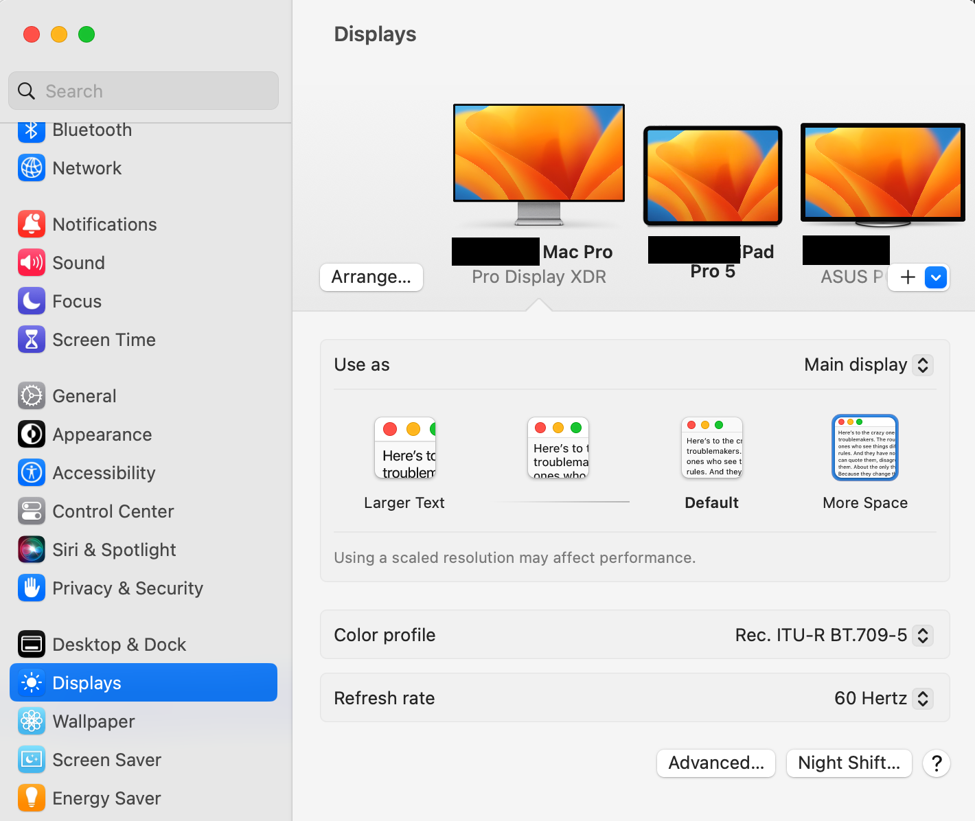

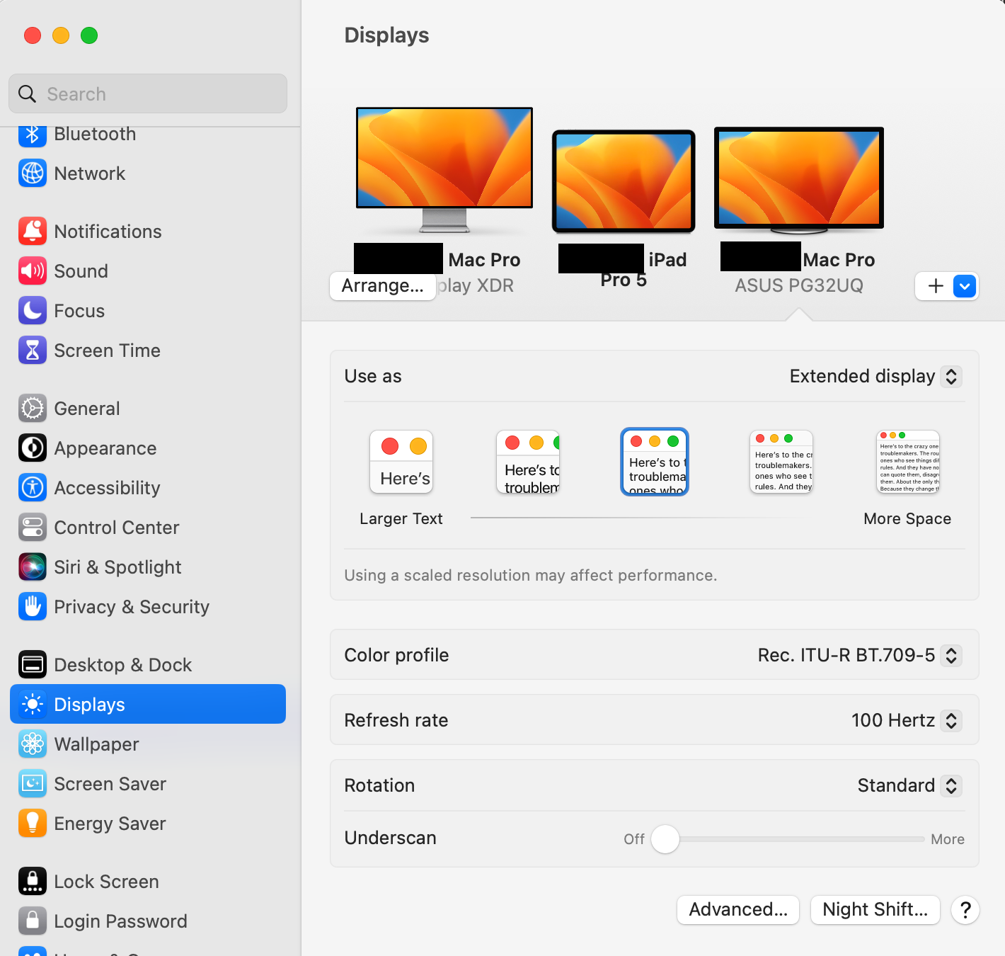

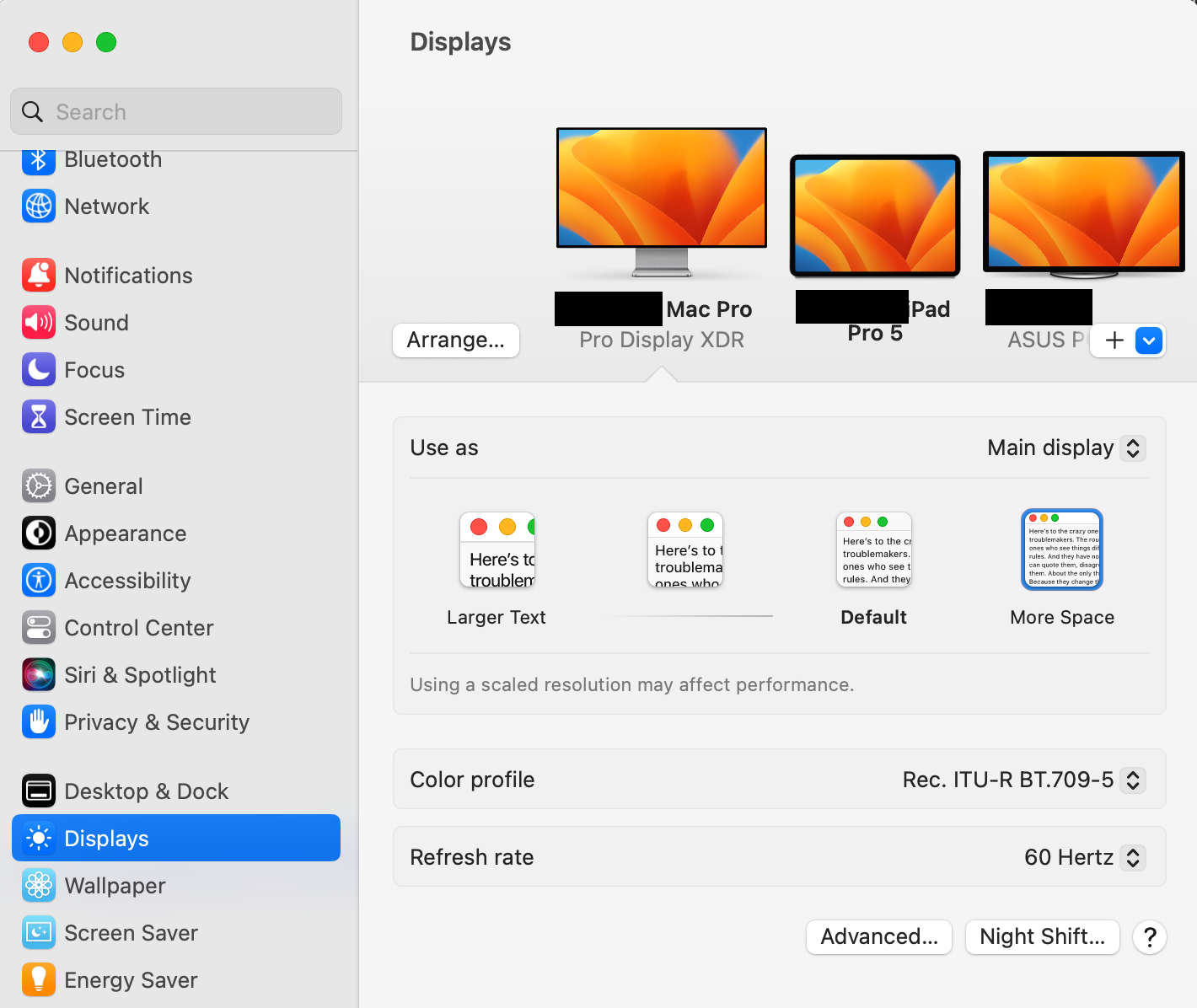

My question was specifically about macOS limitations on the Mac Pro 7.1, inspired by the original post in this thread. As you can see from the OP's screenshots, the same monitor runs at 144Hz in Windows but is capped at 100Hz in macOS — despite using the same hardware.
This mirrors my own experience:
I’m currently using the Radeon Pro 580X MPX in my Mac Pro. Technically, it supports DisplayPort 1.4 (capable of 4K@144Hz via DSC), yet macOS only offers me 60Hz max on my 4K monitors (both HDMI 2.0 and DP).
So while the RX 6900 XT undoubtedly can push 120Hz+/4K on Windows (as the OP’s screenshots prove), my concern is whether macOS will actually unlock those refresh rates on a Mac Pro 7.1. If the OS is imposing a 100Hz cap (as seen in the OP’s case), upgrading the GPU might not help.
