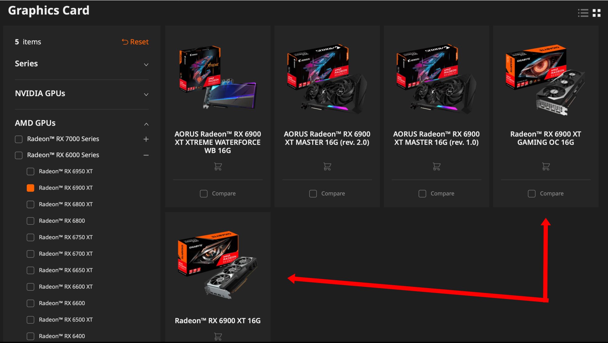

Sorry to exhume this thread, but I have a 2019 Mac Pro with a W6800X Duo MPX module. Did anyone find an RX6900XT card that only takes up the remaining two PCIe slots? It'd be a cheaper expansion than adding another Duo.

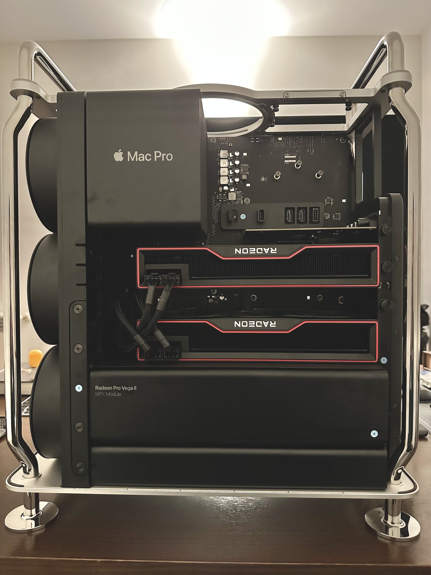

These two fit:
Lou
Bottom left is a reference 6900xt card under the gigabyte name, top right which i have is the gigabyte gaming 6900xt card. The difference is the Ref card has 2 X 8 pin, the gaming card has 3 x 8 pin but both fit in the 7.1 mac pro.
Very happy with my gaming 6900xt card.
I've got the Sapphire NITRO+ RX 6900XT, just make sure not to mix it up with the SE (second edition) which has a much larger chassis and won't fit (thank goodness my supplier had a decent returns policy!)
OEM AMD 6900XT works great on mine.
I removed the 580X MPX module and put this in there instead. No issues.

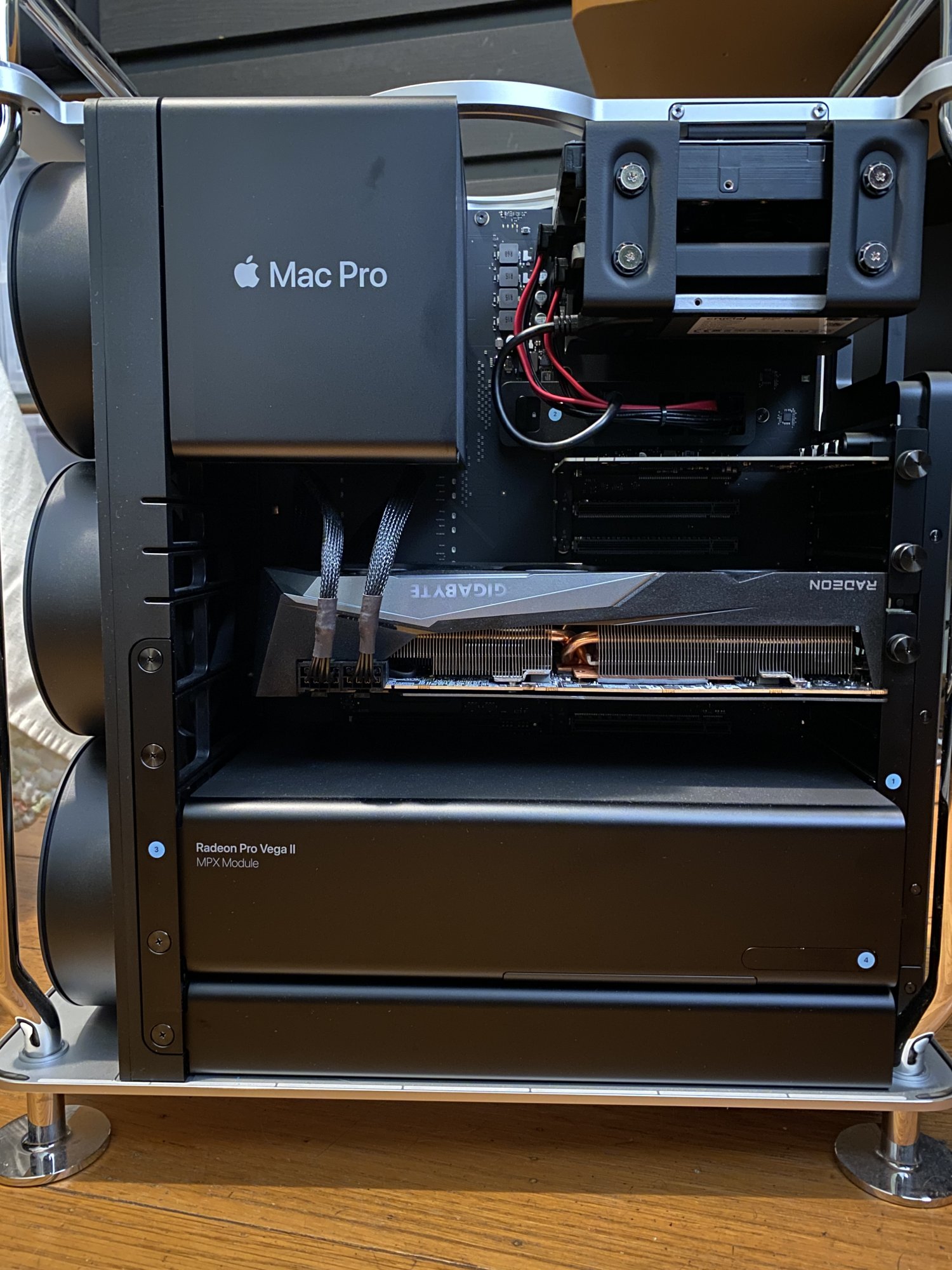

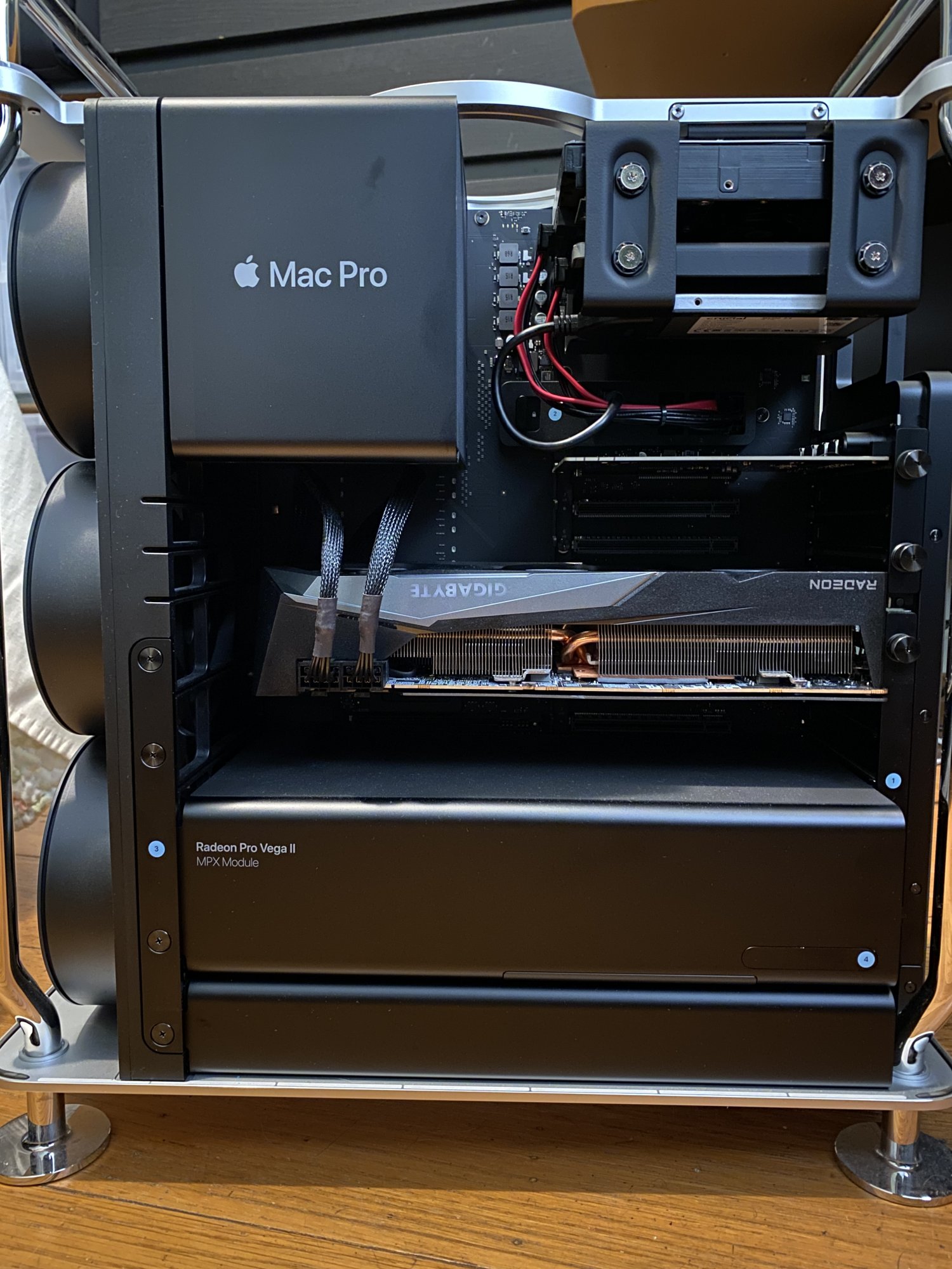

Does anyone here have the Gigabyte 6900 XT card that fits? Wondering what the fan noise is like, since that seems to be one of the few remaining options available to get it (though used usually)?
Otherwise, while I hate to entertain the thought, has anyone ever cut/removed one of the plastic rails to get a longer card to fit in?
^^^^I have the Gigabyte RX6800XT which has the same form factor and coolers. I also have the bios switch set to performance mode. It's pretty quiet for me👍🏻
Lou
I have the Gigabyte RX 6900 XT OC. No noticeable fan noise. I do Creative Cloud apps from Premiere Pro, After Effects, Audition, Illustrator, etc. Of course this will most likely depend in your environment temps. The Mac Pro itself has adequate cooling as you already can see with it's 3 massive fans pushing to the internals. But I can only guess if your environment temp is warm, then all it's doing is pushing the warm air to an already warm environment and that may trigger higher fan speed and therefore, noise.

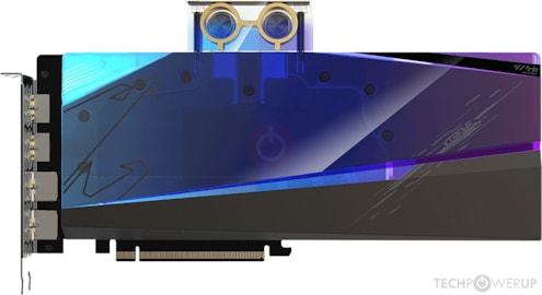

Was there ever a 2slot wide 6900xt? I think there was one 6800 pull from a dell or something that was only 2slot wide but don’t think there was ever a 6900 that was only to slots wide?
The liquid cooled models are (less than) 2 slots wide, but the cooler winds up elsewhere. I don't have a 7,1 to figure out where a radiator could go.

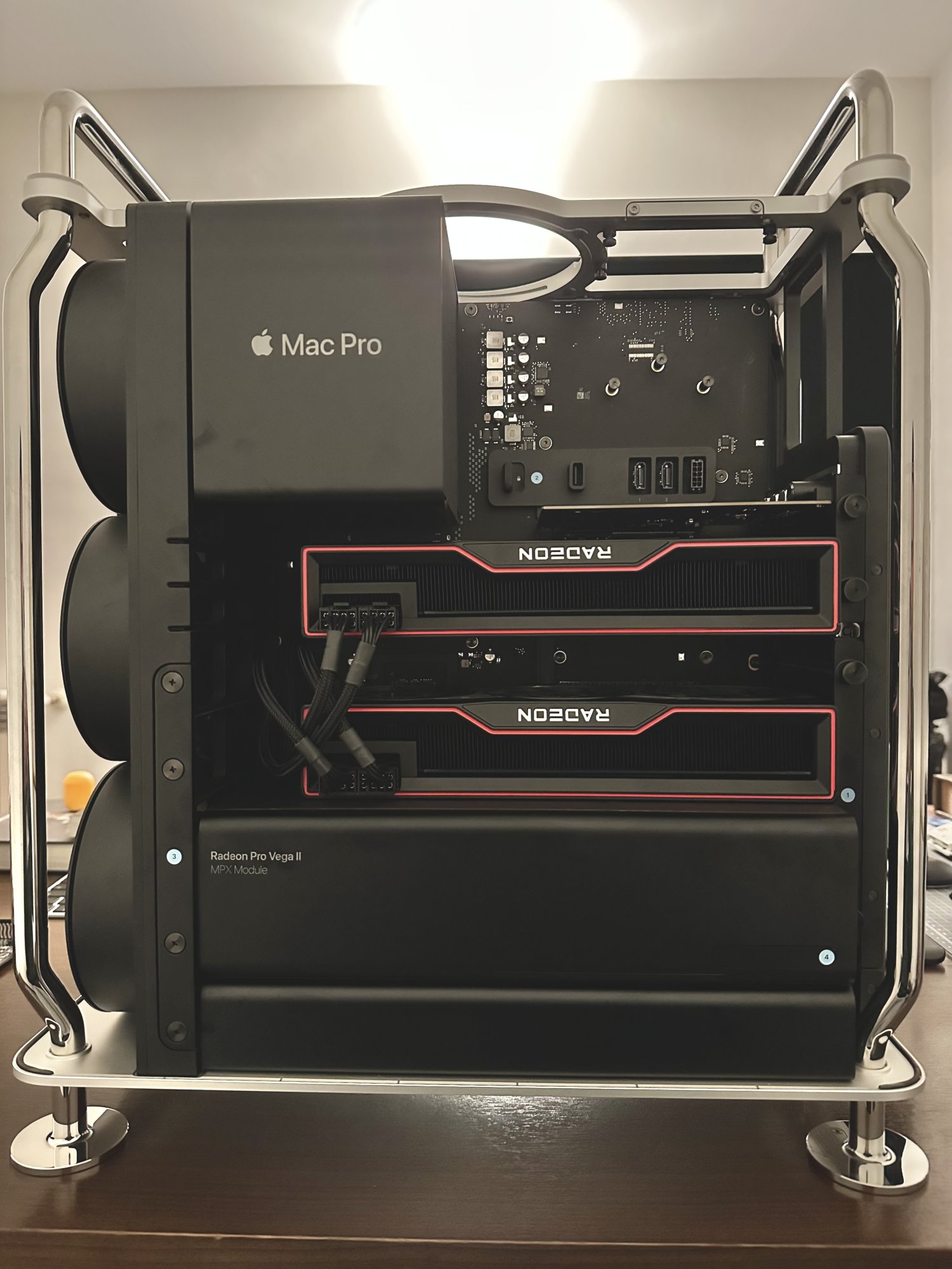

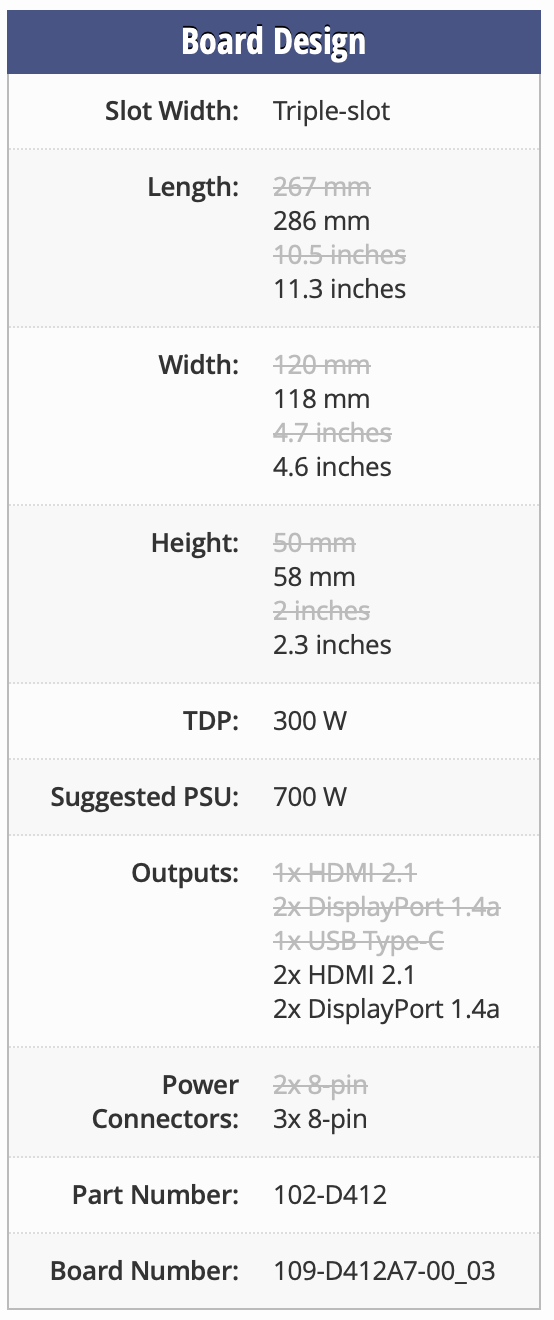

I really regret not knowing about the 3x 8 pin on mine. I was able to make it work alongside a W5700X, but a) there's a glitch with the 5000 series on the 3D software I use, which makes it basically unusable and b) I can't fit any more 3rd party GPU's in as I'm using 3 out of the 4 power cables… 😬
Well this is an issue with 3 x 8 pin, but i use a 4090 with external PSU, just pass cable through PCi slot at back, its a flat cable so passes through easy, no reason you cant power a 2nd 3 pin gigabyte card this way. the psu for my 4090 sits under the back of my desk, and i have a PSU switch connected to PSU to power it when needed. a small corsair SF-750w does the trick nicely and is silent. also fitted with the flat 4090 cable from corsair to power the 4090.
There are ways around it, 2 reference 6900xt cards with dual 8 pin would have been ideal for you, or expensive w6800X card to replace W5700X card. 6900xt plus PSU is much cheaper and faster.

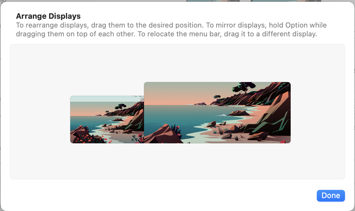

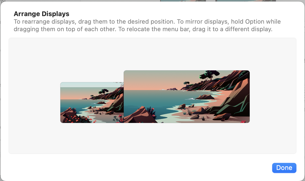

When you connect the main display to that video card, then the Mac OS will make that your default card. I don't think there's a way to connect all your displays to the 580X and then assign the other GPU as the "main" processing card outside of the actual application that can make a selection directly. I could be wrong.
What I do is connect my multiple displays to the two video cards. That means you will have to invest in a USB-C to DisplayPort adapter, which I've done. Once you've done that, to switch to the "main" video card, you simply re-arrange the menu bar under the Arrange Displays setting. You can verify which "main" video card is being used when you click on "About This Mac."
I'm at the office right now and using my laptop, so the screenshot I attached will be slightly different but the same idea.

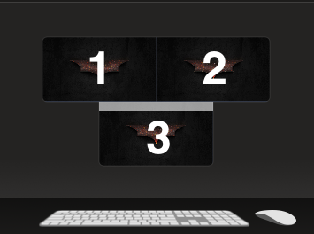

Oh, this is very helpful!
That is, if monitors 1 and 2 are connected to the ports of the rear I/O Card ports thunderbolt (mpx module 580x will be the controller of these ports), and monitor 3 is connected by hdmi to the rx6900xt card, and is assigned as the main one in the system settings, then the main video card will be rx6900xt?
Do you use programs like iStat Menu? Tell me, does it reflect the statistics of the rx6900xt GPU, video memory, and also the temperature?
