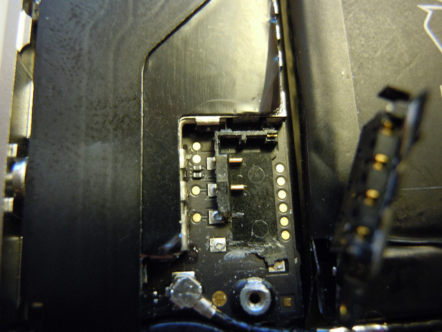

Here's the catch with that battery connector: The pins are nearly impossible to reach with a normal soldering iron. Well, without clipping a capacitor, or melting something. If I were you, I'd remove the connector, desolder the ribbon from the battery PCB, and just use thin wires to connect the battery to the board.
** If you do mess up the pads while soldering, you can jumper the wires to small components located underneath the lower EMI shield. There's schematics available, hint: search on google "site:wenku.baidu.com iPhone N90 murata" its the first 2 links.

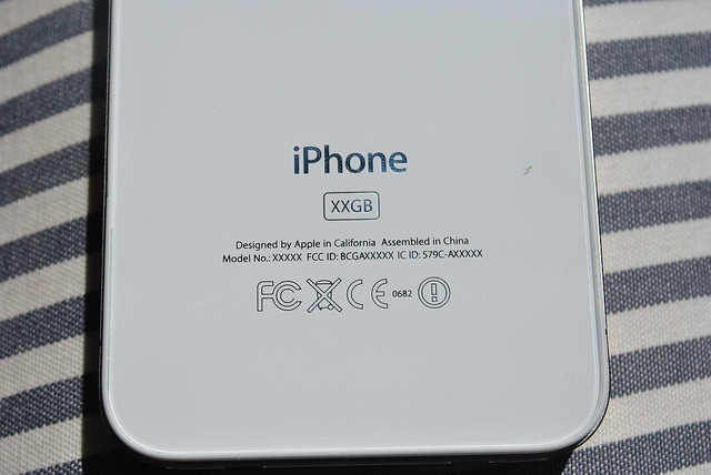

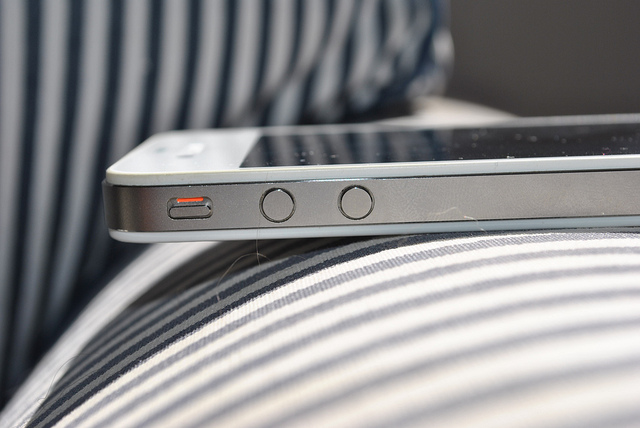

Alright Guys, I'm back. My Camera is charging but in the meantime some initial impressions.
-Glass quality is on par with new iPhone 4's
- Rear lettering is crisp and real
- Front "DF3184" lettering is mostly crisp, except for a few minor extensions on the "D" and the "8".
- Home button is real
- The phone shows no signs of having the front glass removed... all of the side screws have not seem to have been removed.
-This is possibly the most interesting one, the "connect to iTunes" logo is pixelated, and seems like it's on the old resolution, and so is the Apple boot logo. What should I do? Should I restore over this firmware or try to use it?

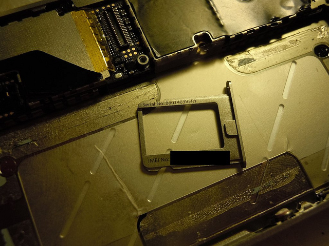

Since this is strictly a prototype phone, here is the Serial number as found on the SIM tray.
8801403VFRY
Comes up as unknown on Apple's site. Anyone care to decode this for me? I'm too lazy...

Here's the battery connector damage, does someone want to suggest to me how I can fix this? Video coming soooooon.
[url=http://farm7.static.flickr.com/6200/6069619831_9fac6ffcfd_z.jpg]Image[/url]
Battery Connector damage detail by Mathias Rios, on Flickr
I am wondering if a small nib of copper wire might suffice, just make sure you file it so it fits properly into the slot. That, or buy a broken logic board and use a soldering iron to remove one of the connector posts that your missing, and re-solder it!😉
Yeah this was one of my ideas.... I'm afraid to touch the board.

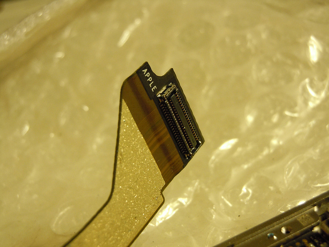

The last few moments with this device have been some of the most exhilarating experiences I've ever had with taking apart any iPhone. I found incredible stuff on the inside, including 2009 (!!!) trade mark dates on the digitizer connectors, and a DVT_100 (or something like that) sticker on the inside of the EMI shield on top of the CPU. I took photos of all of it so they will be up in a few minutes (will edit this post)

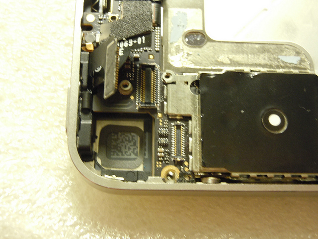

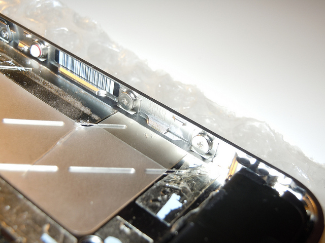

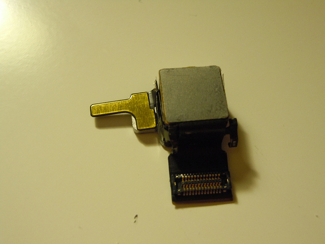

Sorry about that guys... I fell asleep, long day of traveling. But here they are! 🙂
The link to see ALL the photos is here: http://www.flickr.com/photos/mars478/sets/72157627368941519/
But I will post the more interesting ones here for the lazy people :roll eyes:

2009 Trade mark dates on the Digitzer by Mathias Rios, on Flickr

Small damage to one of the mount points on the motherboard (No, I didn't do this)

...and for those wondering, yes I did put it back together, exactly as it was. I repair iPhones as a job, so I know what I'm doing 😛 I hope you guys enjoy the photos. I'm open to entertain offers for the device, and if you do offer understand everything that has been posted, and what you are getting. But if I don't get any offers good enough I will be keeping this sucker 🙂 haha
