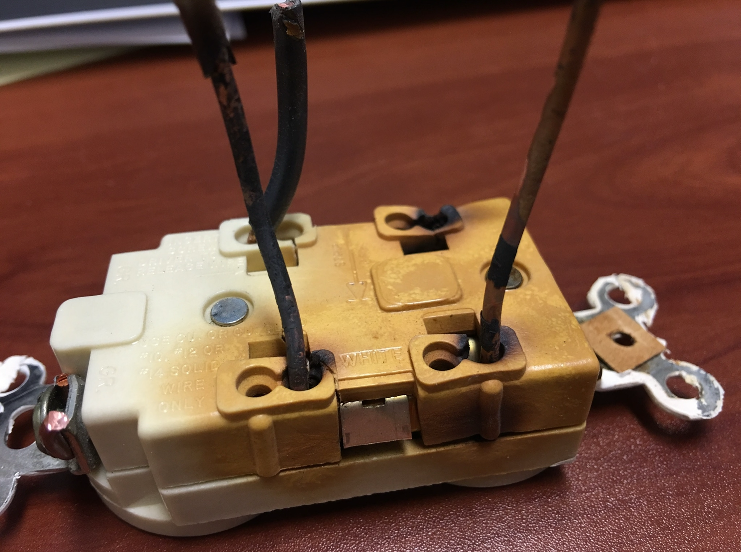

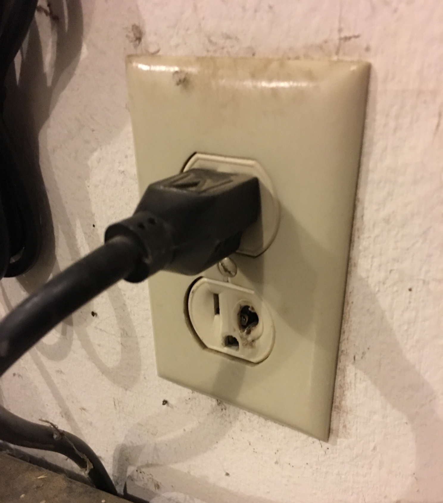

So we used to work in an old commercial building in the middle of nowhere and noticed several of our outlets were doing this (below). Upon removing the outlet box we found more evidence of burnt everything. It was clear that whoever had wired the place in the past (it was an old building) had not done it well.
I have a picture of the burnt outlet box somewhere but haven’t been able to find it, will post when I can. Lol
What was interesting was, several other outlets in the building did this within the same month and all had to be replaced / re-wired.
And yes, 100% agreed about those old 220v dryer outlets :p. I set my car to pull less than what it wanted to and that made everything happy.
  • Wow
Reactions: poorcody
Backstab connection.😨😱😱 I never ever use them. One of the first things I did when I bought a new house was replace every receptacle making sure to screw in the wire and tape for good measure.
If you hire an electrician and he backstabs a receptacle, fire his (_!_). No electrician worth his license would ever use these backstab connectors.
