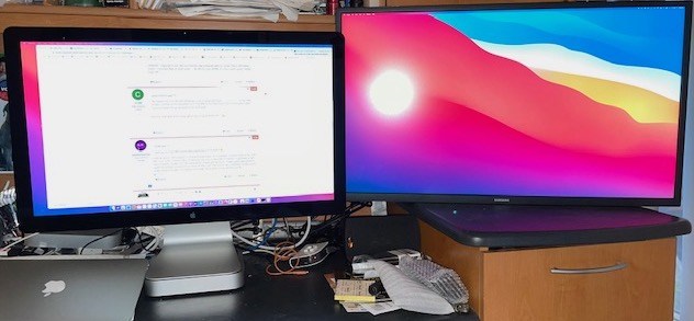

Base M1 Mini - 3 weeks and loving it!
No wireless - hardwired LAN port to router for 500Mbps ISP.
Bluetooth Apple Magic Keyboard 2 w/ Logitech mouse.
Dual displays - main: 27" Apple Thunderbolt w/ TB3-TB2 adapter; extended: 32" Samsung 4K direct via HDMI port.
