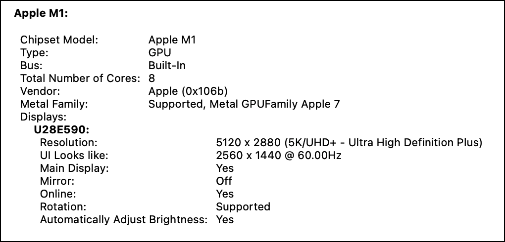

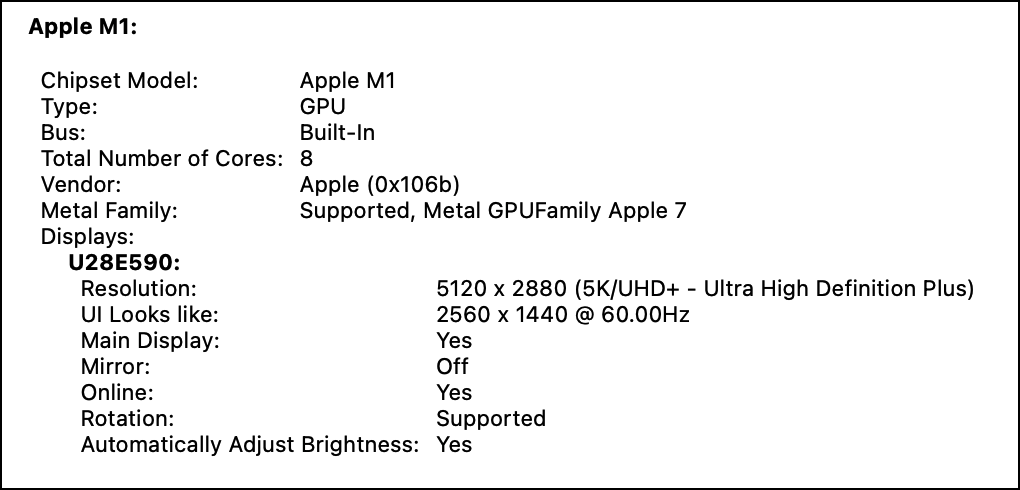

My "base" M1 Mac Mini is currently rockin' a 28" Samsung U28E590 display at 5120 x 2880 @ 60Hz via HDMI-2.1, leaving both USB-C / Thunderbolt-4 ports open for external storage. My monitor has two HDMI inputs -- one is 30Hz and the other is 60Hz (with a compatible cable). I assure you the Mac Mini has no problems driving this gorgeous 5K display smoothly at 60Hz via its HDMI output.
I’m not tech savvy, but how does a 4K monitor display 5K?
