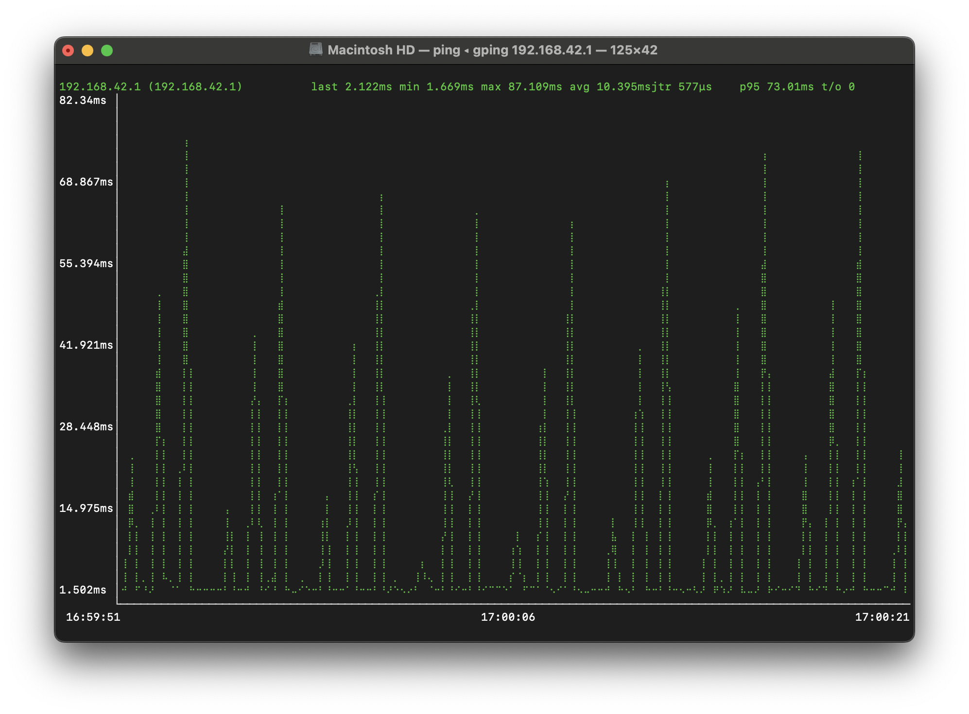

Wi-Fi Latency with AWDL Up on macOS 13.1:

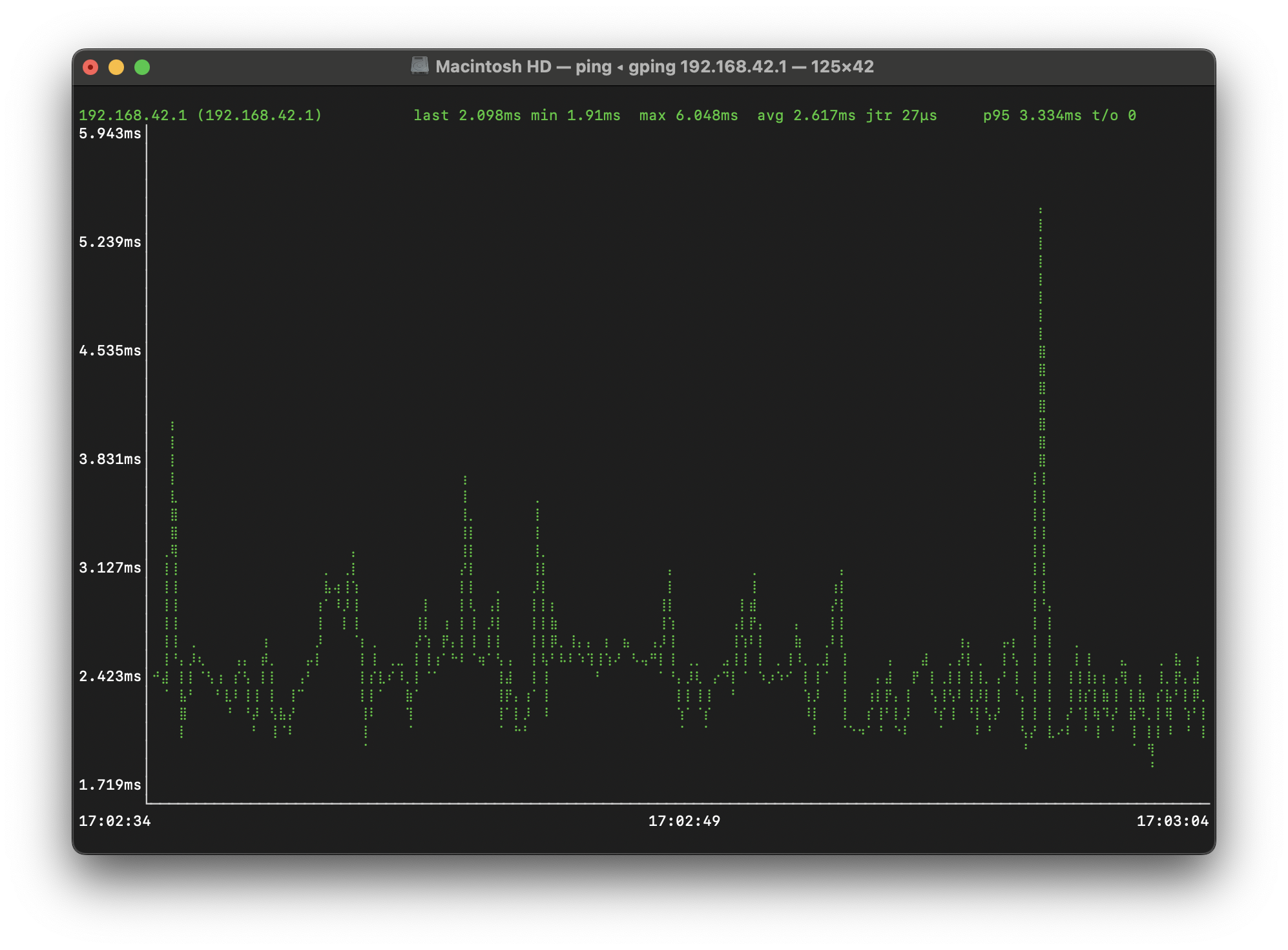

Wi-Fi Latency with AWDL Down on macOS 13.1:

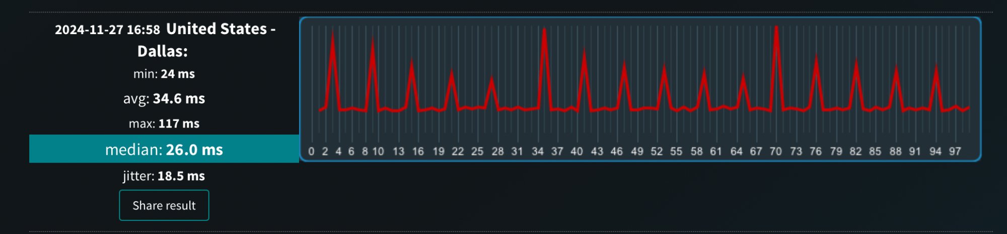

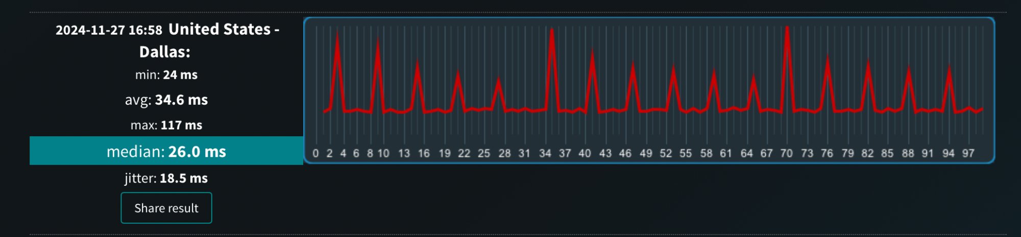

Seems like this issue is still happening with the new Mac mini m4 and affecting my iPad Pro 13” on the 18.2 DB4.
Interestingly, my iPhone on the same iOS version isn’t reproducing the repeating interval ping spikes/jitter.
