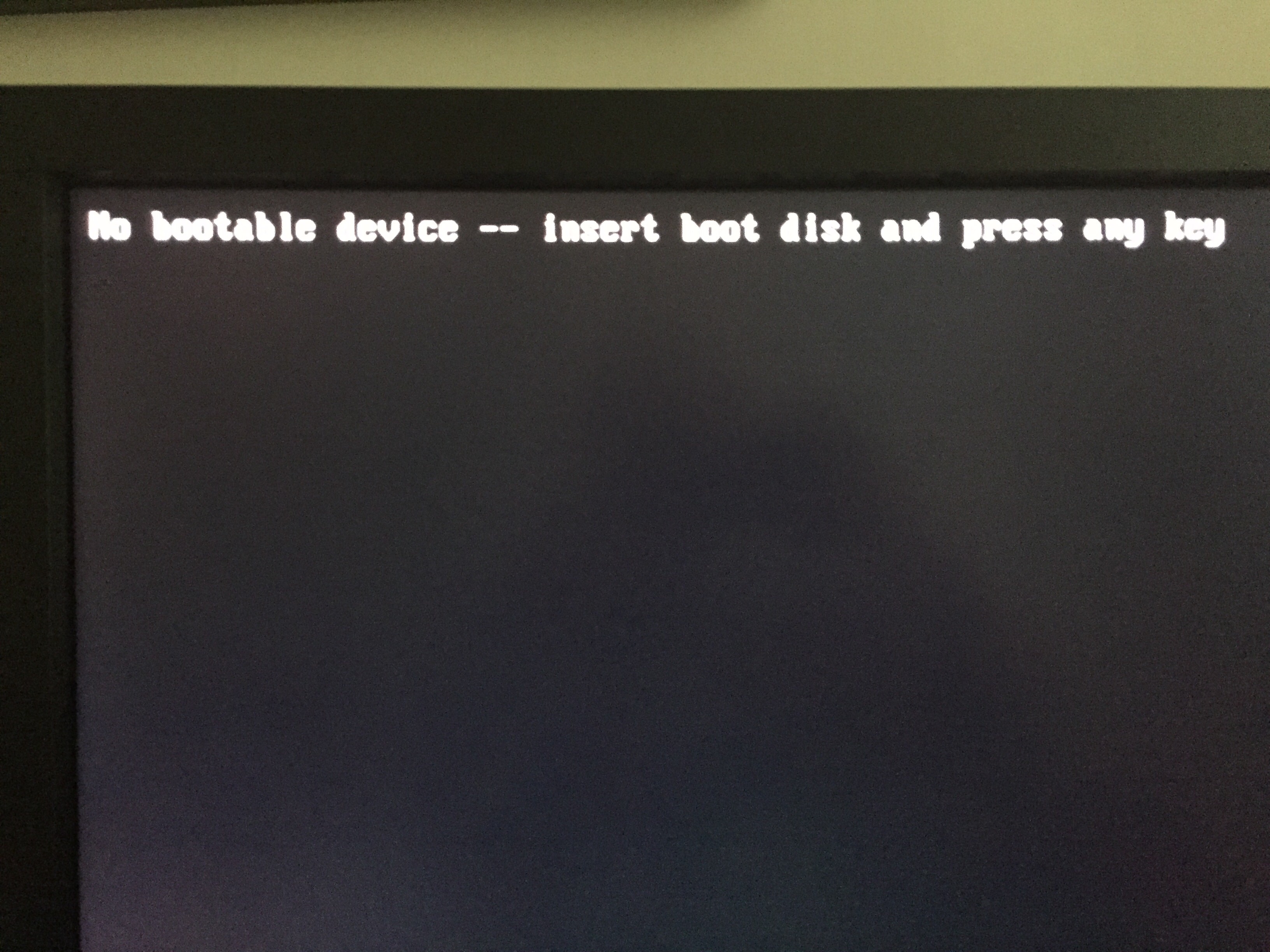

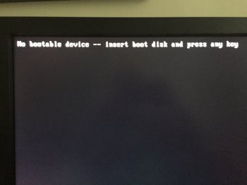

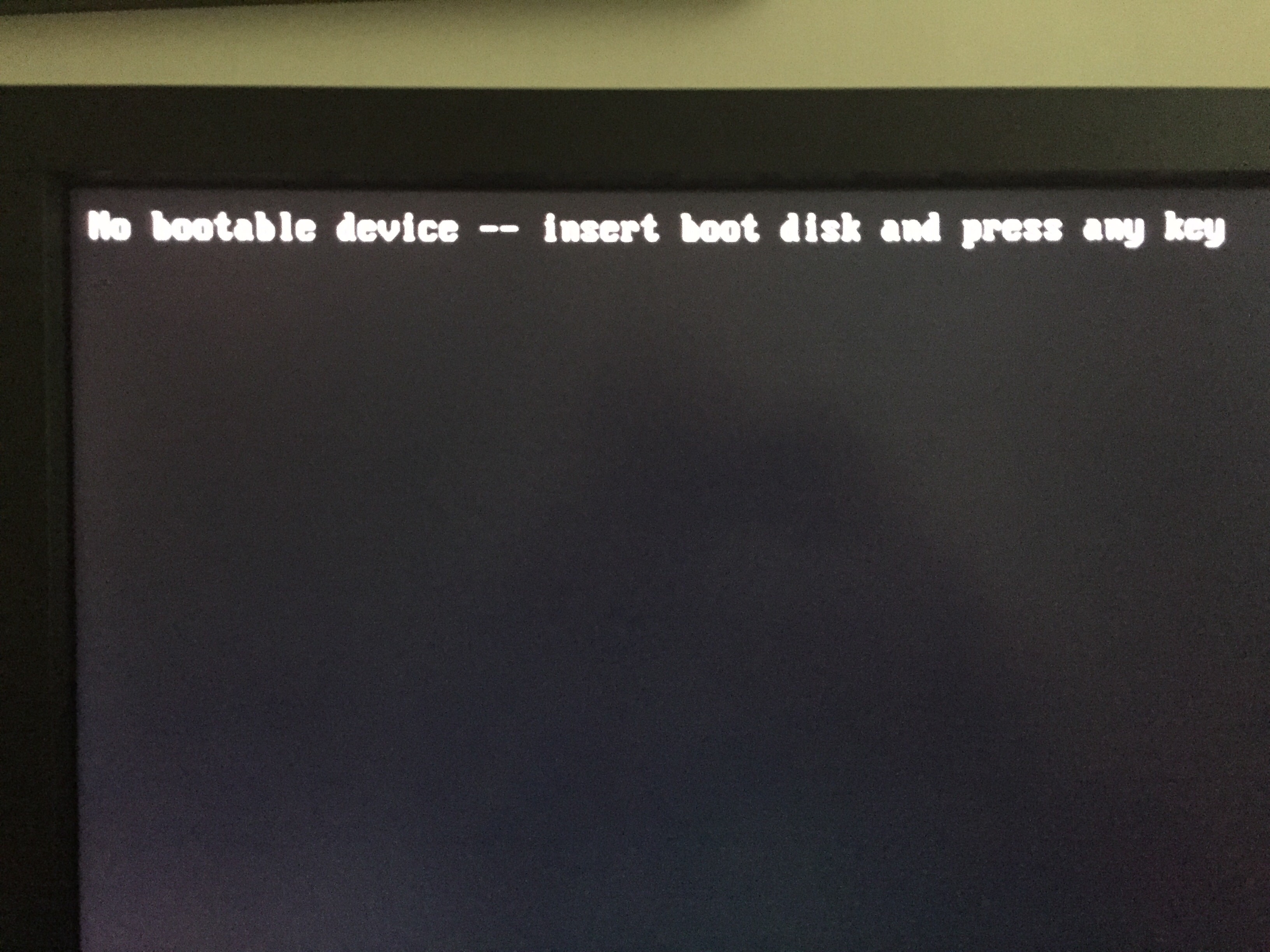

I was thinking of using the 'Make EFI bootable' option in WinClone. Does it convert a legacy Windows boot camp drive to an EFI Windows drive perfectly without any issues?
Ah well I tried the 'Make EFI bootable option' on my Windows 10 drive and now that install is dead. Let's see if I can bring it back to life with 'Make Legacy Bootable'
