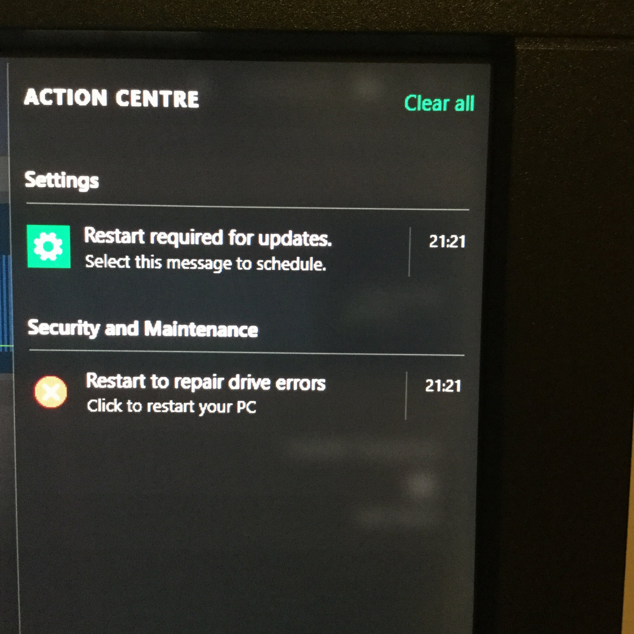

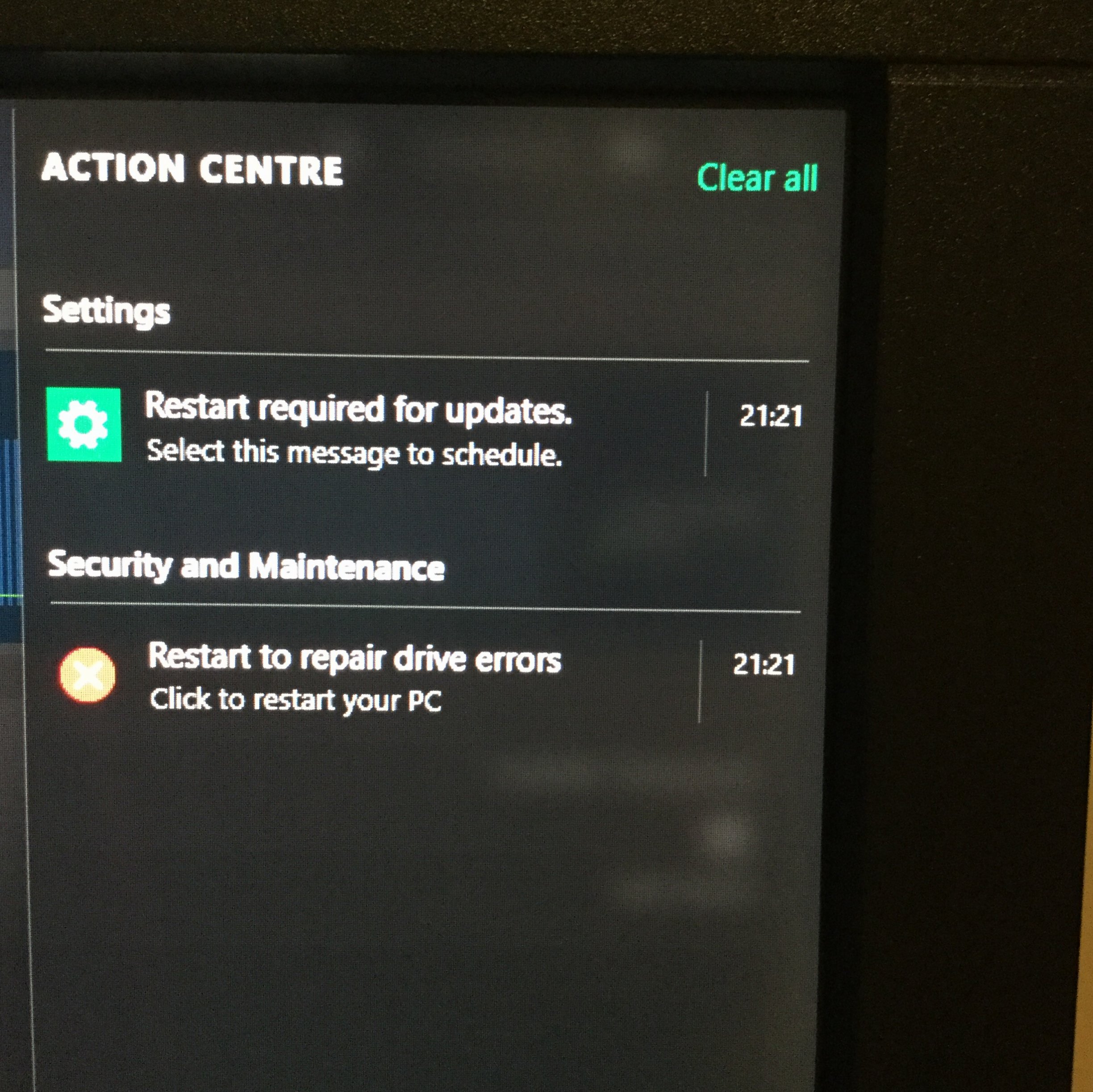

I just had another lock up trying to run software update just after booting. My Windows install is definitely damaged or buggy. The random lock ups or failed wake/boots are still occurring and I have only been giving the OS light use so far. It's very random and I can't pin it down to anything at the moment.
Edit : Windows just gave me a notification : click restart to repair drive errors. See attached.

I rebooted like it asked and it did a very quick scan and repair that lasted about 20 seconds and then booted up normally. For now it is behaving. The install is on a new 850 Evo.
