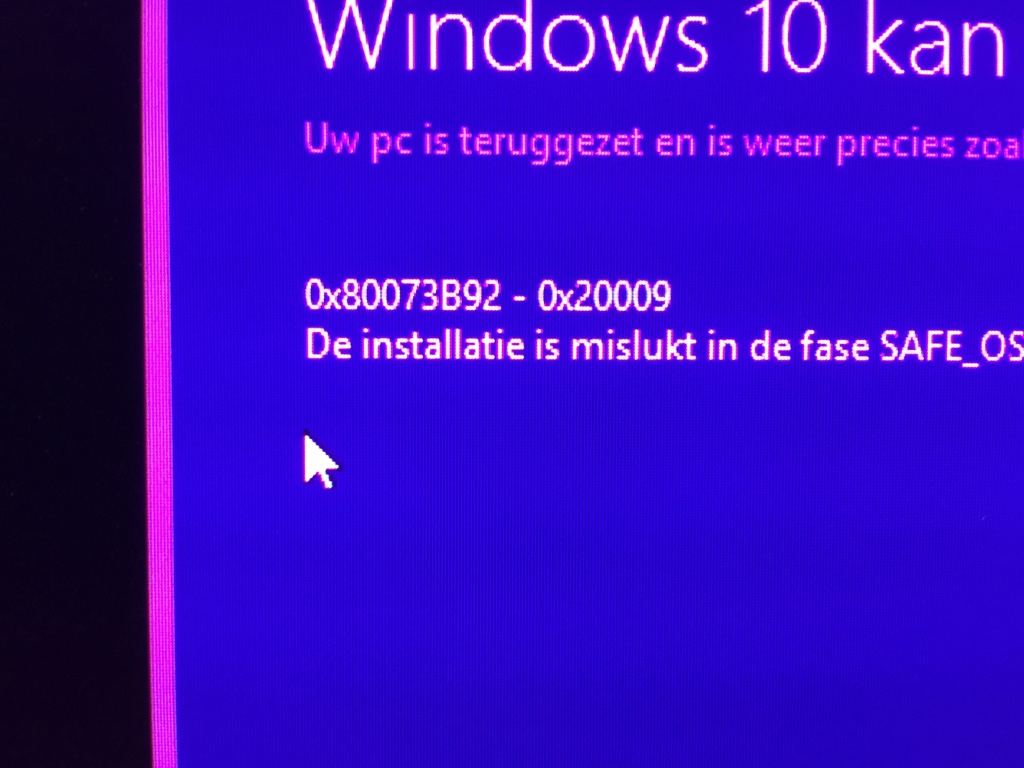

I have tried twice to update my Retina iMac external Windows 8.1 to Windows 10. I am using the .iso file released yesterday, the setup seems to run fine, downloads a bunch of updates, and starts the install. When I return, I find the following message on the screen:
0x80073892-0x20009
The installation failed in the SAFE_OS phase
with an error during PREPARE_ROLLBACK operation.
The second attempt I disconnected all external drives except the Thunderbolt SSD, the only other drive being the internal iMac 1TB SSD.
Research finds others with similar error messages, but no solution yet.

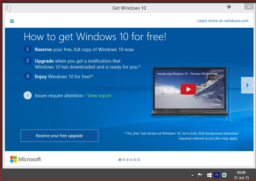

I've hit a road block with my W8.1 in bootcamp. I never got the upgrade notification despite having the two necessary updates. Then I tried the direct tool download from MS. It starts up and I choose 'upgrade this PC' and the two seconds later it says "Something happened". It doesn't give an error code.
Read about this problem online and none of the suggestions worked.
Then I tried the create install media option. I was able to make a bootable USB install media but after it starts it asks me for a W10 key. No option to upgrade without a key. Where am i going to get a W10 if I am just upgrading? 🙄
grrrrrrrrr

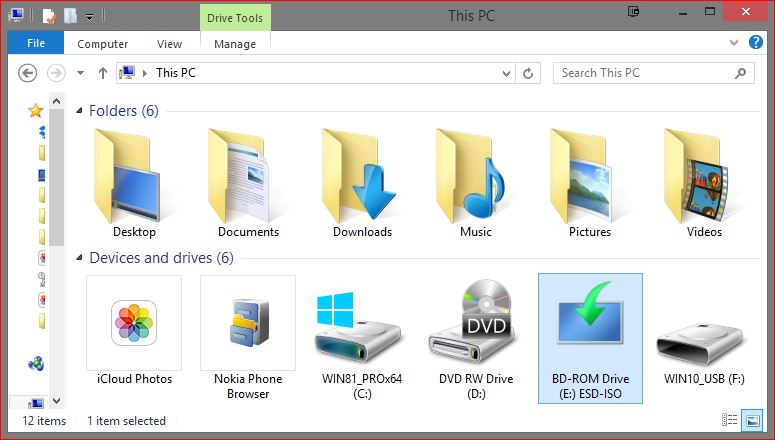

So i loaded up OSX, downloaded the w10 ISO from their site, and just mounted the ISO in w7 with my USB. Super painless once it started installing.
grrrrrrrrr
download the ISO in OSX. you will not be prompted to download the direct tool from MS, you'll just get a straight 3.8gb ISO file.
0x80073892-0x20009
this doesnt surprise me because so many people have cloned their windows into an external drive.
I suspect you'll have to bootcamp your main drive into 8.1, upgrade it to 10, clone it, and load it into an external.
0x80073892-0x20009
Made a Winclone backup first, then tried to install the upgrade to my cMP 5.1 WIN 8.1 on SSD on the DUO x2 PCI card. Windows/OS X both see that as an external drive too, so tomorrow I'll hook my SSD in bay 1 again and then see how it goes. I'll report back ASAP.
BTW: I had the exact same error code!
Cheers
Will be waiting for your report ... my cMP 5.1 with Windows 8.1 SSD on DUO x2 PCI card is the next machine to try to update.

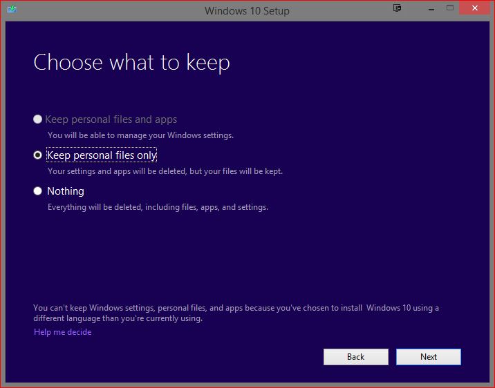

I downloaded the ISO, from the MS link provided here on MR, just to be sure and trial-and-error another "route du soleil" 😎
Why the h*ll is MS so picky in this stage? My original OEM is DUTCH, that I changed to English because I use a lot of English forums and that I need the English package for Voice Recognition in my flight sim.

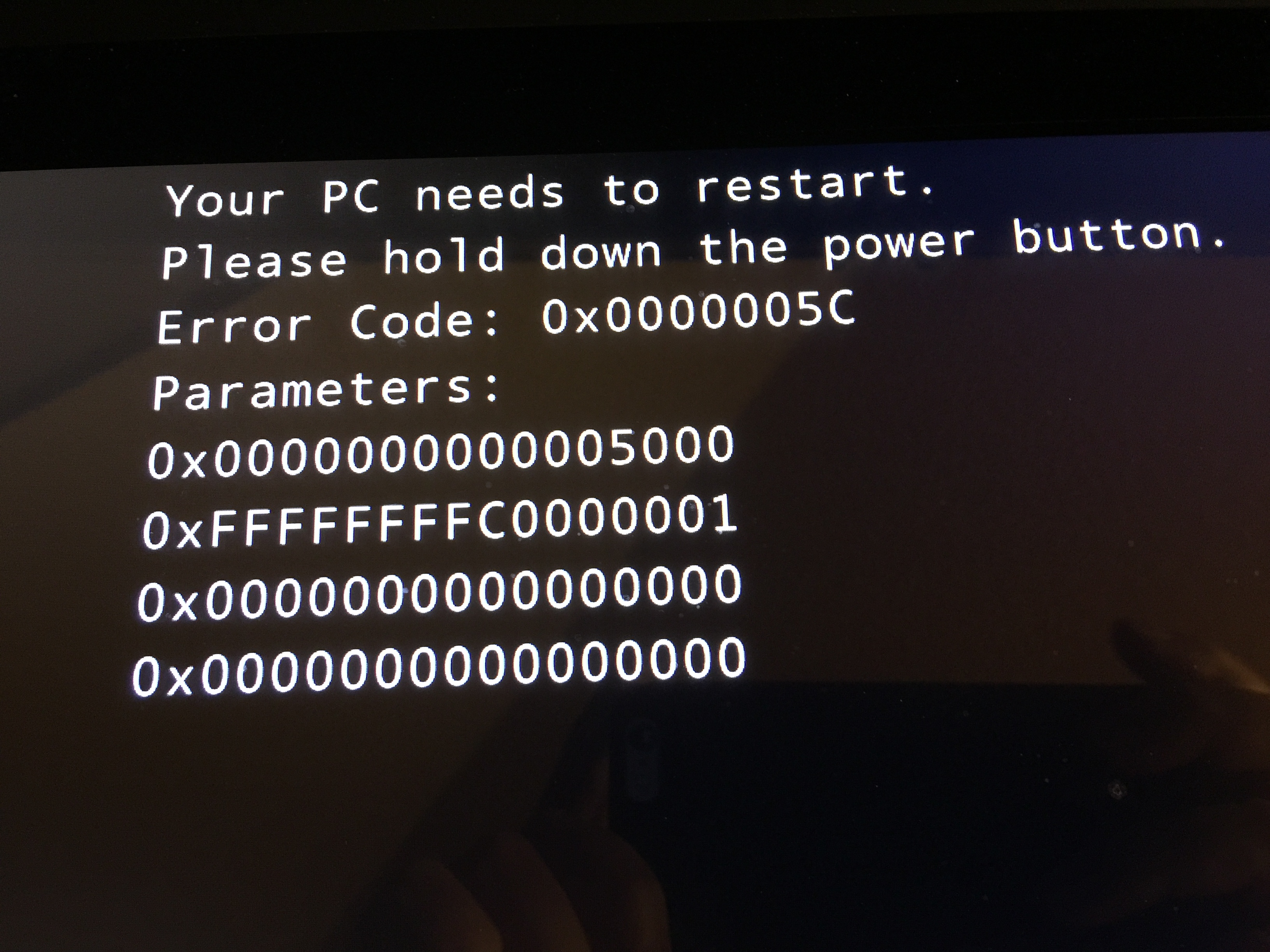

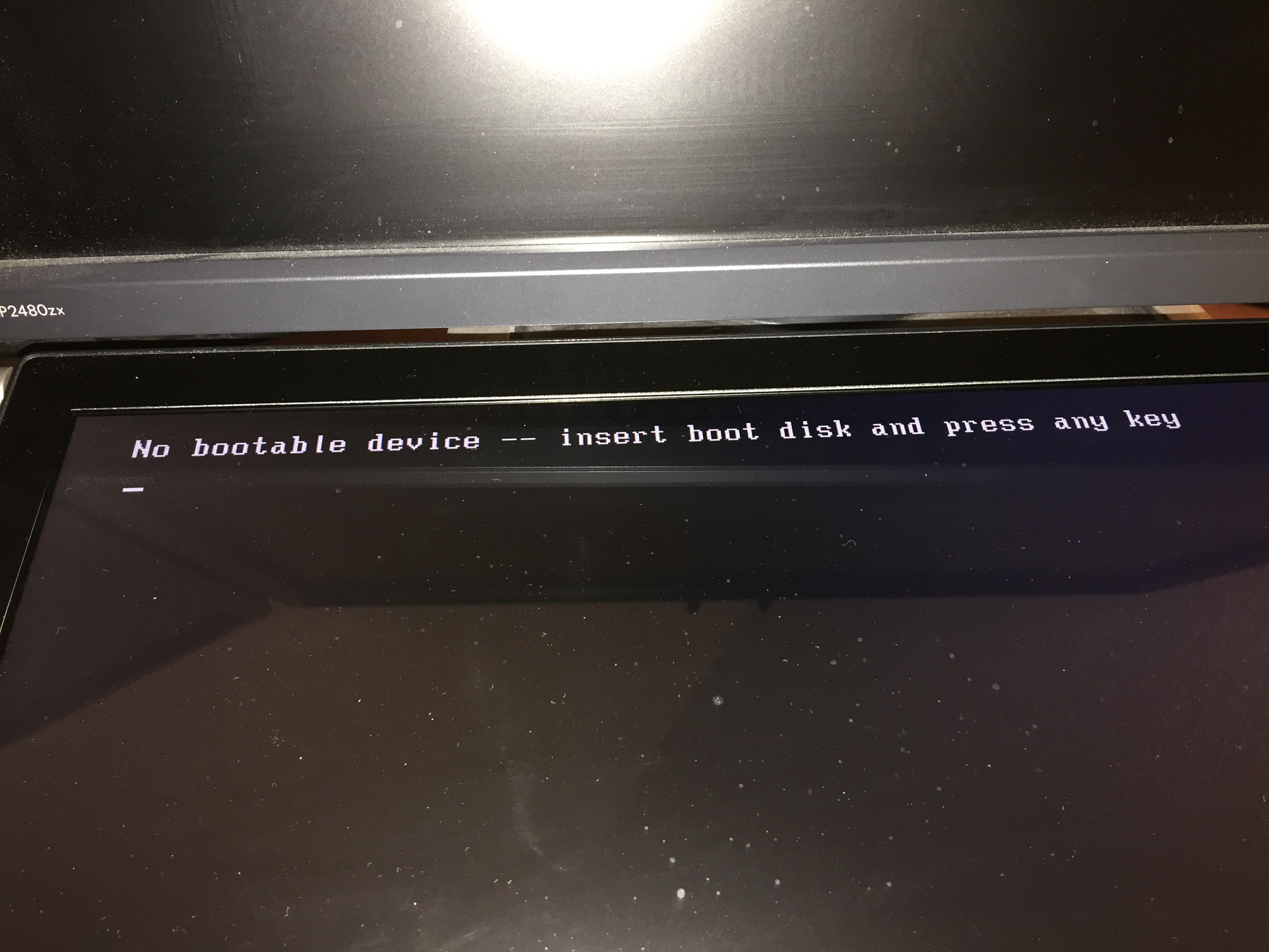

No luck atm either with the Dutch ISO in my config:
I got a never seen (by me) bootscreen:
and after that I got:
Moving bootable hardware tomorrow. Strange upgrade routine by MS....

Tried the ISO method to upgrade but it failed. Not sure if I got the right ISO file to tell you the truth. If anyone can point me to the right ISO for someone w/ a legal copy of Windows 7 Home Premium, that would be great.
I tried the windows 10 media tool or whatever its called and that didn't work as well.

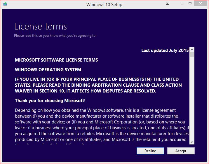

I just used the media tool method (http://www.microsoft.com/en-us/software-download/windows10) and selected the upgrade option and just followed the steps, it took a while to complete but went flawlessly. I guess the only thing one needs to worry about is whether to select 32 or 64 bit. My windows 7 was 64 so I just selected the same.
