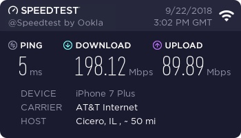

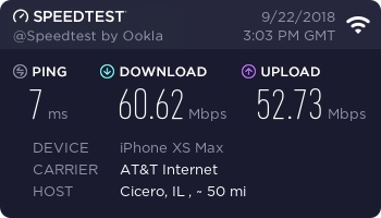

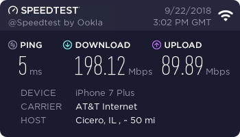

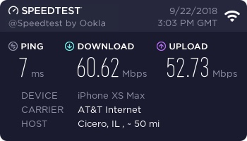

Two speed tests - faster one is from the iPhone 7 Plus, and the slower of the two is from the iPhone Xs Max. Internet is running through an enterprise-class firewall and the AP is a Ubiquiti AP-AC-Pro.
Same SSID, about 10 feet from the AP. The 7 Plus was usable from anywhere on my property. The Xs Max is almost unusable if I go to the second floor of my house.
I am not pleased - Is anyone else seeing anything similar? The Max was set up as a new phone (no restore) - and I've tried disconnecting and re-connecting to the SSID, and using different SSIDs. Similar results.
Edit: Solved - Reset network settings. Settings - General - Reset - Reset Network Settings

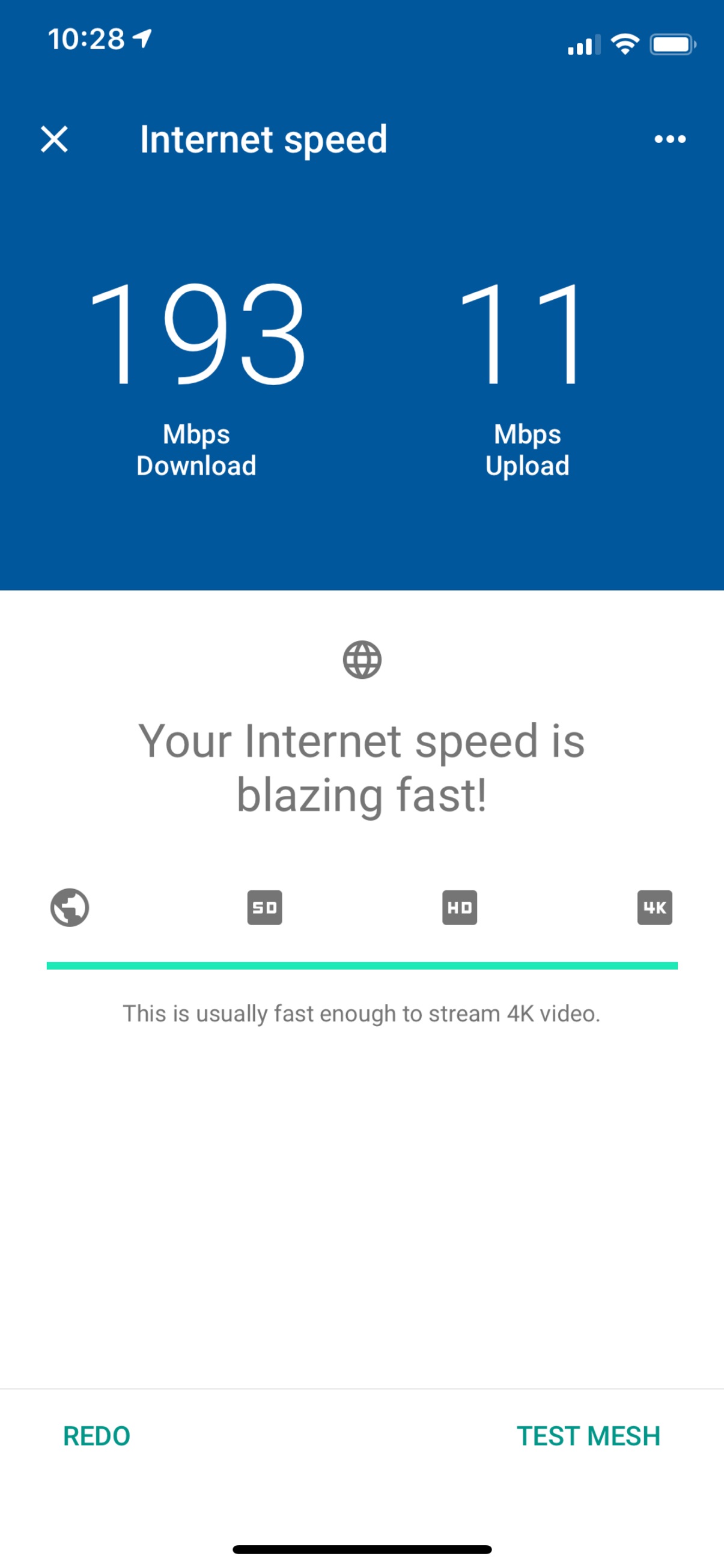

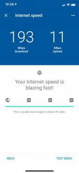

My max is getting 40 and my 8 is getting 140. We have 300 but my google Wifi has been a little finicky and I have to kids playing Fortnite right now.
Would the Max speeds be affected by the fact that my phone is still downloading it’s backup from iCloud? Or maybe my Max is on 2.4 and my 8 on 5 even if they are next to each other?
I’ll find my X and test it too...but usually My X and 8 were similar.

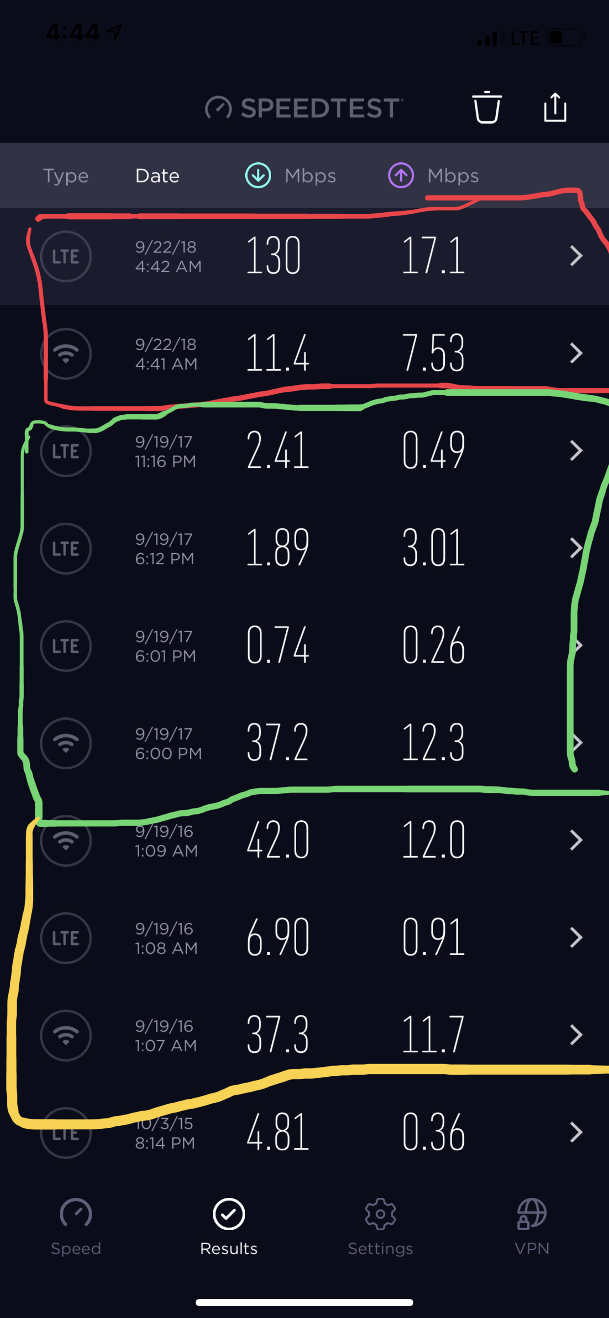

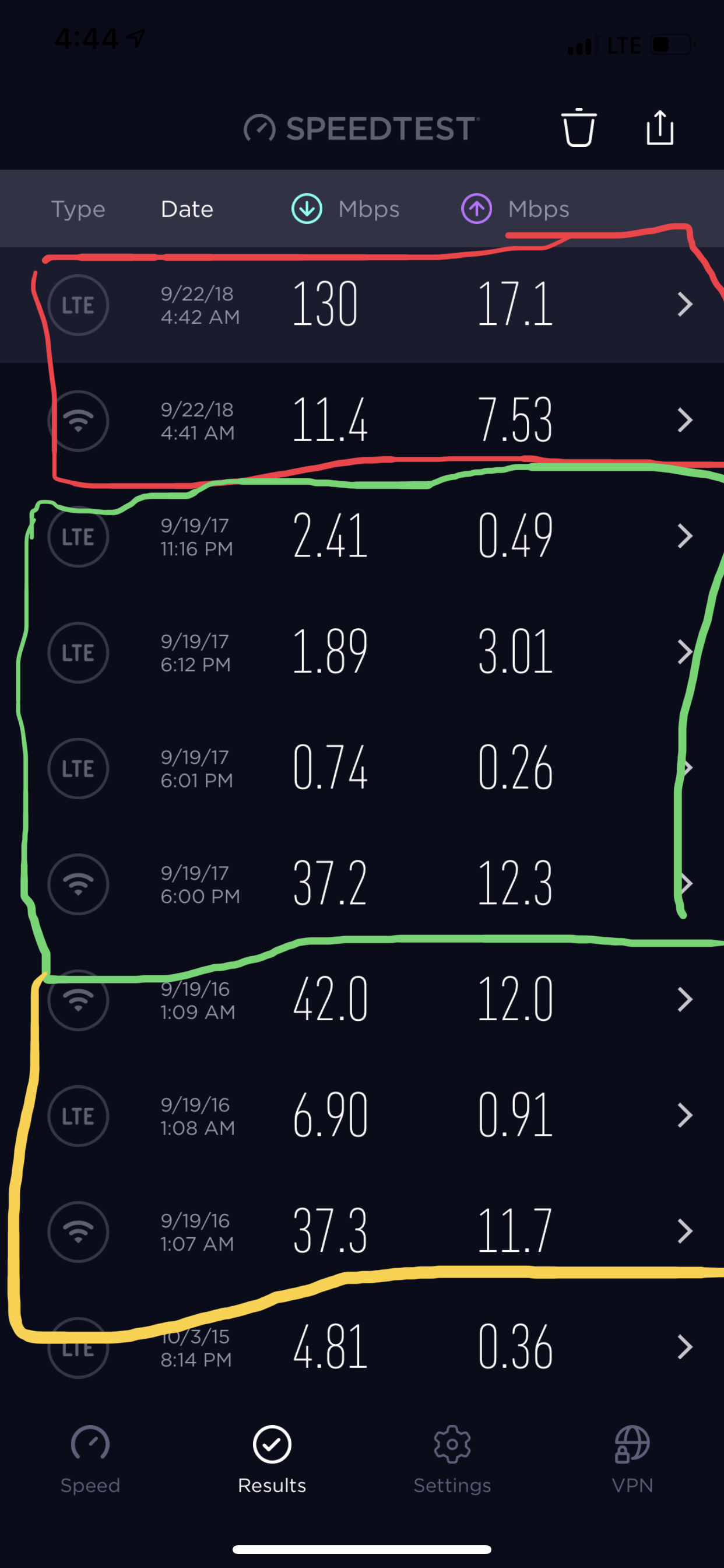

I'm having the same problem! Red is Xs Max... Switching to Verizon is a great choice lol.

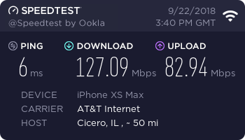

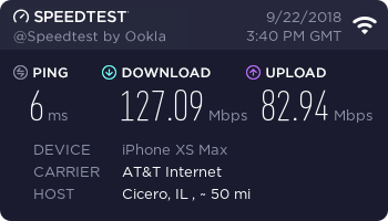

Sitting in another room about 25 feet from AP and this is more like it:
