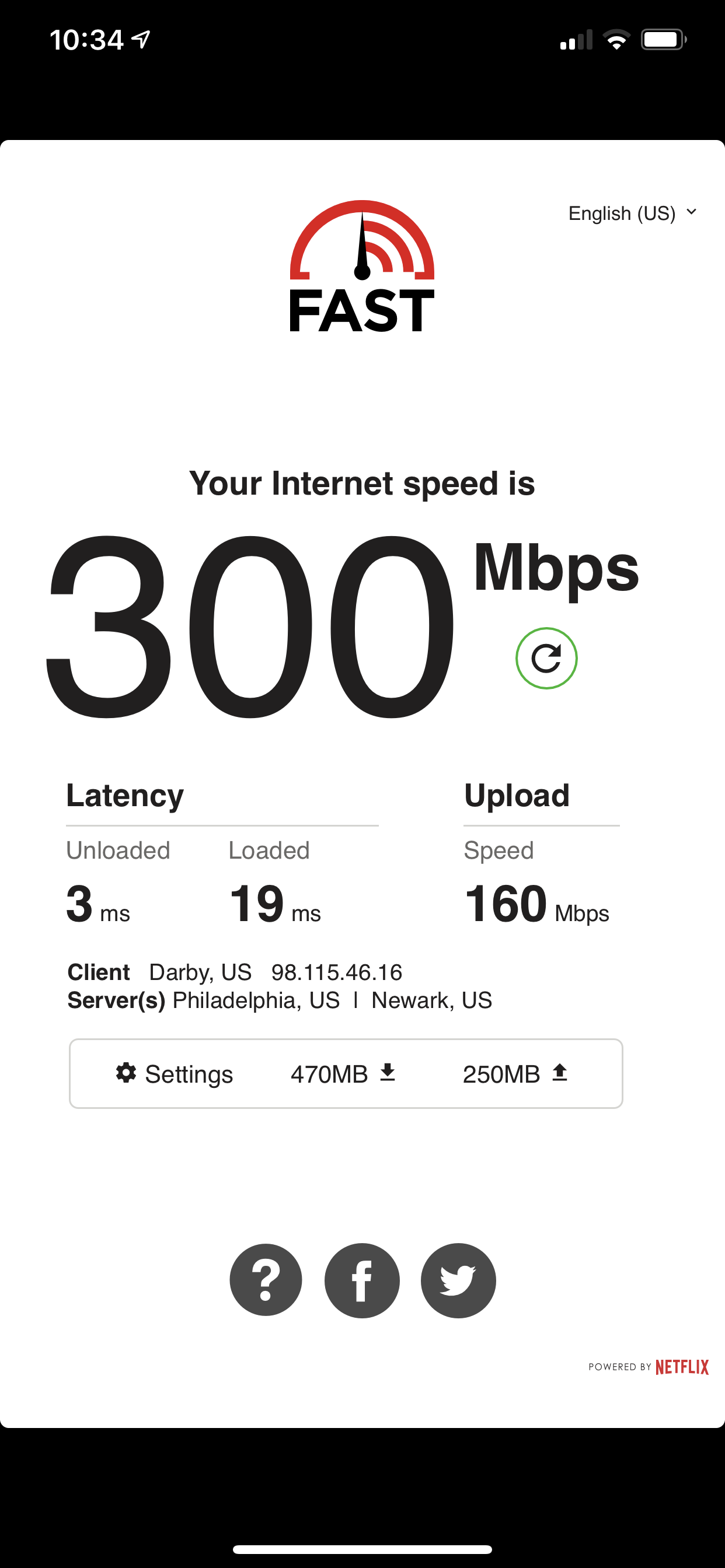

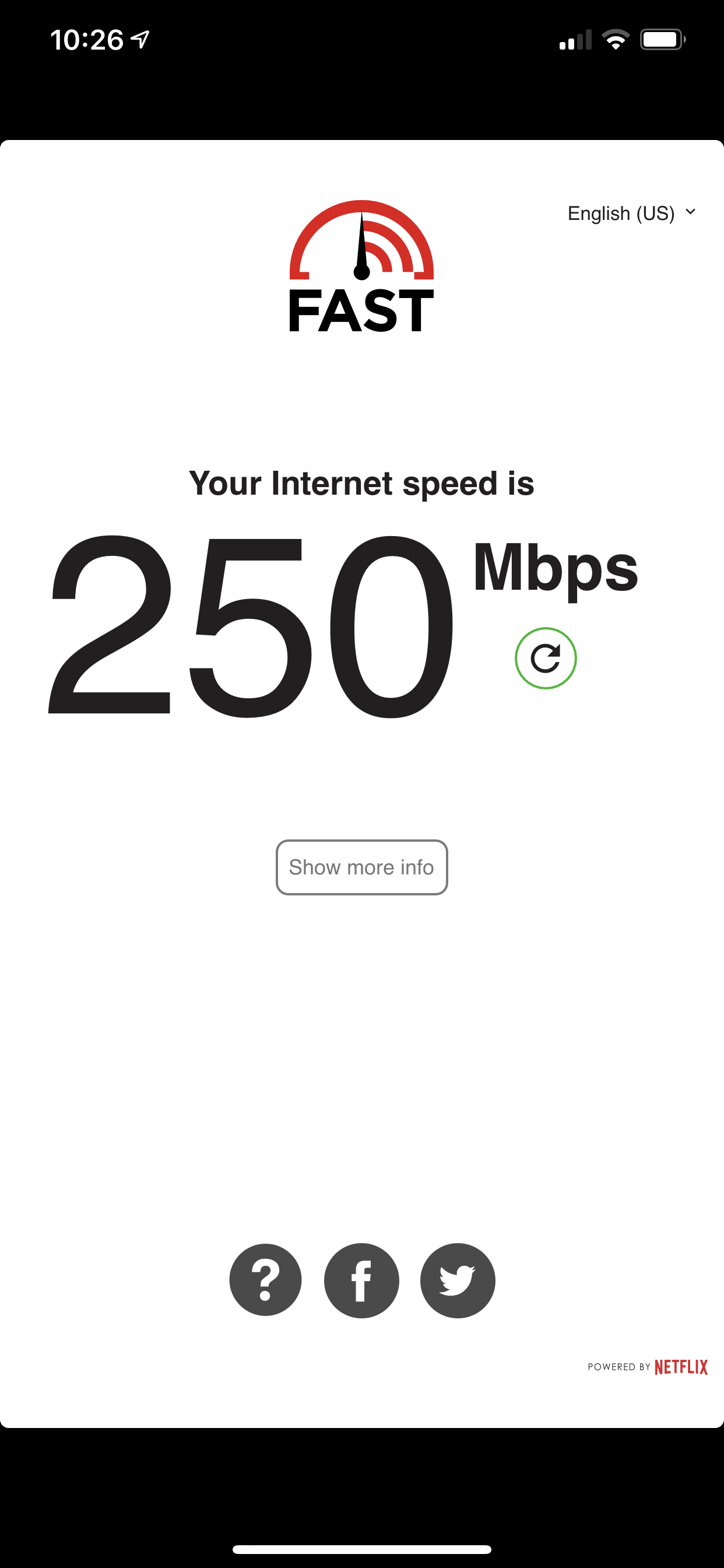

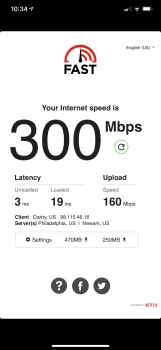

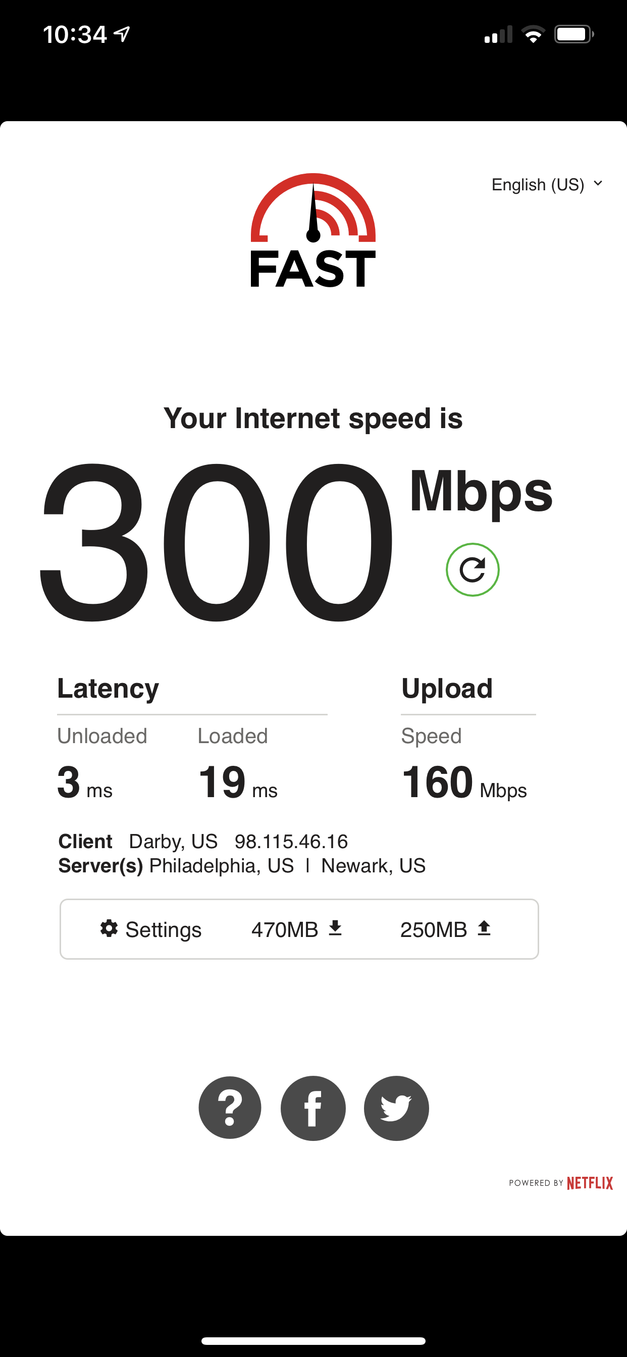

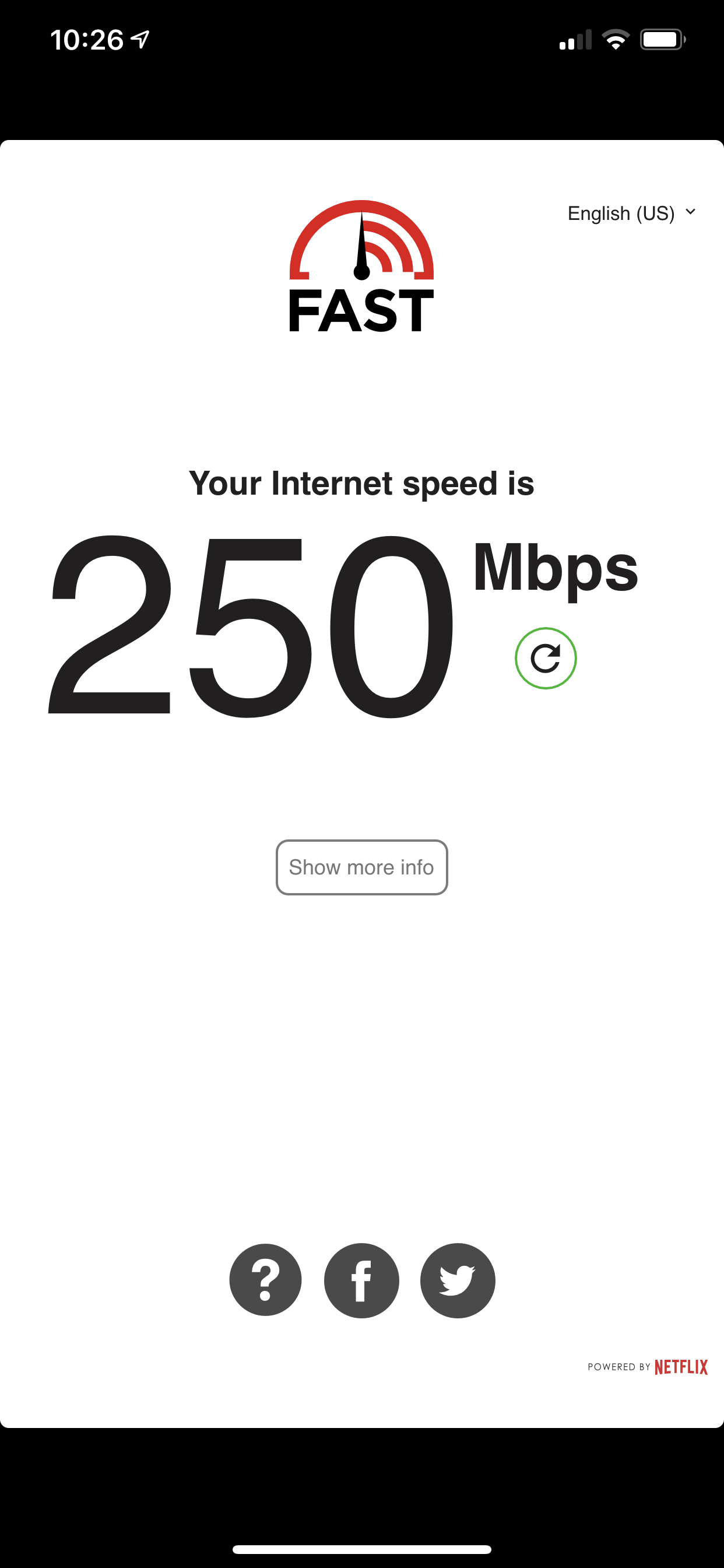

Before network settings reset I got this: 396C5096-F912-4B6A-AB8B-68254C3C8862.png
And after network reset:
Both test is in my bedroom... I usually get double the first test in my living room... I’m satisfied for a 5GHz connection
