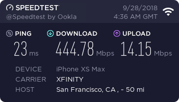

Comcast internet with XS Max
I've tried the reset network, disabling WiFi assist, home network reset and modem reset options. All work temporarily, but my iphone xs max eventually goes back to the 2.4 network. Will consider setting up as a new iphone as a last resort - it's a real PIA to do so. I currently have an eero setup at home so I can't set up an SSID for both 2.4 and 5.

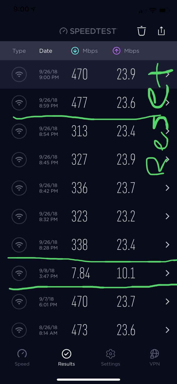

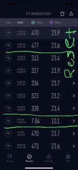

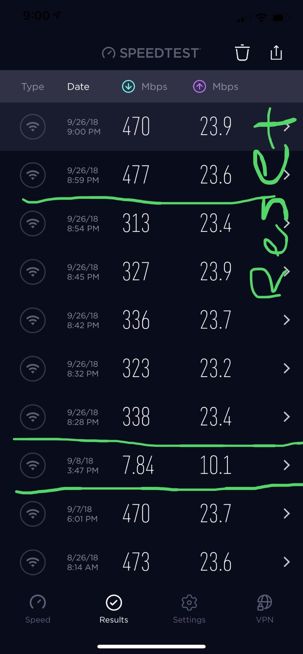

so glad I found this thread. I have separate SSIDs for 2.4 vs 5 networks in my house so I haven't noticed an issue there. My issue was simply that my 400/20 internet connection that I have always realistically gotten 460-470/23 on was maxing out in the mid 300s on my XS Max. (this is with no other wireless devices connected and LONG after my iCloud restore had completed). Went in and did the network settings reset and instantly was back up to the 470/23 I had always gotten on my X. I did the reset back on 9/26 and all still seems normal speed-wise as of this morning. very strange....
