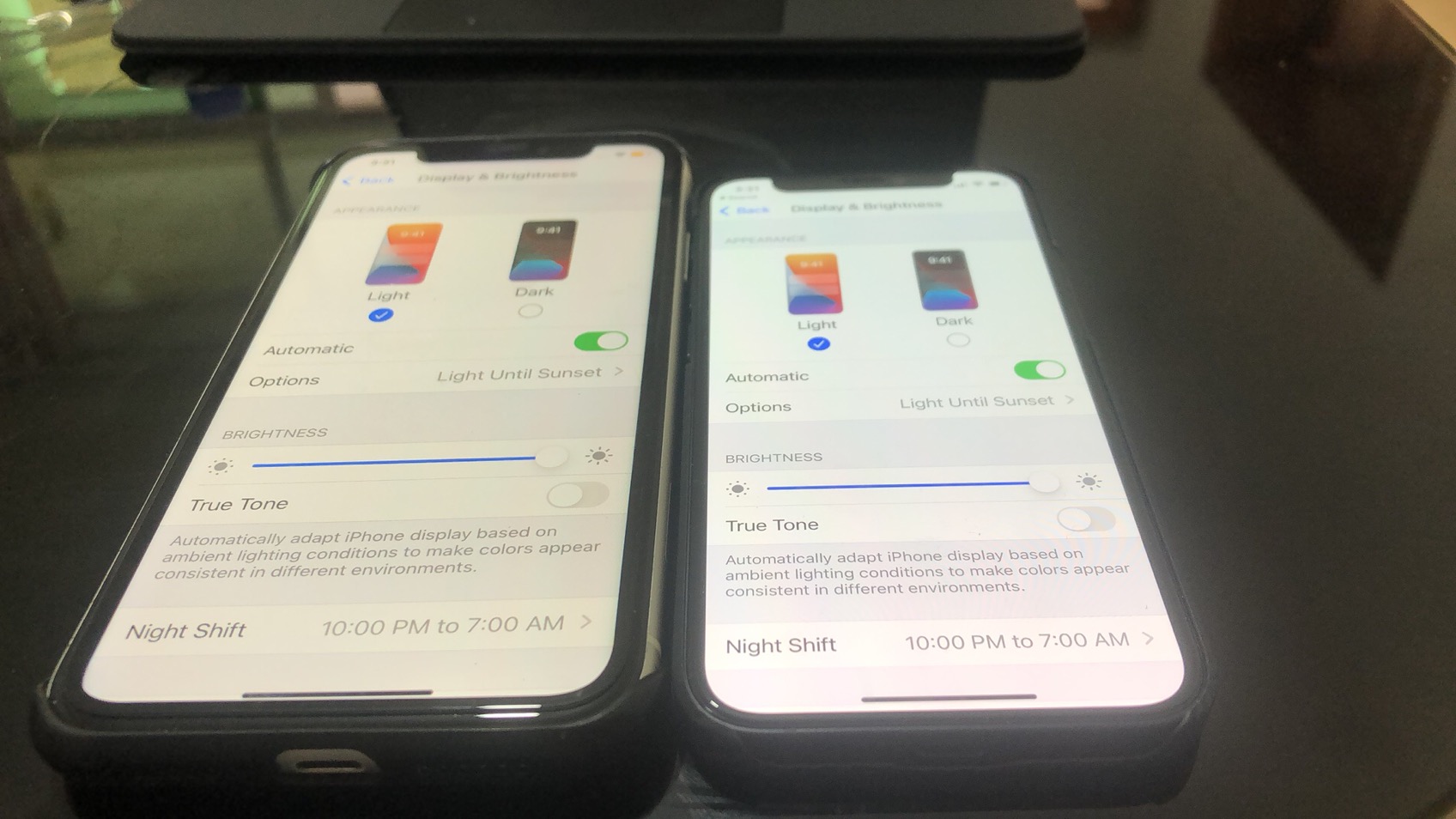

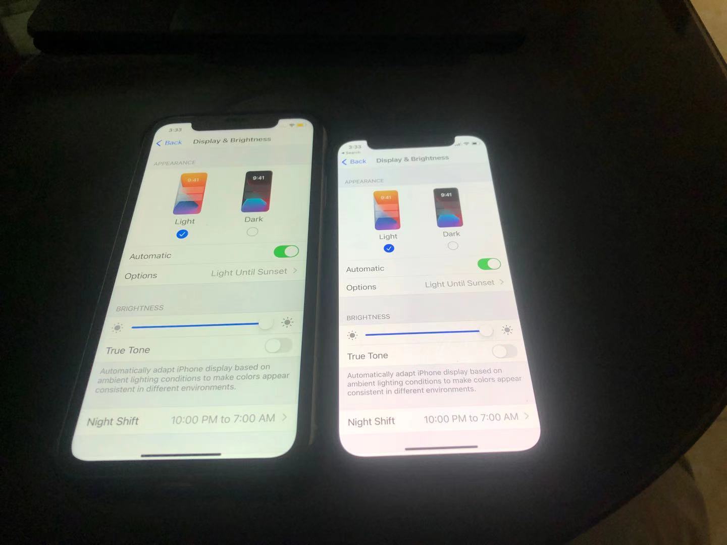

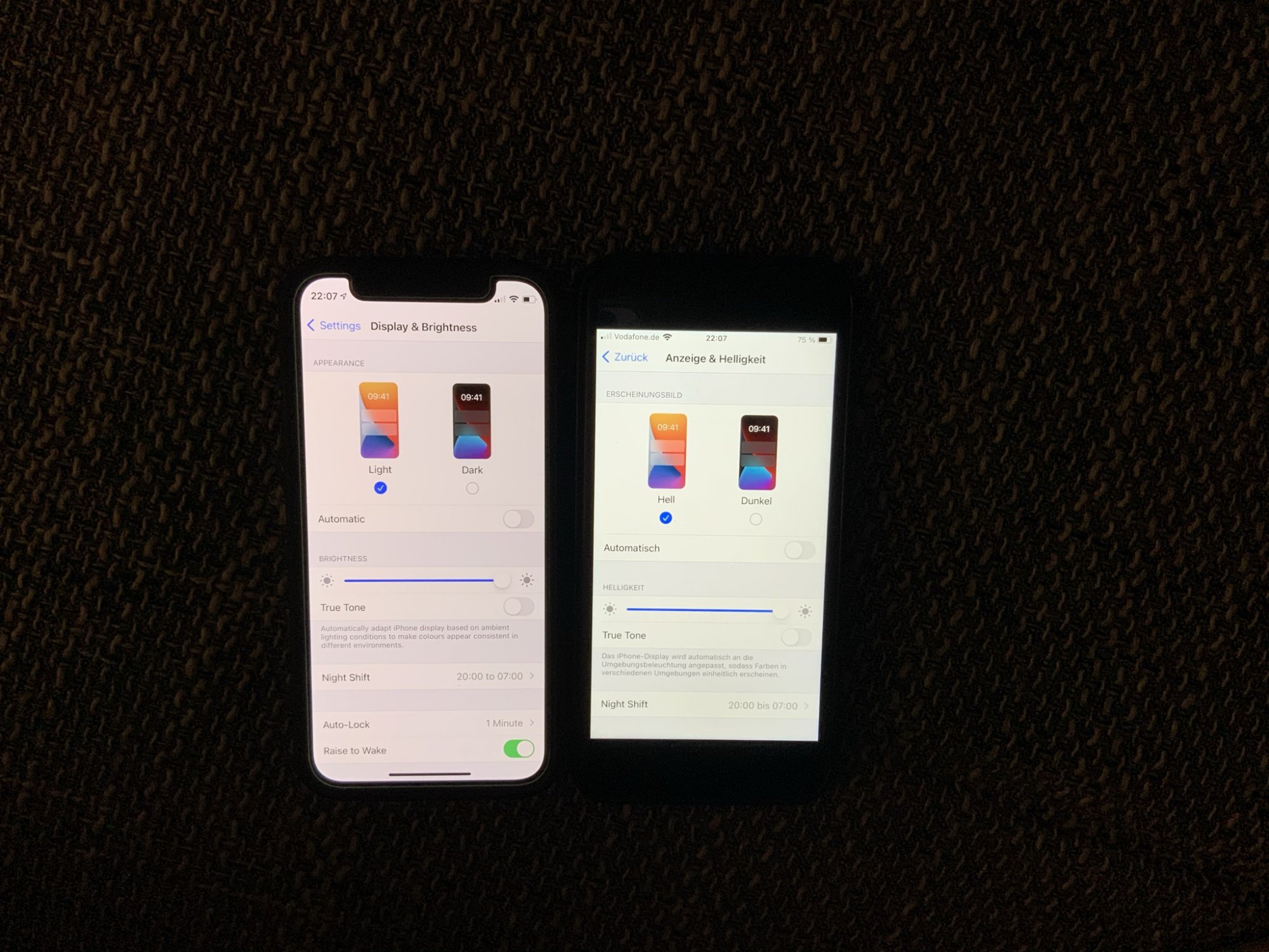

I guess comparing LCD to OLED is silly. XR vs Mini
Looks the same as mine. Maybe my expectations just need to be tempered?? LCD is brighter than OLED after all??

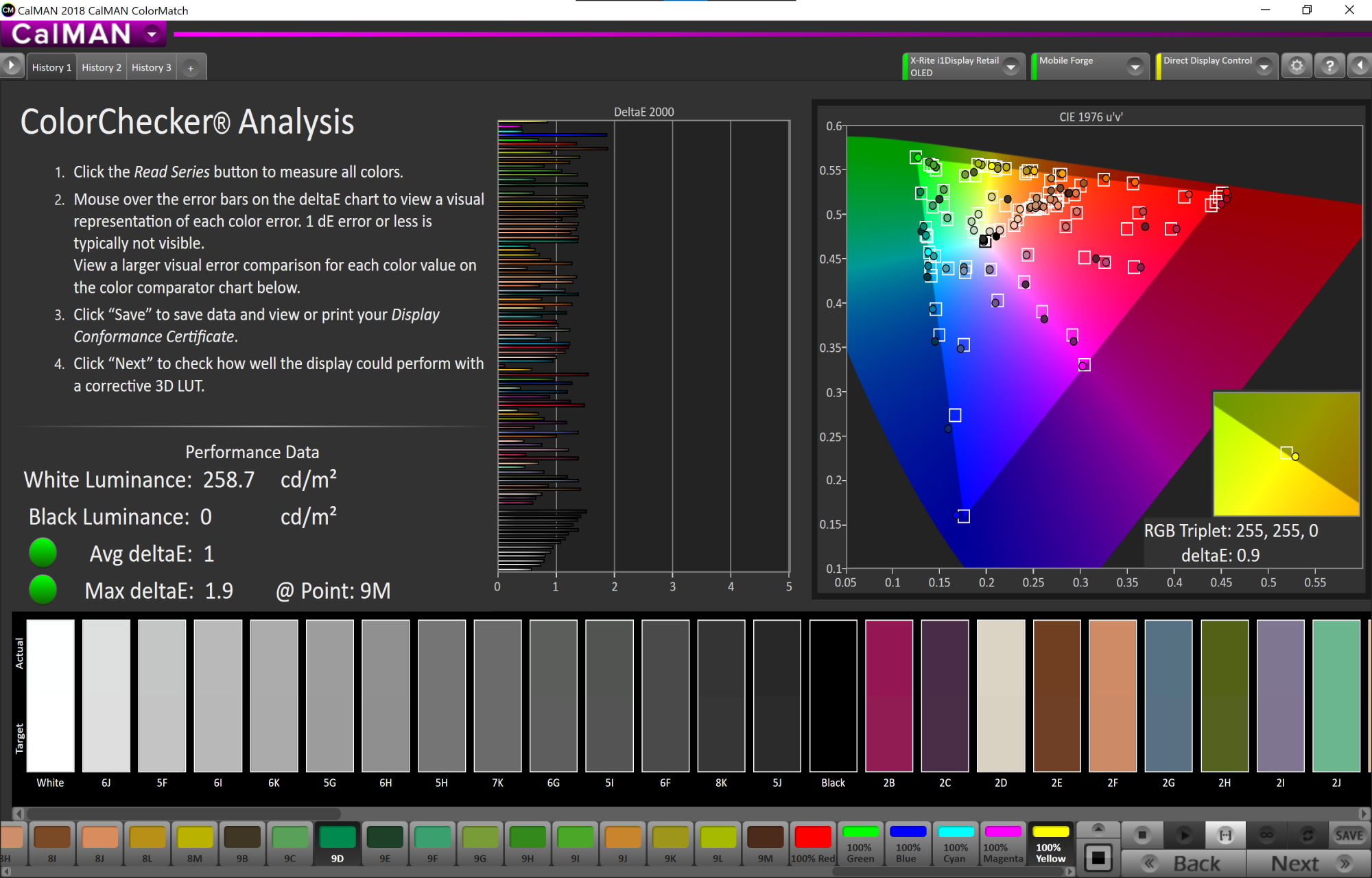

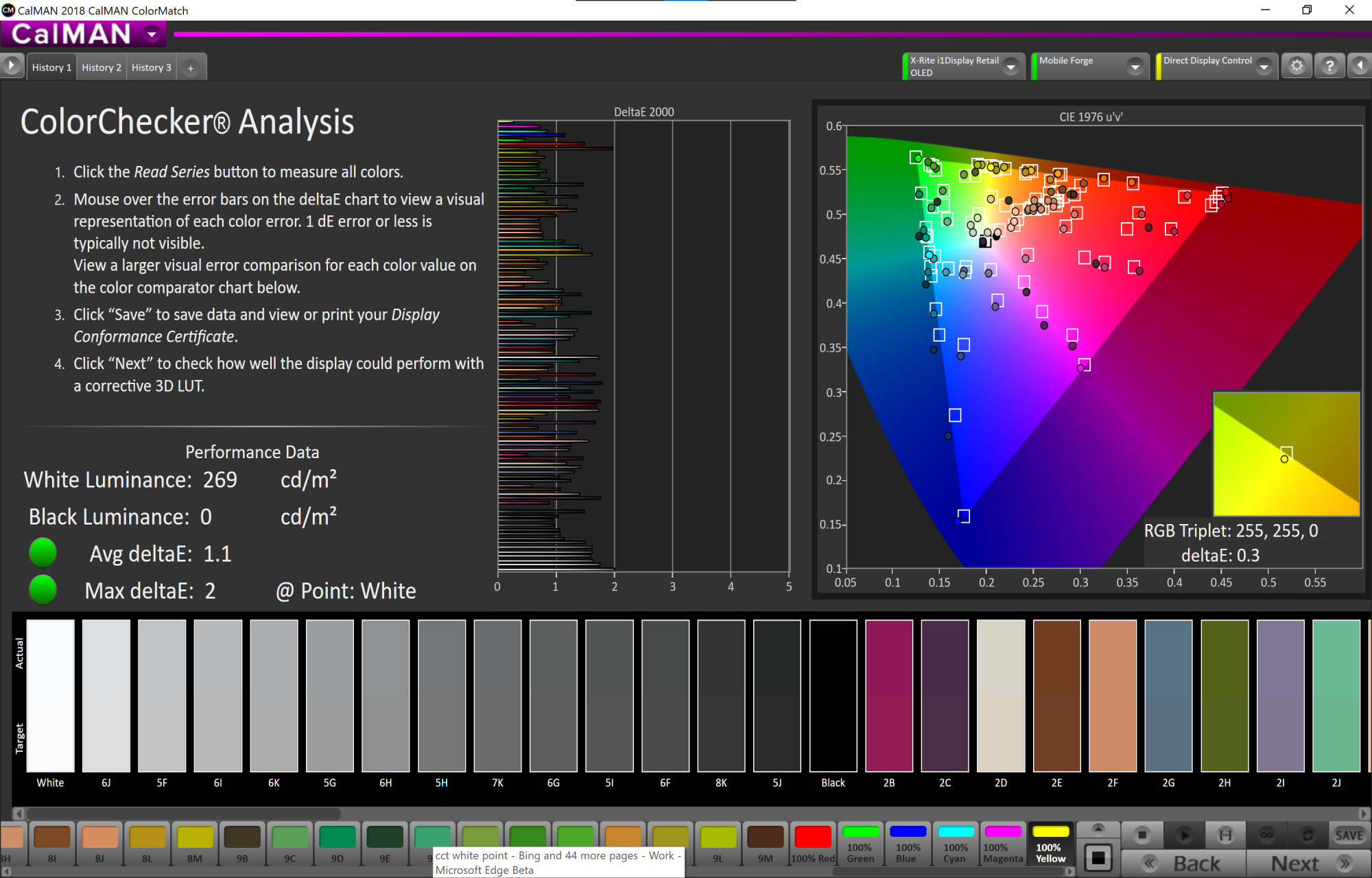

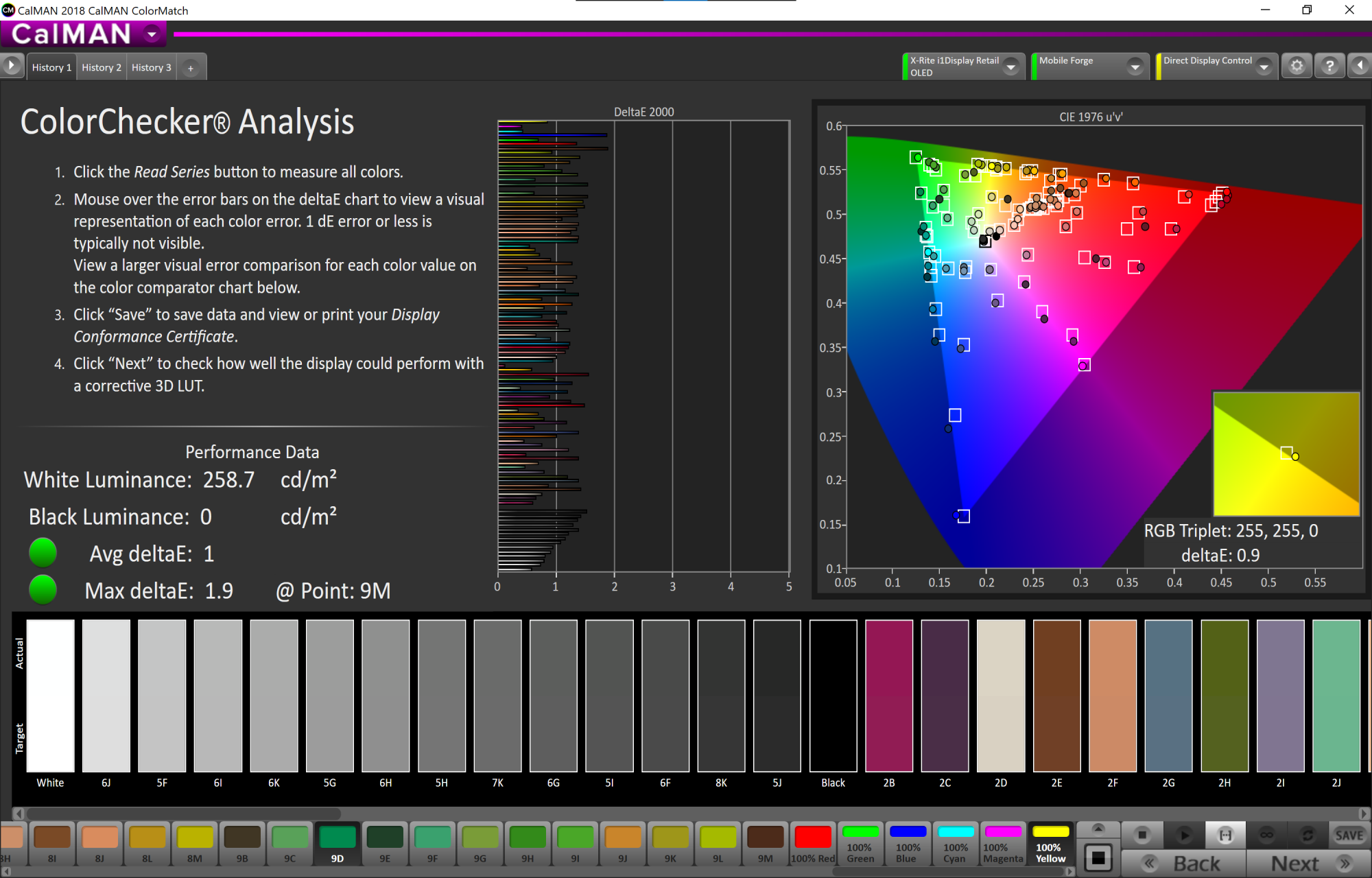

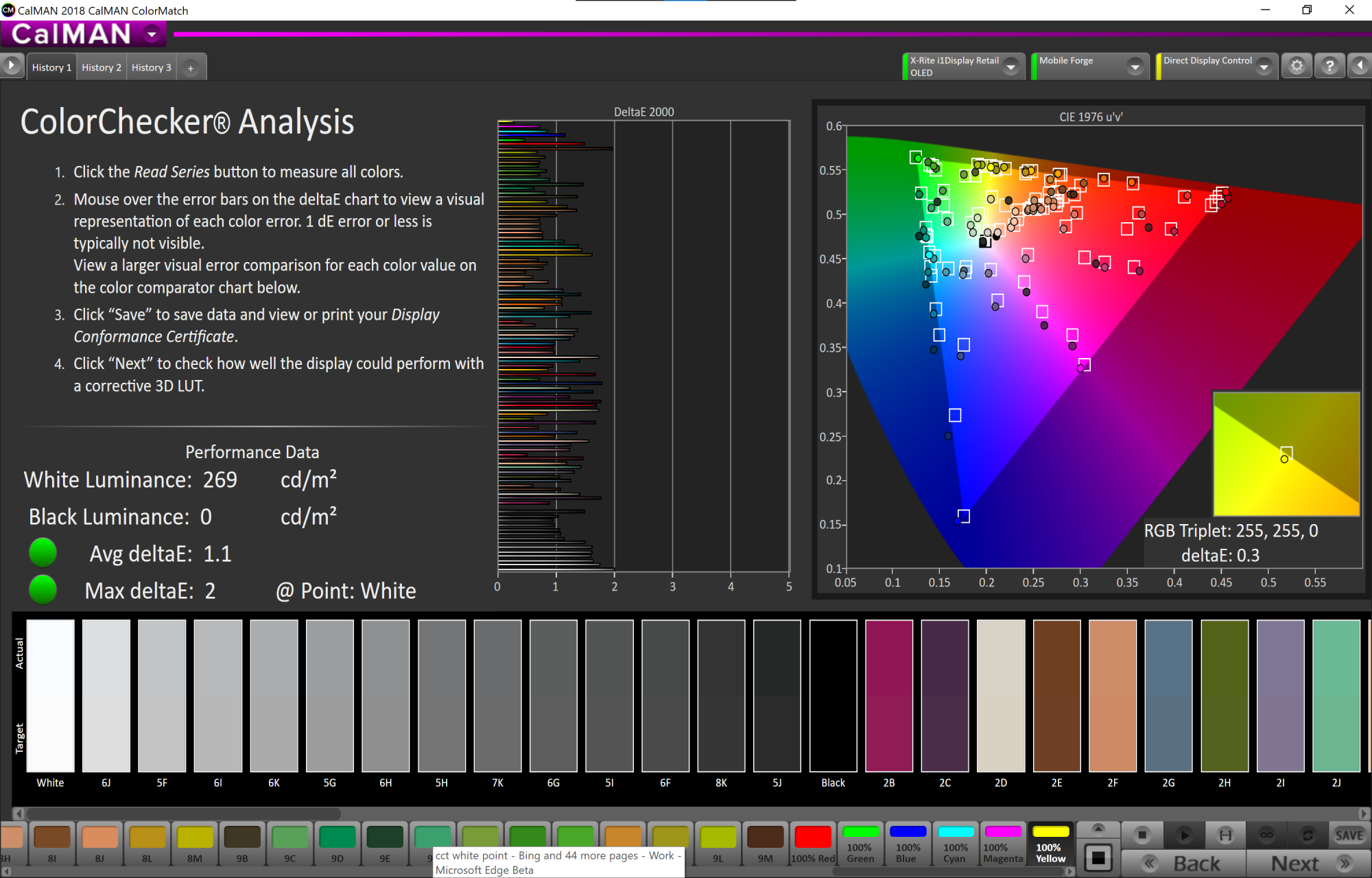

I wanted to put some data to this question.
Using sRGB target, D65:
My 11PM measured 6750k with an avg ΔE 1.1, max ΔE 2
My 12PM measured 6520k with an avg ΔE 1, max ΔE 1.9. We can see the grays on the 12PM have greater ΔE, especially the dark grays, compared with the 11PM ΔE around the same color bands. This lines up with the slight tinge, especially when dark. So no, you aern't crazy if you see this. But overall, the 12PM display maybe appears slightly more even in regards to ΔE across the board compared to 11PM?
So this reflects the slightly warmer tone the 12PM has for me, but I found both phones to have surprisingly tight calibration from the factory. Don't forget to disable night-shift as I forgot the first time and it also made a difference.

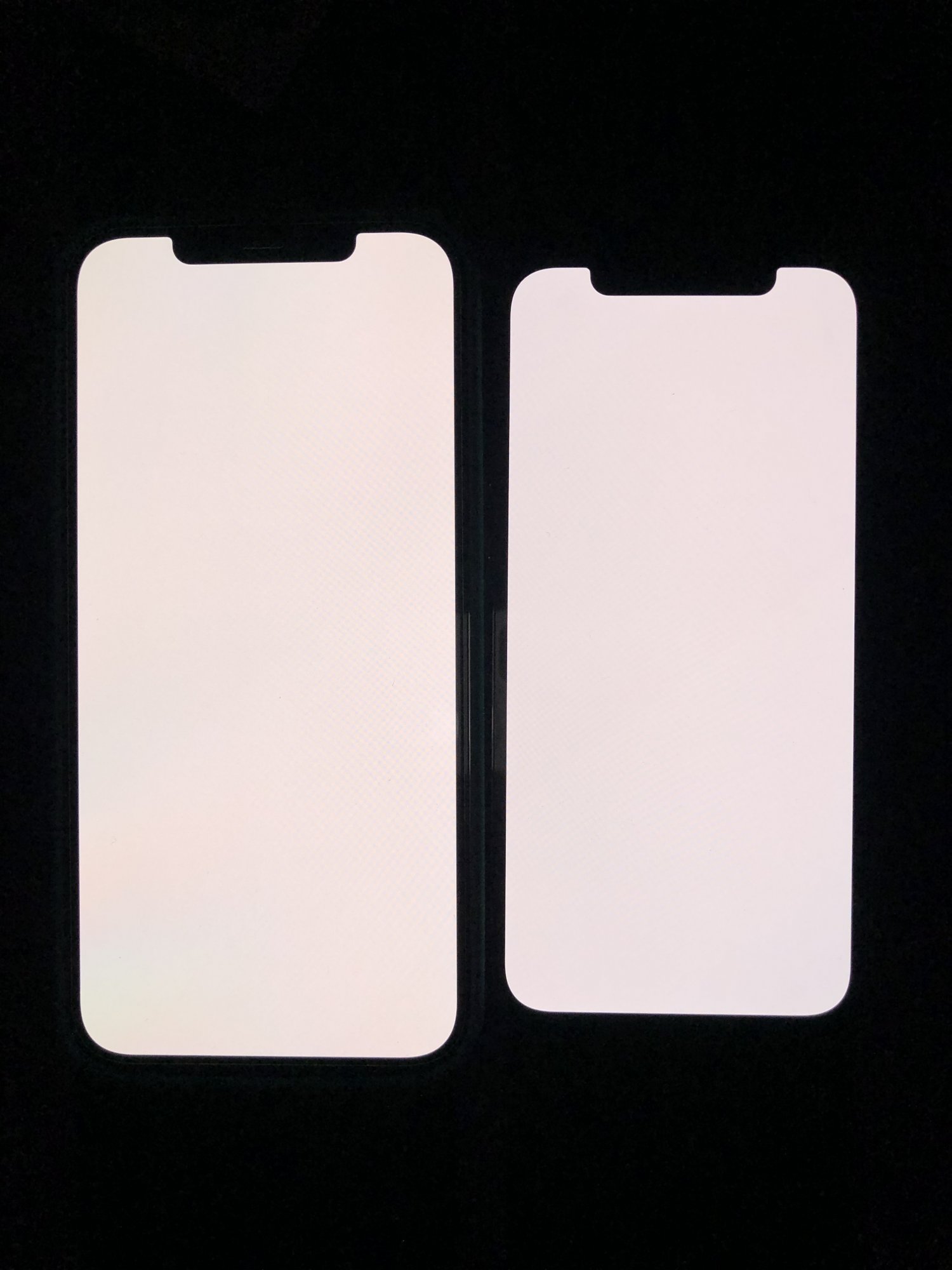

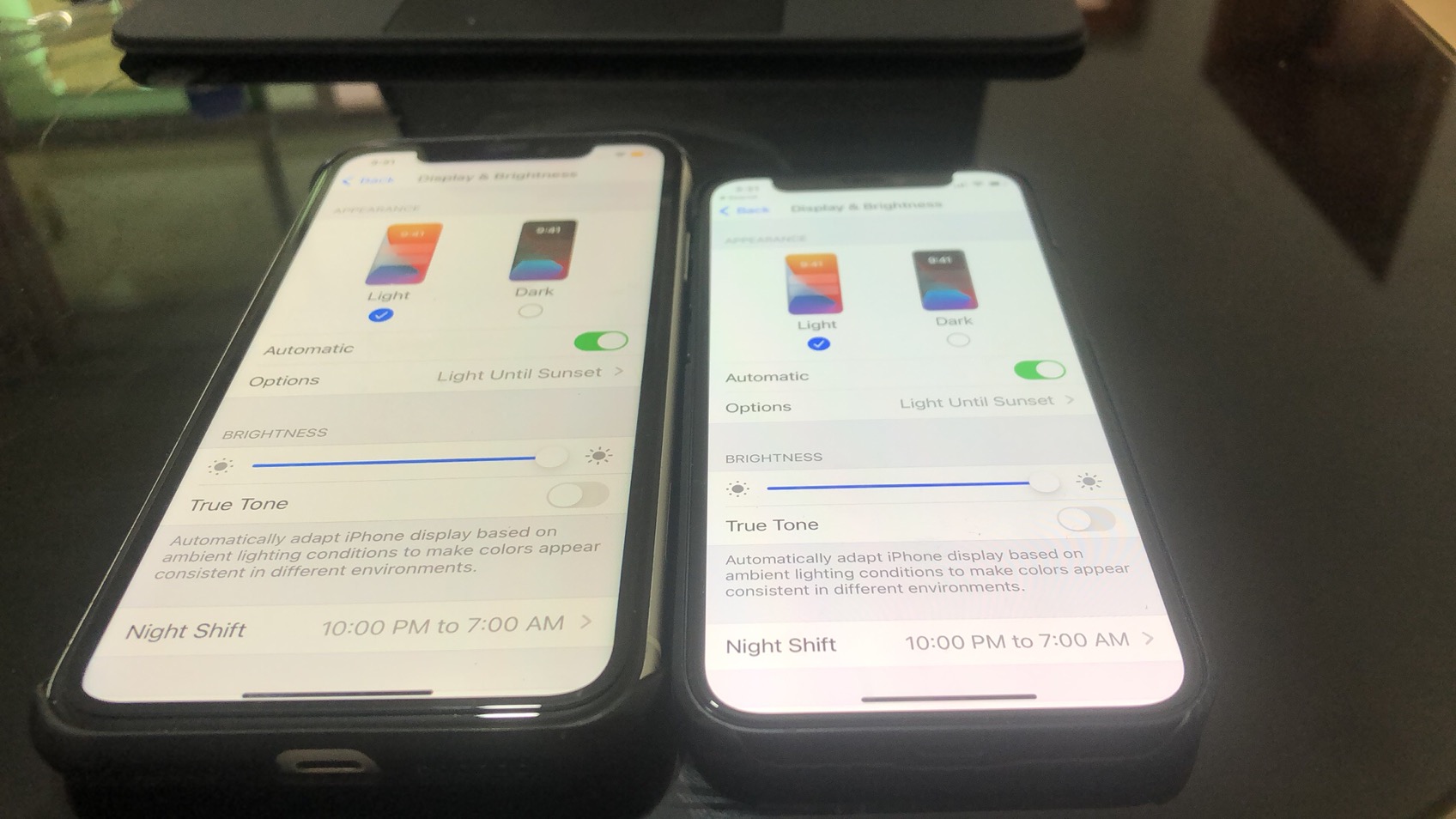

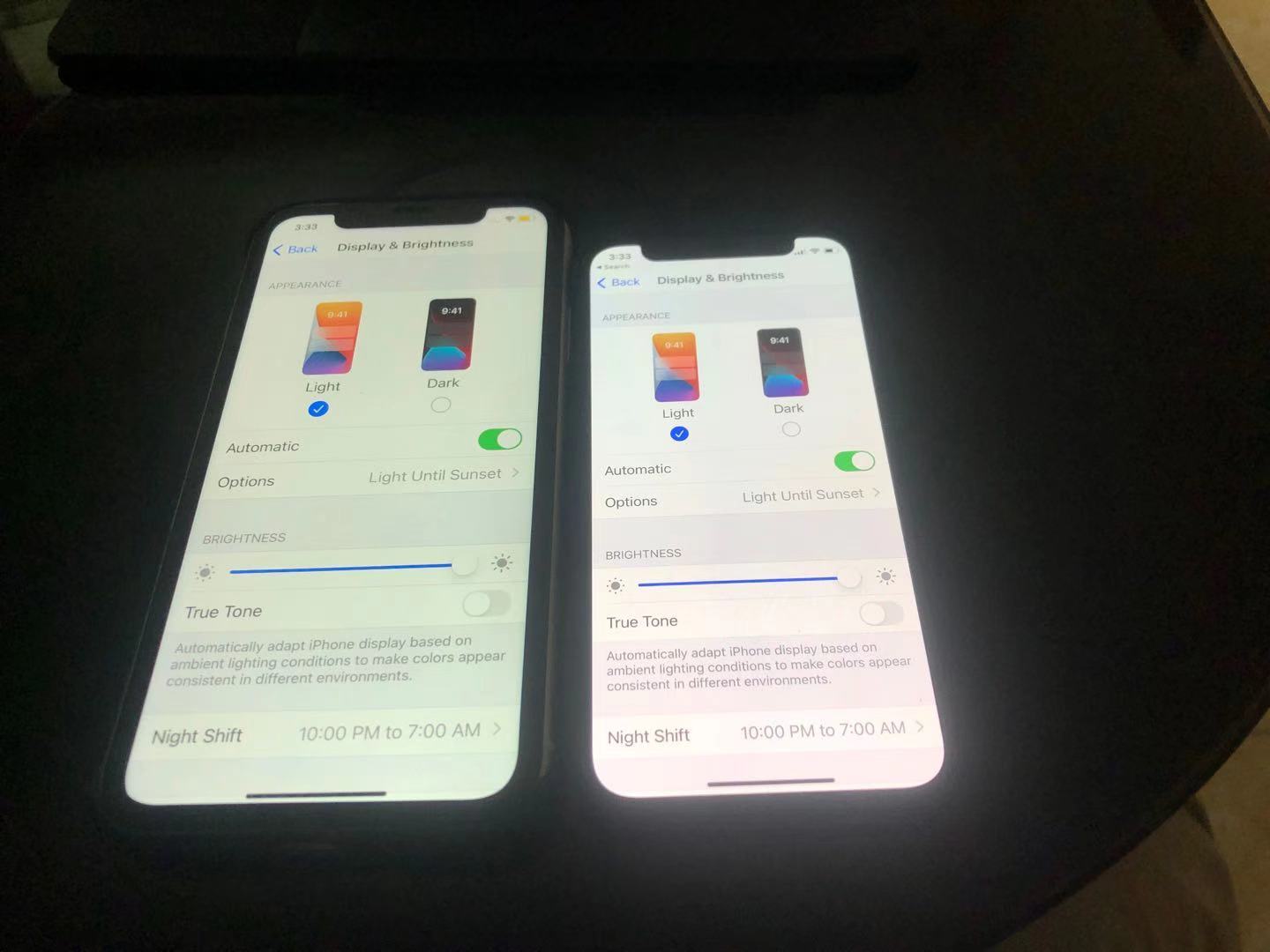

My two 12 pro max , the left one(gold) is more yellowing than the right one(graphite). Very noticeable
Got my 2nd Graphite 12 Pro Max (Left) and compare to the 12 Pro(right) still show slightly yellowing . I will have to accept this now otherwise the lottery will go on and on . Never compare the 12s to X or Xs, it will make it more noticeable and no matter how many phones you replaced it is just the natural of 12 I guess.

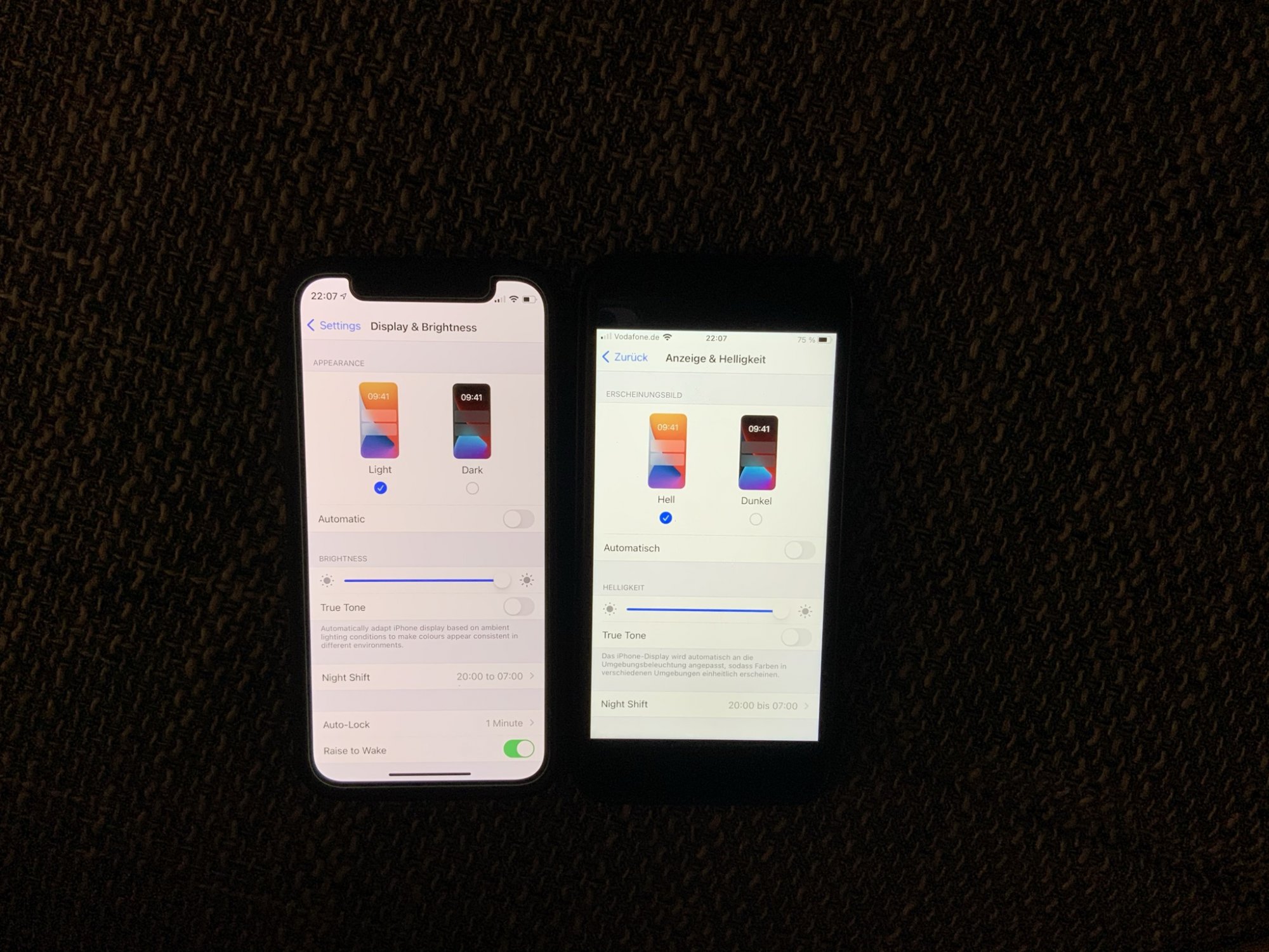

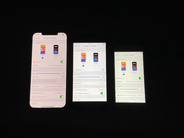

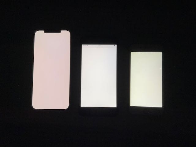

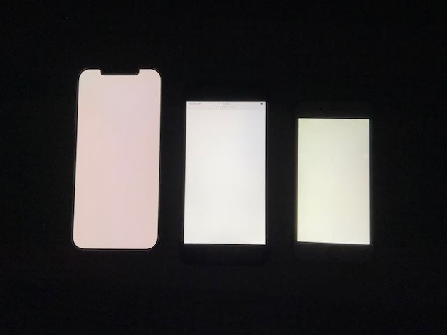

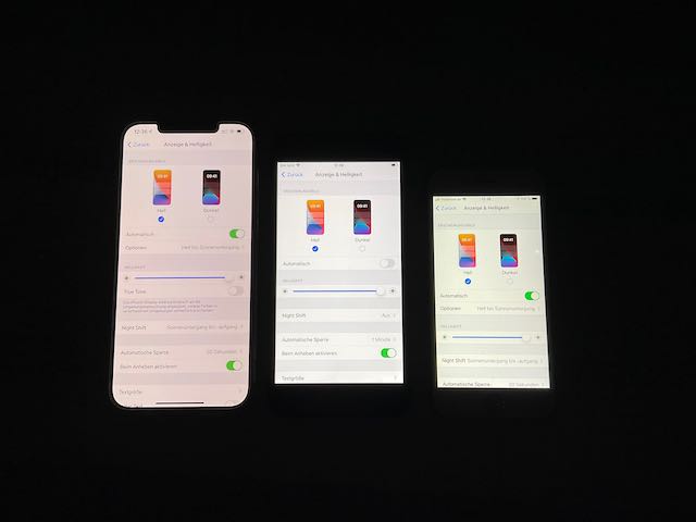

I was curious and just compared my new iPhone 12 Pro Max with my iPhone 7 Plus and iPhone 6s. Out of those, I would say the iPhone 6s got the worst screen. The 7 Plus is very bright and white but I wouldn't even go as far as saying that my iPhone 12 Pro Max screen is "yellow", its just somewhat dimmer. However, isn't this to be expected with an OLED screen? I'll also compare it to my XS Max later, I gave that one to my bf. I personally prefer the color of the 12 Pro Max. The 7 Plus might be brighter but it looks so deadly "white". Now the 6s is what I would actually call yellow.ish

That is fancy, but I dont understand anything about it. Can that be adjusted via an update?
