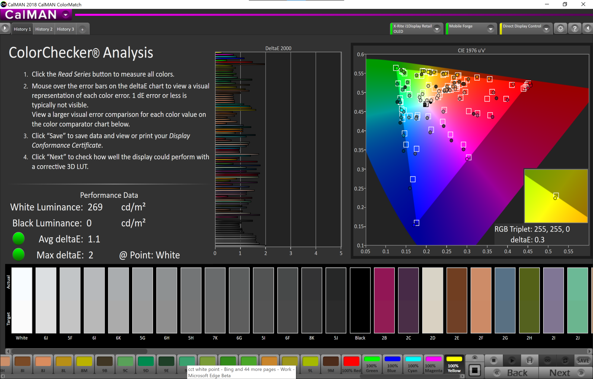

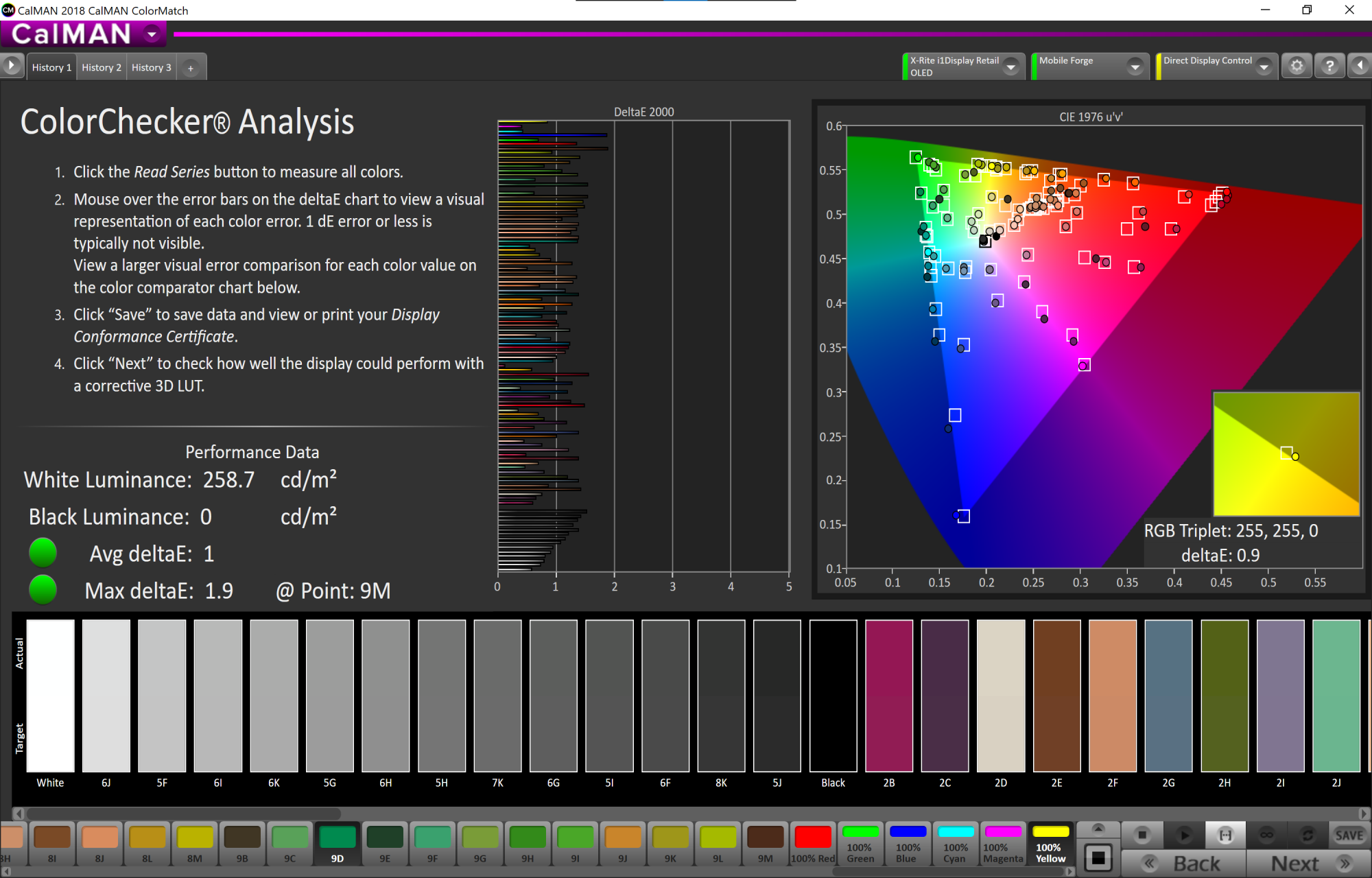

I wanted to put some data to this question.
Using sRGB target, D65:
My 11PM measured 6750k with an avg ΔE 1.1, max ΔE 2
My 12PM measured 6520k with an avg ΔE 1, max ΔE 1.9. We can see the grays on the 12PM have greater ΔE, especially the dark grays, compared with the 11PM ΔE around the same color bands. This lines up with the slight tinge, especially when dark. So no, you aern't crazy if you see this. But overall, the 12PM display maybe appears slightly more even in regards to ΔE across the board compared to 11PM?
So this reflects the slightly warmer tone the 12PM has for me, but I found both phones to have surprisingly tight calibration from the factory. Don't forget to disable night-shift as I forgot the first time and it also made a difference.

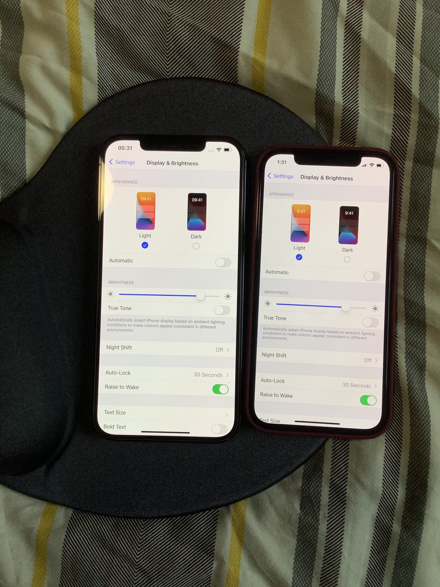

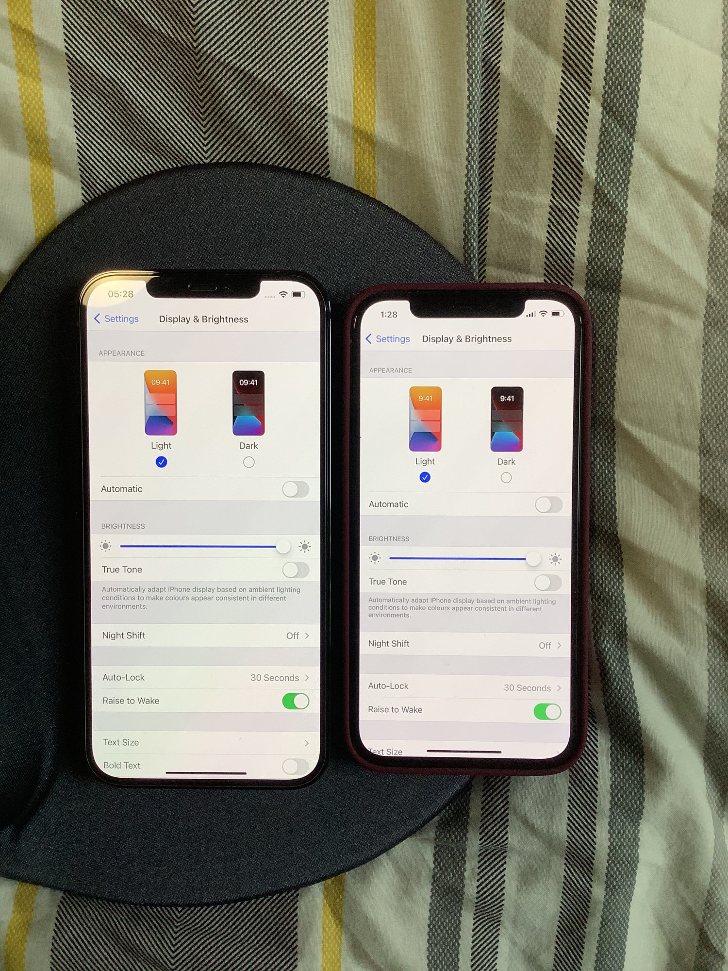

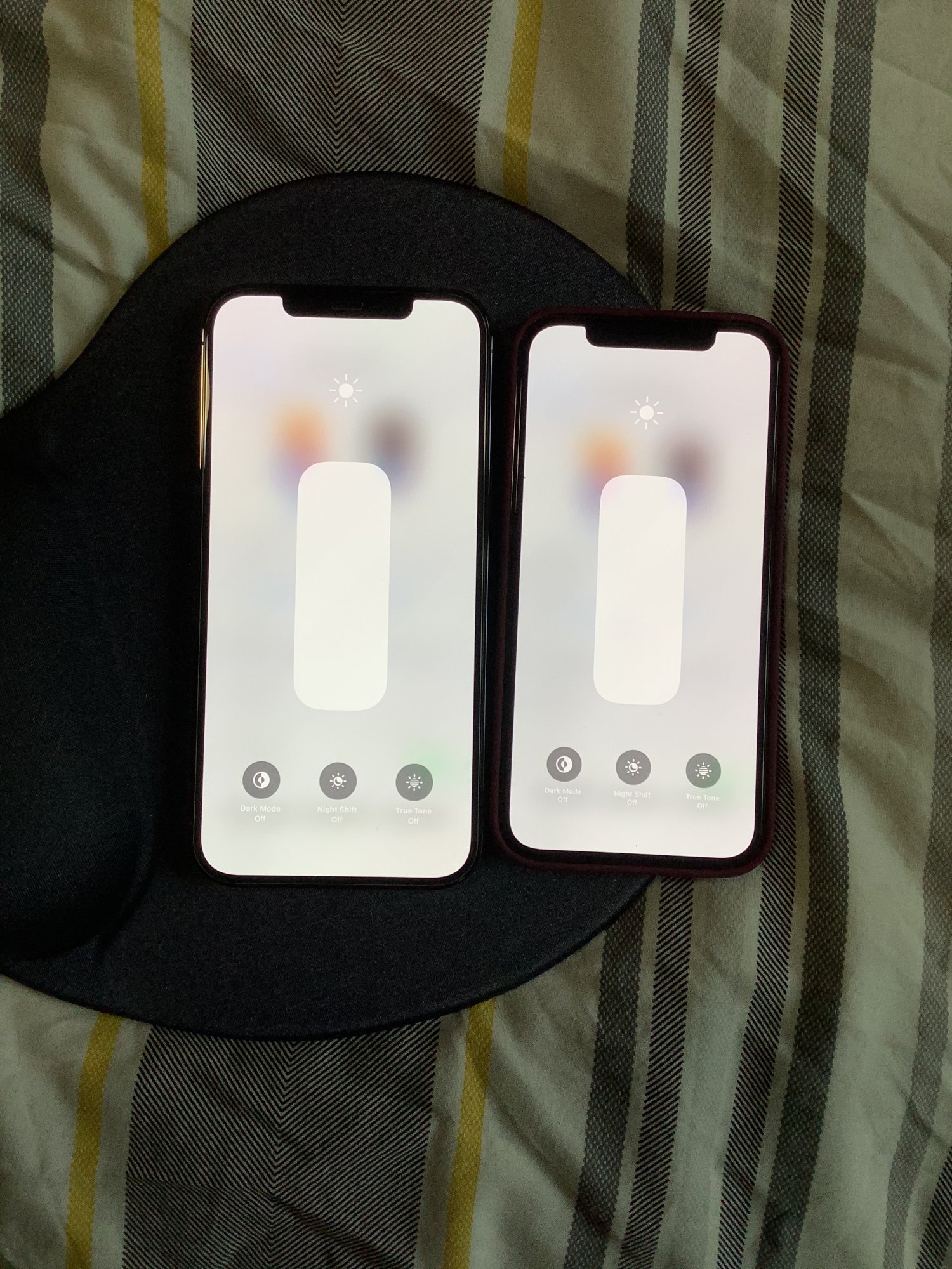

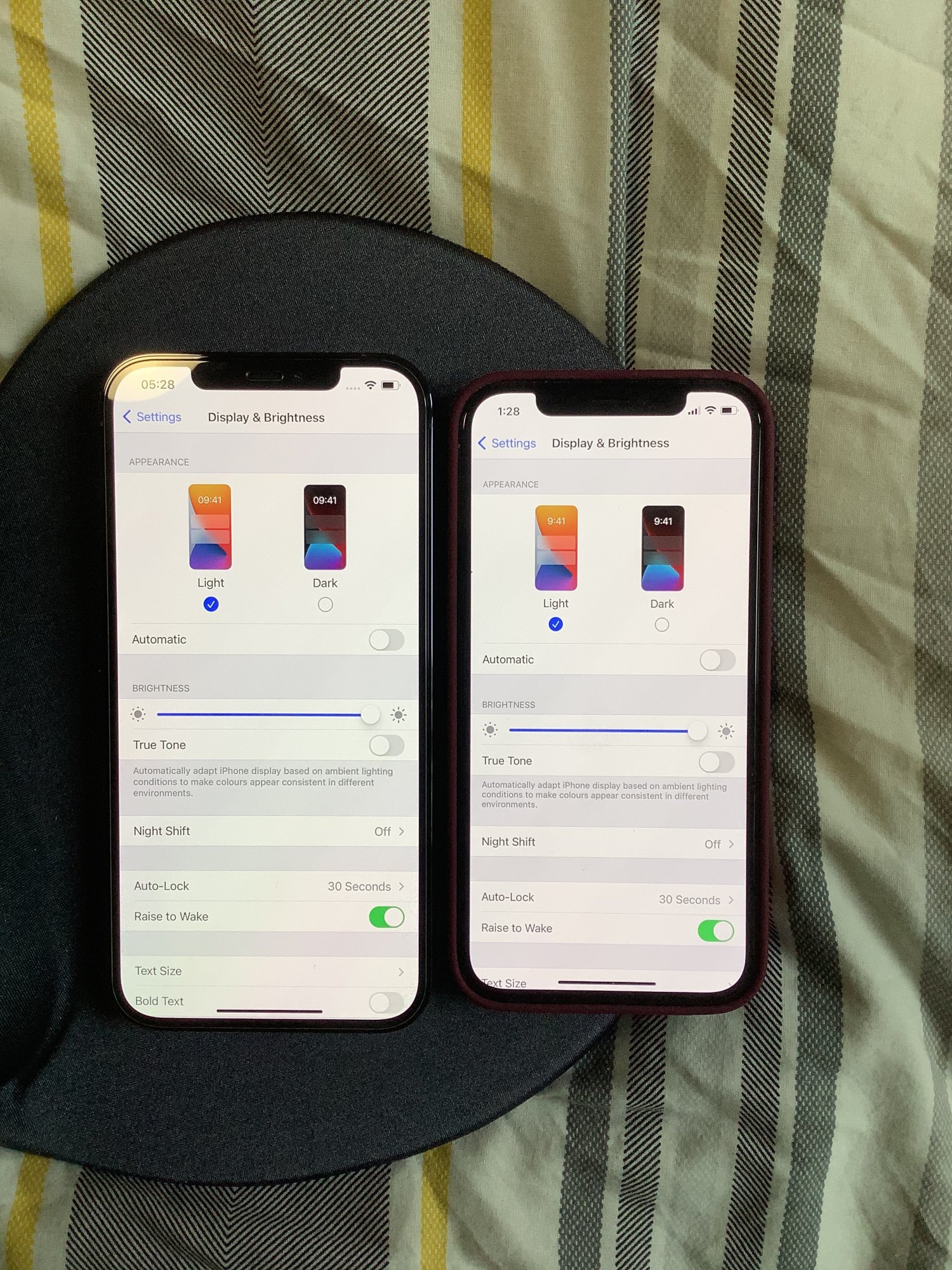

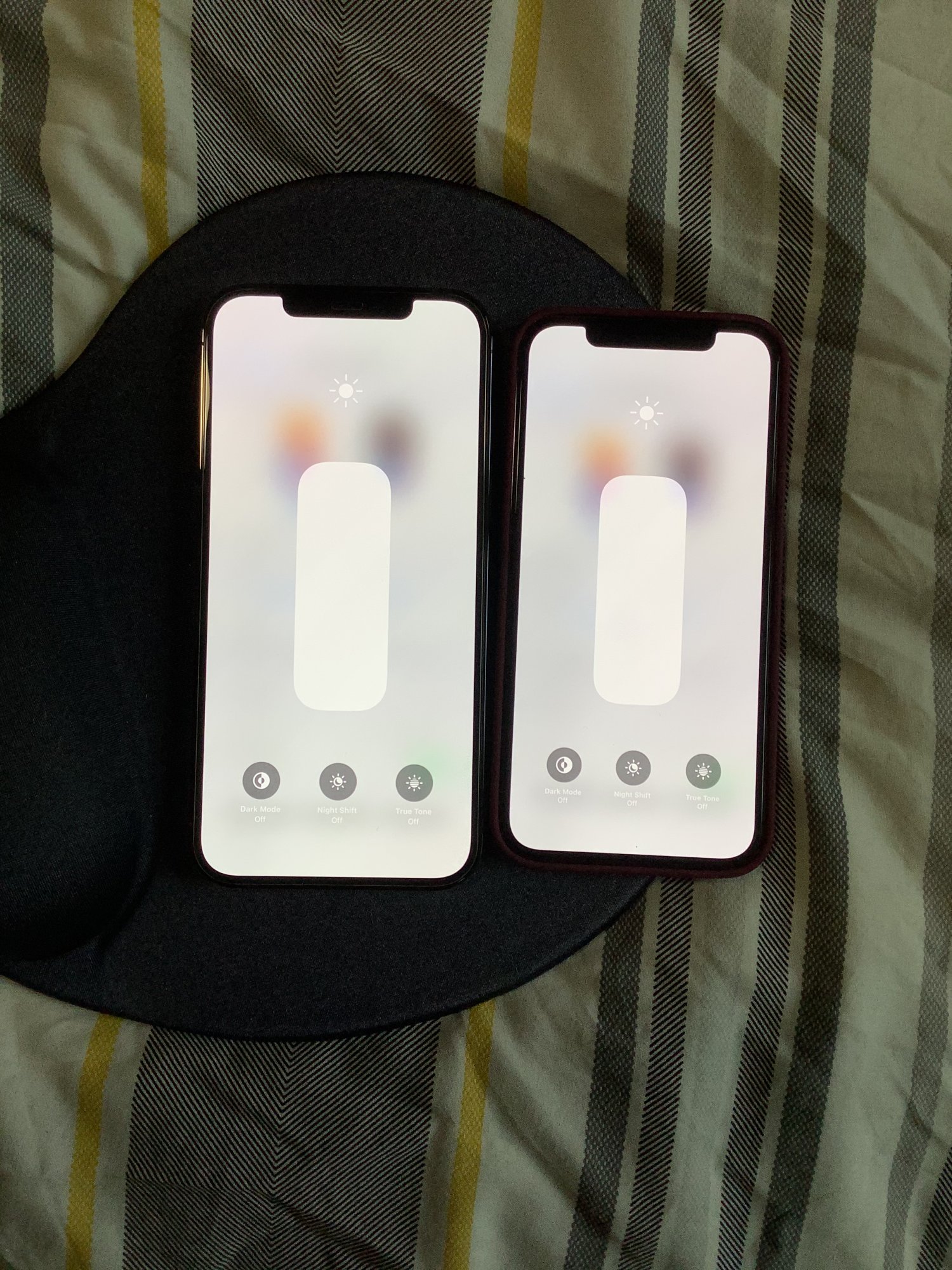

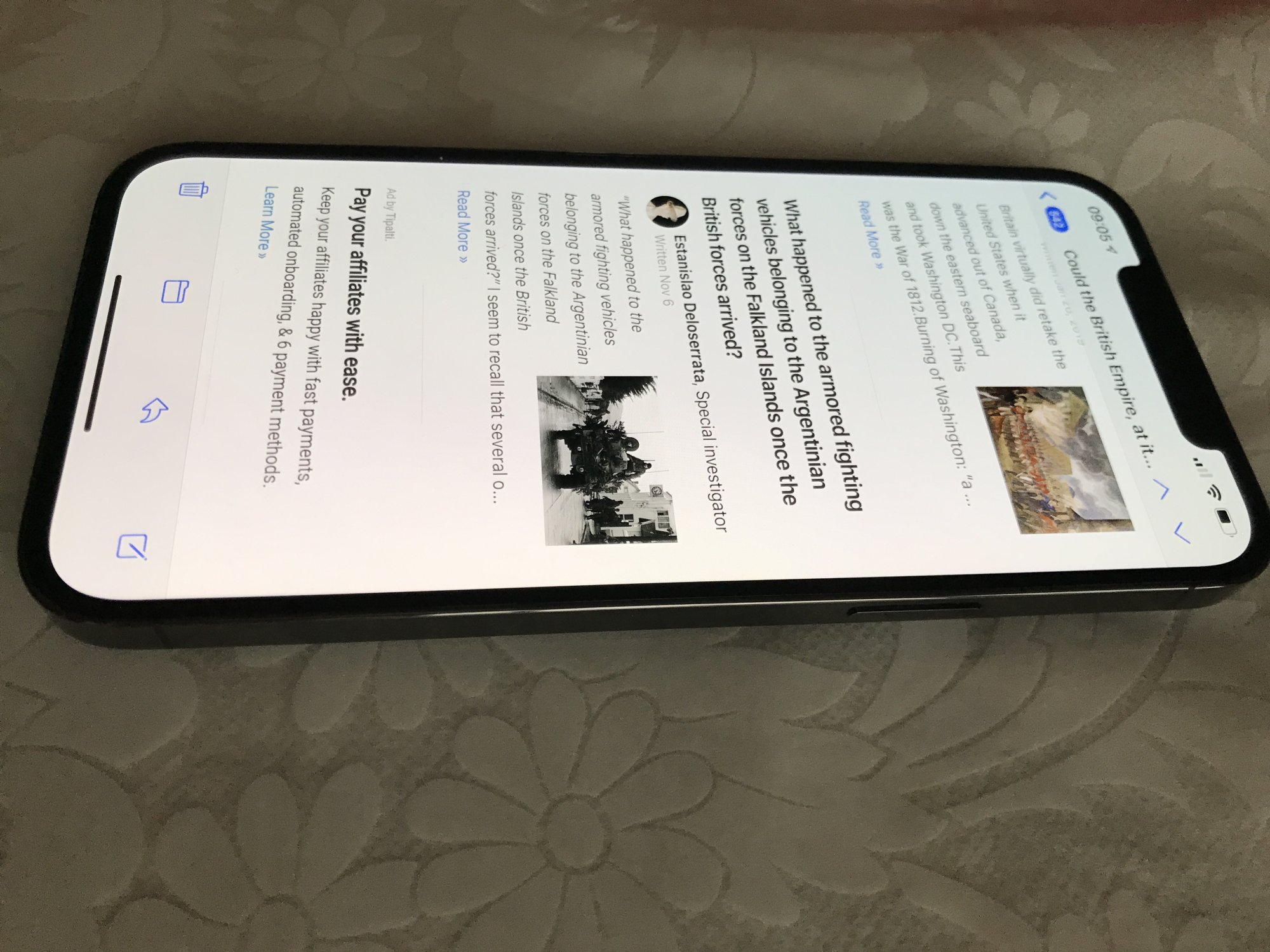

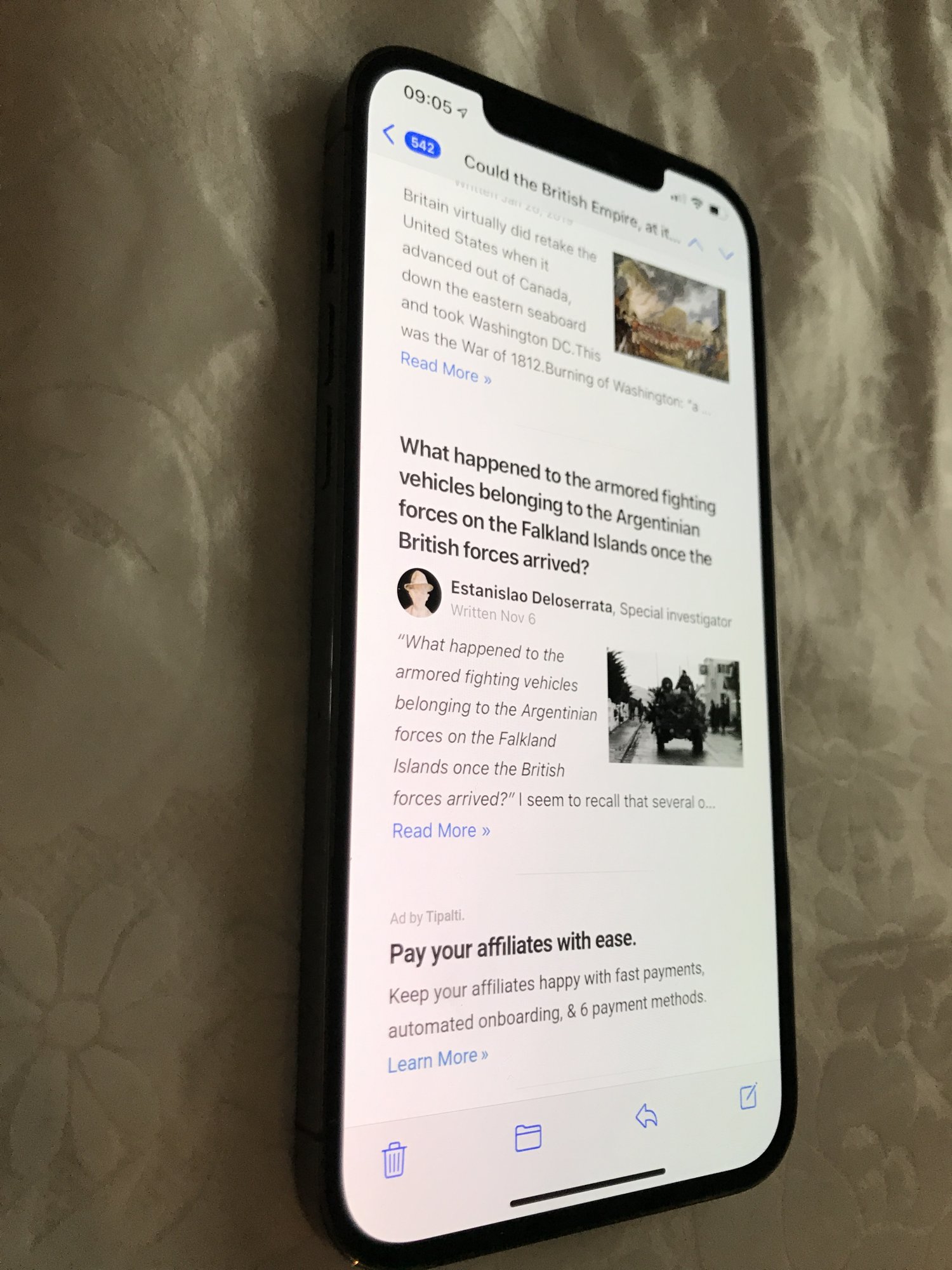

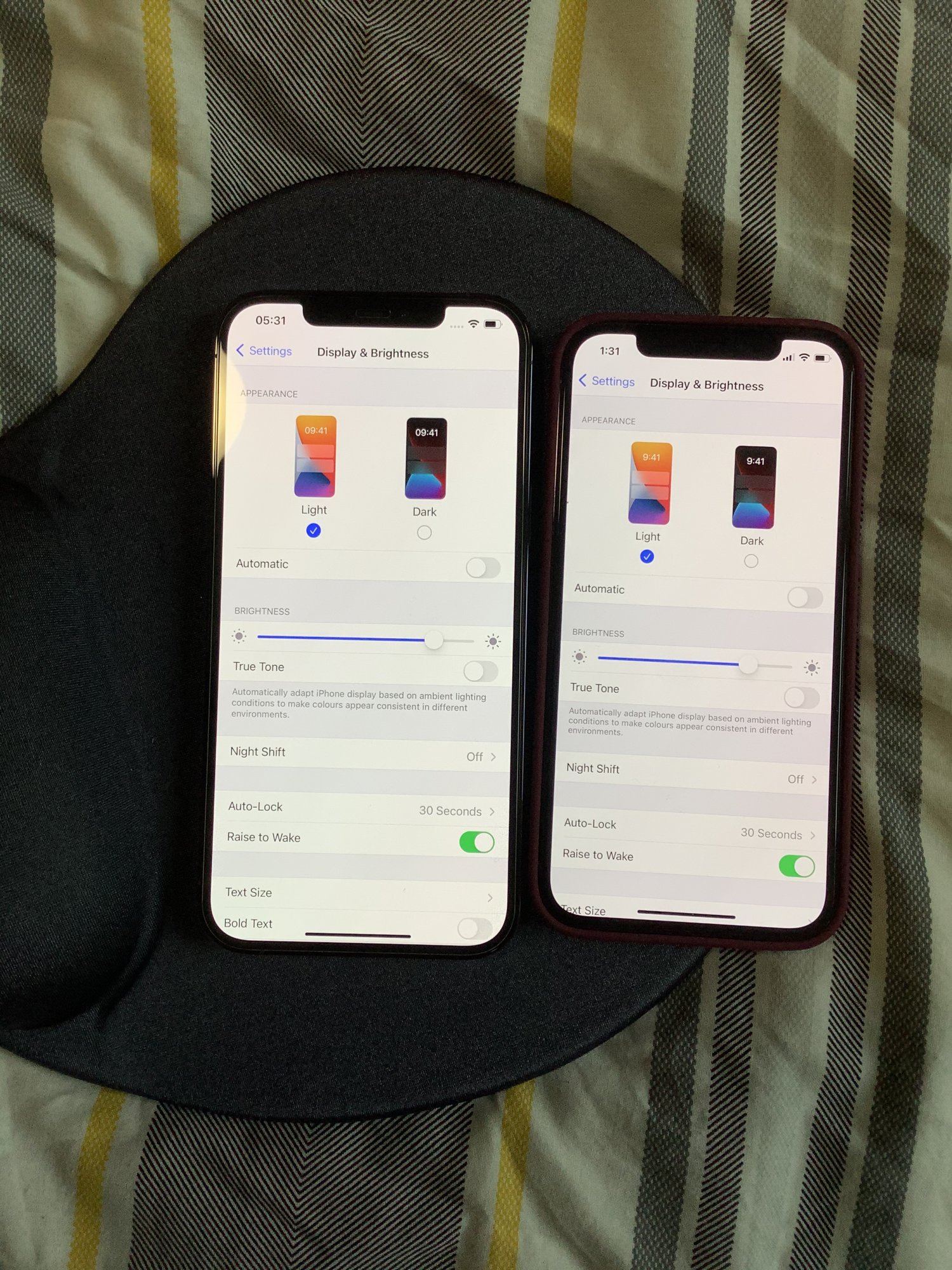

I haven't got my old 11 pro to compare it but here are pics of 12 pro max and 12 pro side by side. They both are keeper in my opinion and they look a lot better in person. Both have screen protector installed.

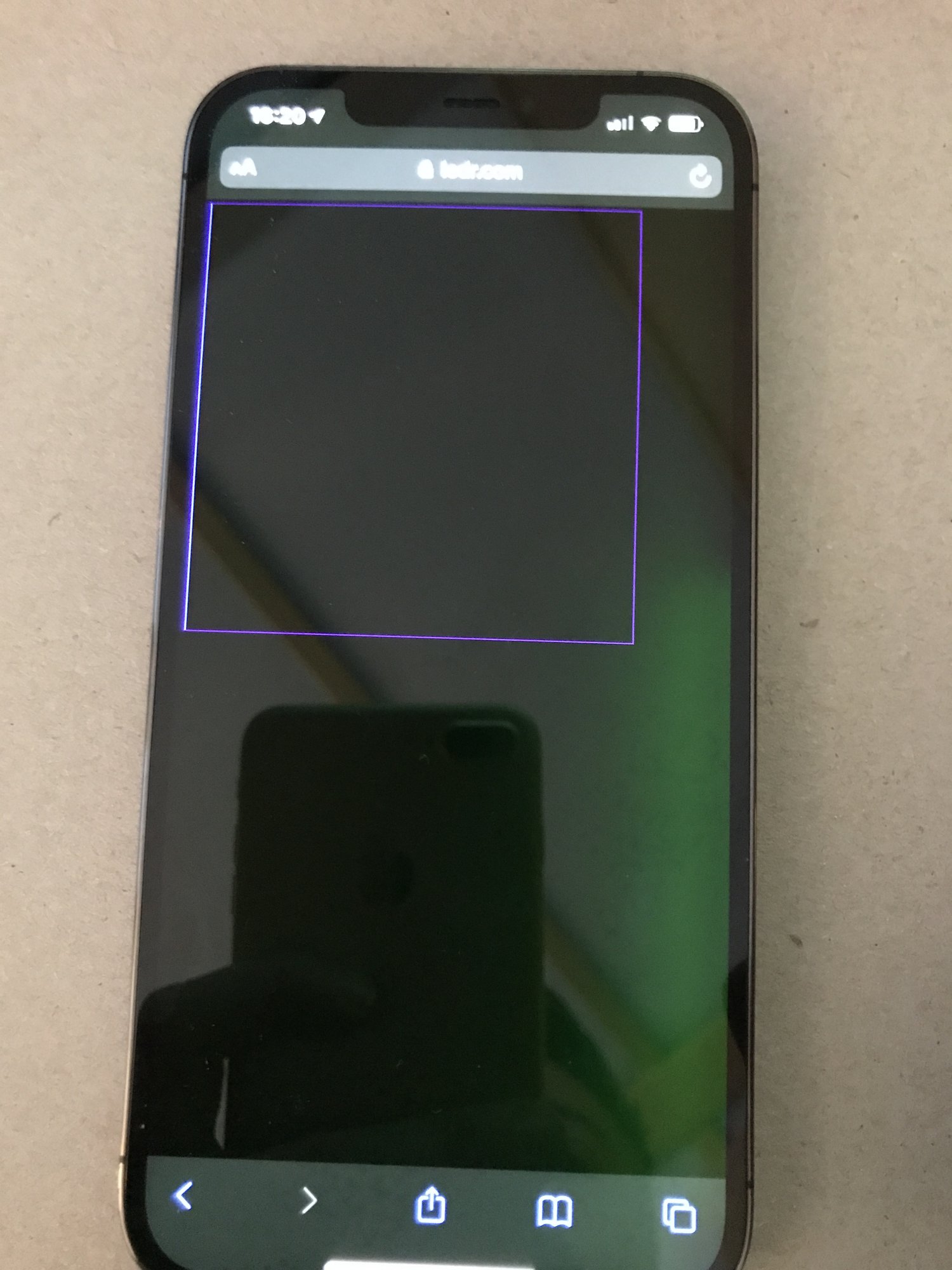

Hi, I’ve made an account because I’m facing problems with the iPhone 12 mini screen too. Yesterday I did send it back and I’m waiting for a replacement now. (I’m not having high hopes though, after reading this thread).
I’m a photographer so I ‘know’ colours and like some people already wrote here, I’m not all too worried about the yellow looking screen. I think too that my 7 looked too blue actually. And my iPad is on the ‘cool’ side as well.
But... my screen had a very green colour cast. When viewing photos the skin tones of people were greenish. And the whites were greenish as well. So this was unacceptable really.
Also the screen was dim and all colours were dull. Probably due to the green cast. The greys were greenish too and text was not black but grey. The mini i had, had the ‘raised blacks’ problem as well. It was also visible when switching on the phone while in a dark environment. The screen with the Apple logo flickered from grey to pure black.
I noticed too, when switching on the phone that at first the Apple logo was very bright and white and after a few seconds the Apple logo got greenish white. I’m wondering if more people noticed that?
Anyway, it’s disappointing that my 7 has a better looking screen.
Also, I have tried the colour filter. It improved a lot, but the screen got less bright immediately. And I never got whites without a pink, green, bleu or yellow tint. So that’s not a real fix, like many others here already wrote.
It’s so disappointing, because I really loved the mini! But a green colour on the screen is just unacceptable for me. So I hope there will come a solution. My iPhone 7 is not so great anymore after all those years!

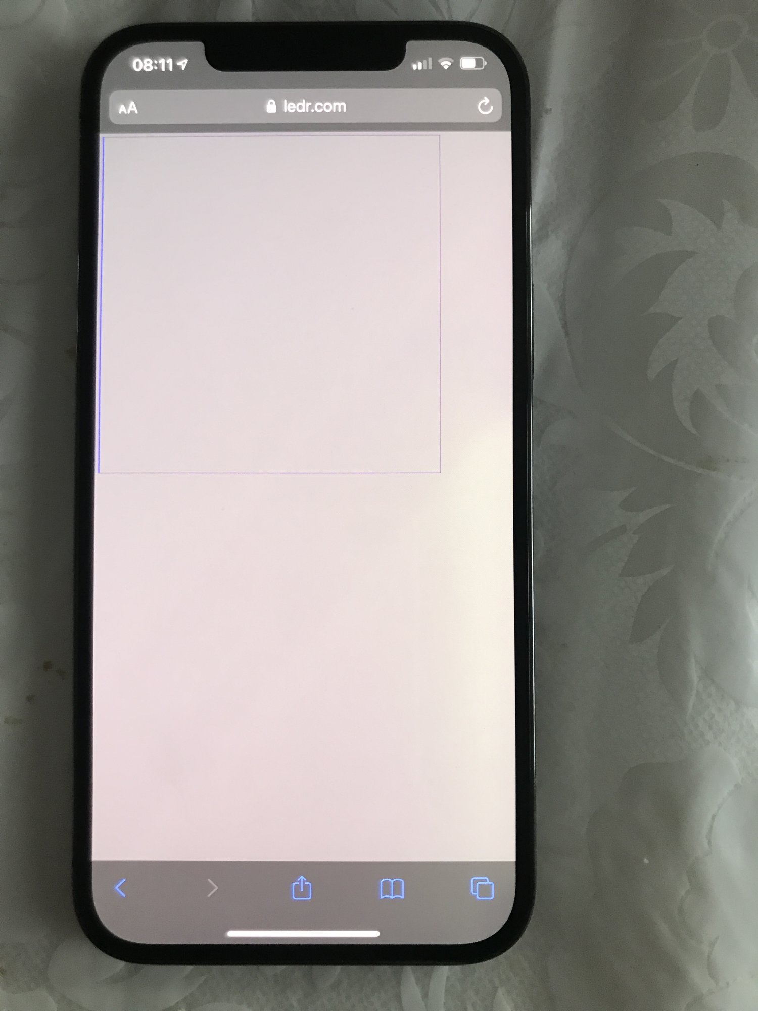

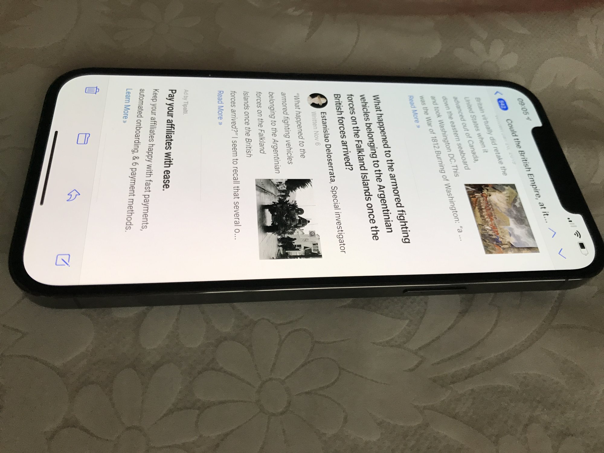

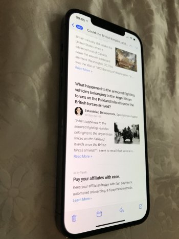

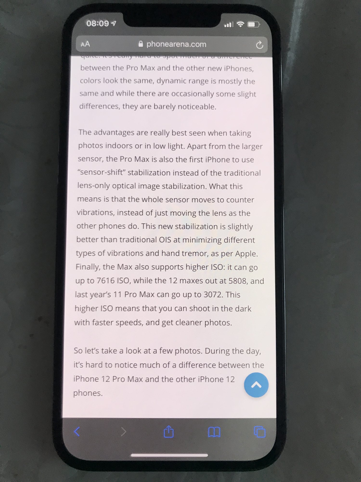

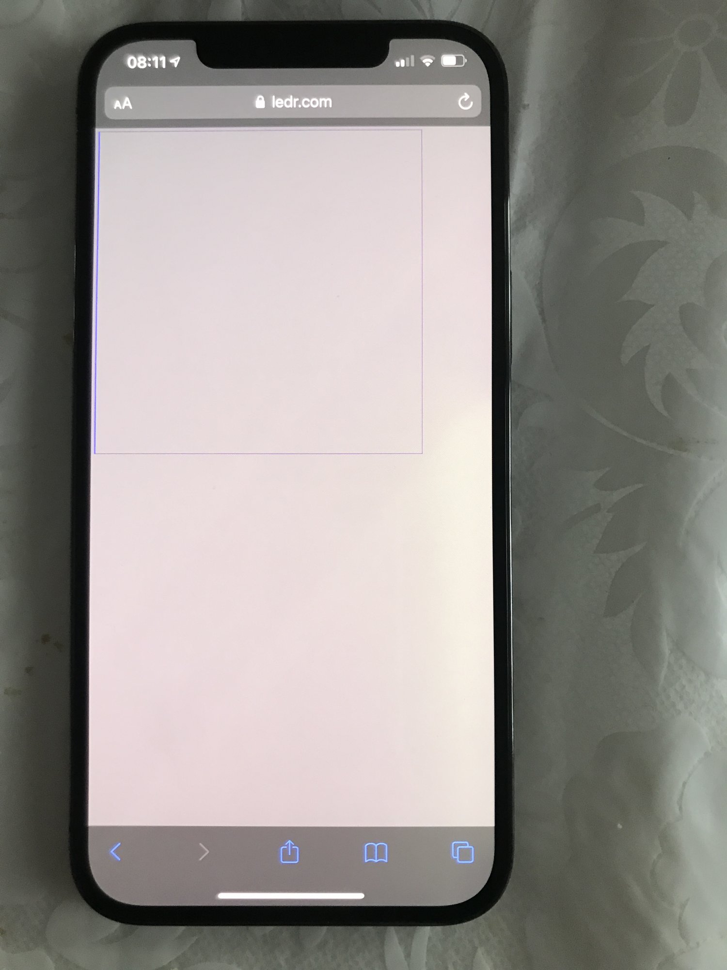

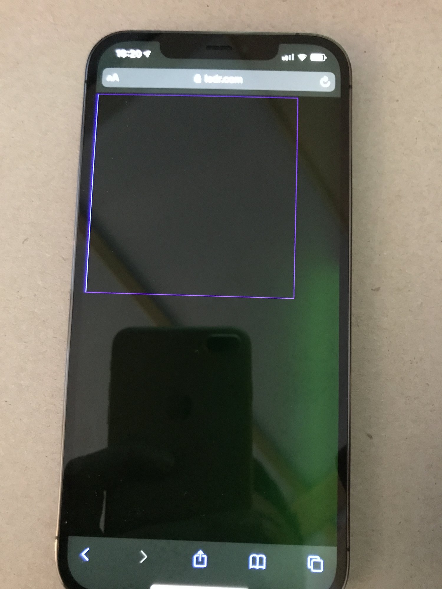

Signed up just so that I can post this.
iPhone 12 Pro Max arrived last Friday. Immediately transferred across from my 7 plus. Set up nice and easy. I've held off 4 years to upgrade, as was waiting for the right model, and with the camera's on this thing it felt like the time was right.
Having read previews, all the raving reviews etc over the last couple of months I was really excited to start using this thing. Honestly have to say, I am really disappointed with the whole thing. Firstly for me, the curved edges of my 7 plus make it nice and comfy to hold, and possible to use with one hand. This new phone is definitely painful to hold, these new straight edges are not for me. That aside... I am here to add my details about the screen quality.
The screen, far from being "the brightest that Apple has ever produced" is way dimmer than my 7 plus. Next to each other the 12 pro max is YELLOW. 7 plus is nice and bright, with clean whites. This new phone looks like crap in comparison. Viewing angles are worse, if it tilt the 12, the yellowness disappears and the screen becomes whiter, but worse to read...
The worse thing is, when I have a black background, the whole right hand side of the screen has what I can only describe as LED Backlight Bleed??? So a whole band of green highlight all down the right hand side.
I have gone back and watched all the reviews that I watched before. Nobody complained about a poor screen? In fact everyone was raving about how amazing it is?
I find this hard to believe.
Utterly utterly disappointed, waited for 4 years for a new phone to be WORSE than my 2016 one!!!
