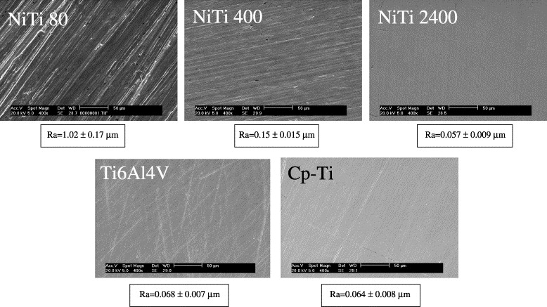

Now, if you were to look at a flat piece of metal under a microscope, you would see this:
See those valleys, dips, mountains?
Now notice the roughness average (known in the industry as RA) values.
The roughness average of a polished mirror finish is usually 3-5 microinches. That NiTi 80 has an RA of 1 micron (1 micron = ~39 microinches), and you see the valleys and mountains.
