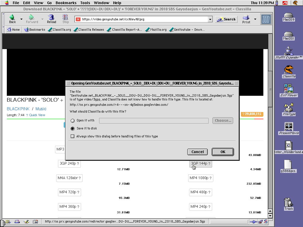

You can use Classilla to download the 3gp file from Youtube.
3GP 144p or 3GP 240p

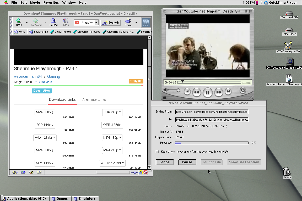

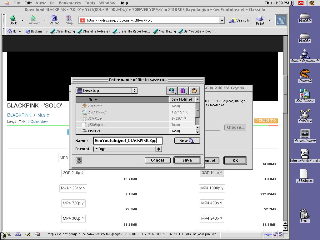

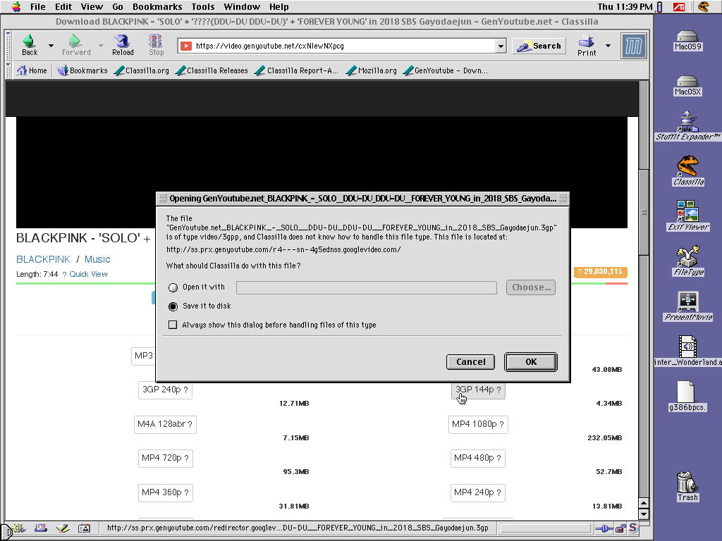

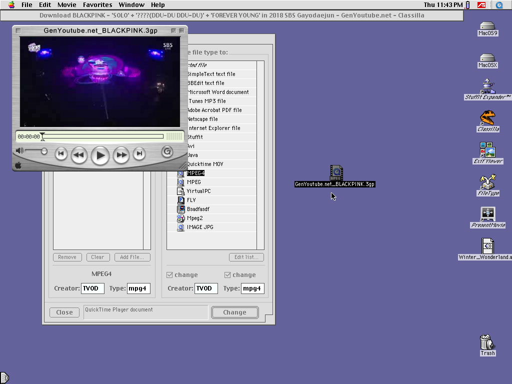

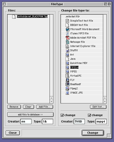

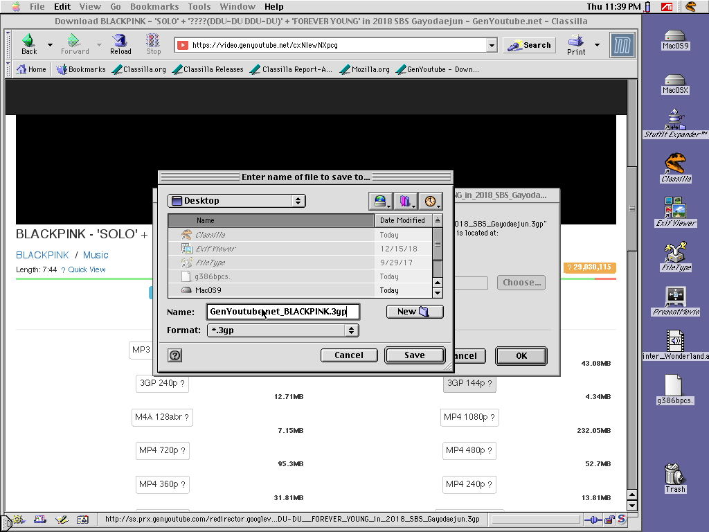

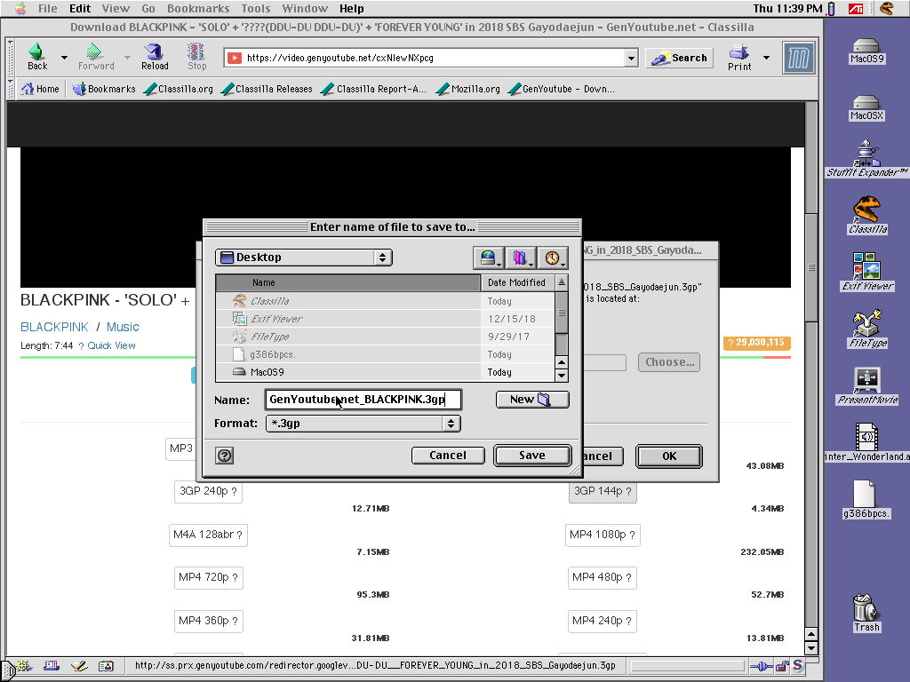

1:
download the videos from genyoutube.net (search for your video and the links are at the bottom)

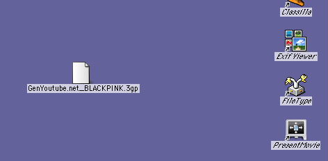

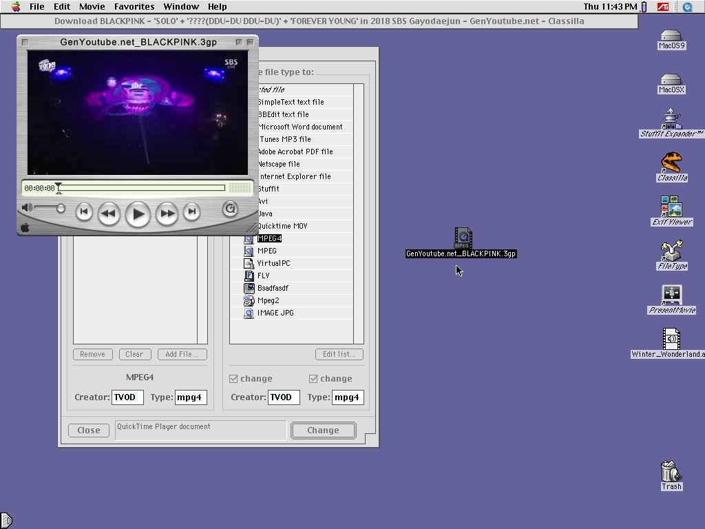

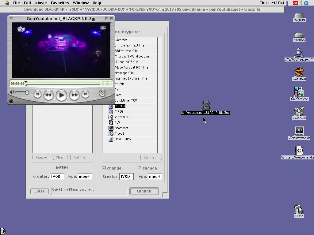

2:

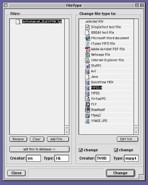

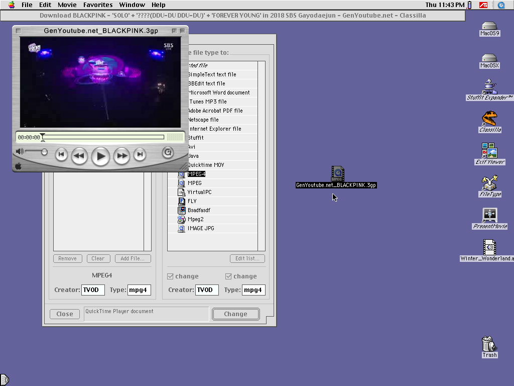

use FileType (version 1.0.1) to change the "creator" and "type"
Creator = TVOD
type = mpg4
**corrected file type**

1:
2:
Creator = TVOD
type = MPG4
Doesn't work for me - error box saying not a file QuickTime understands.
Also can take up to 10 minutes for the link to generate.

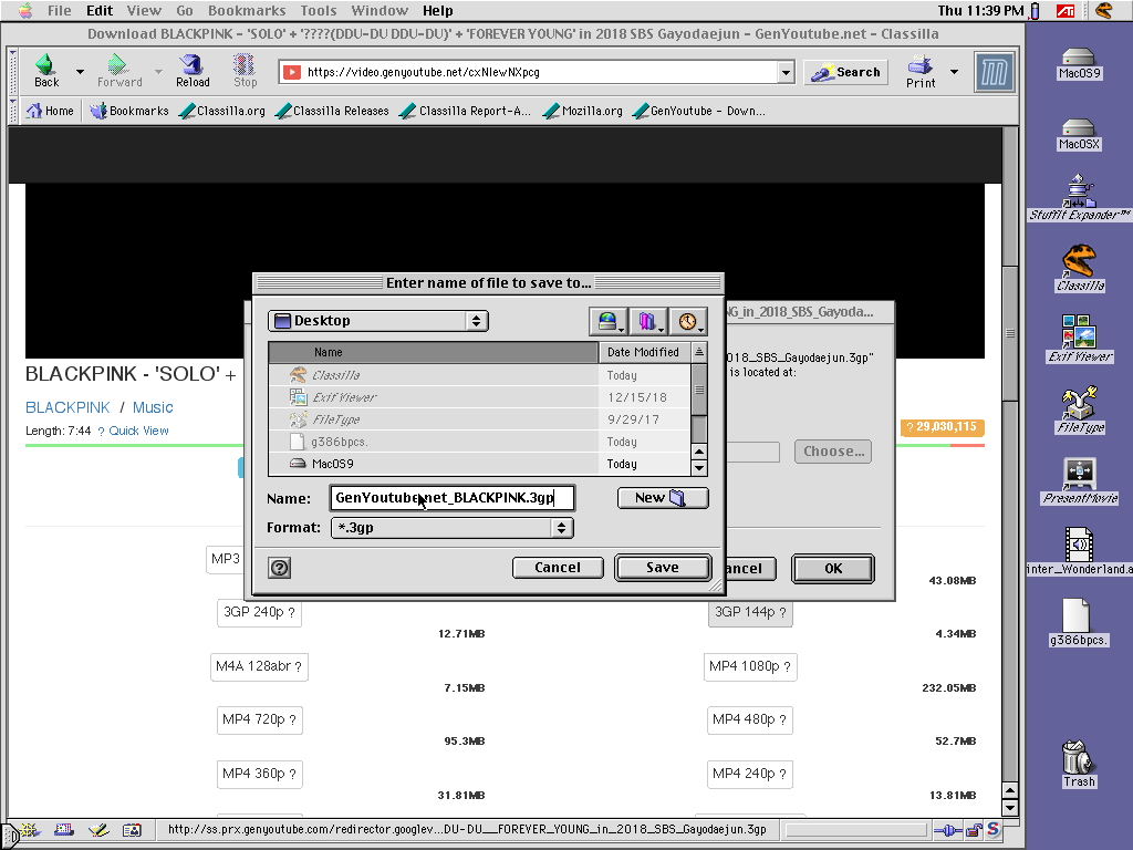

The MP4 files will not work only the 3GP files
I just right click and save linked file as no waiting
hope this helps

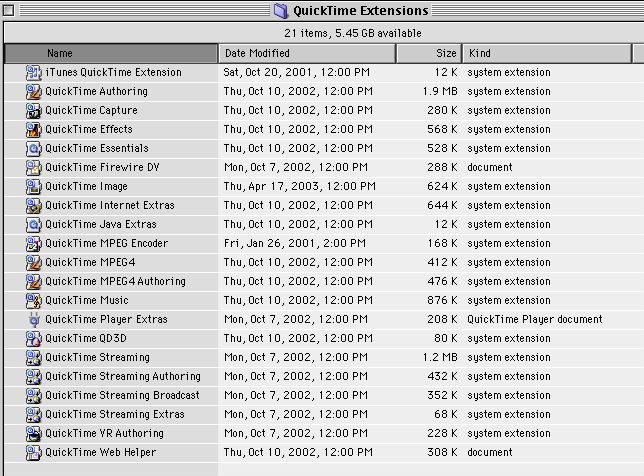

I can send screenshots later

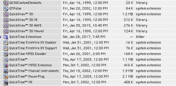

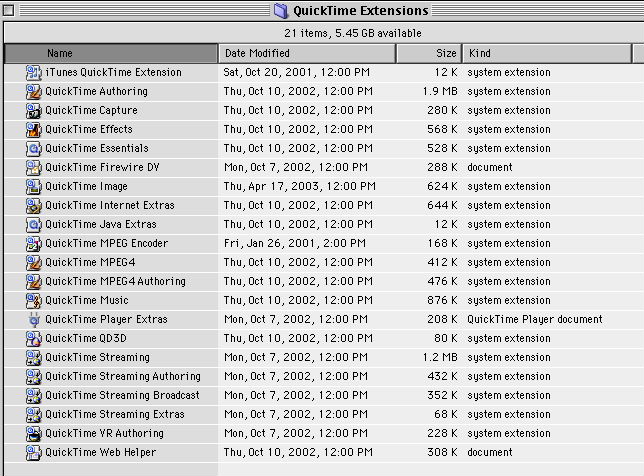

Known codecs
3ivx
Divx
Sorenson
Cornica SensePack
I will check which codecs I have for Quicktime
Reactions: Dronecatcher

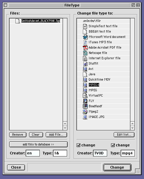

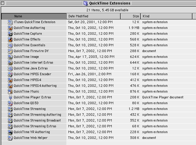

Screenshots

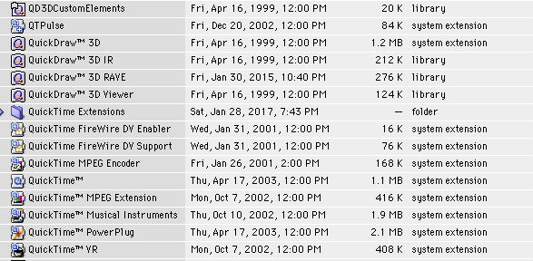

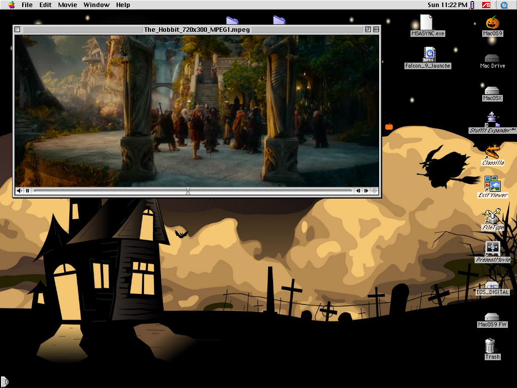

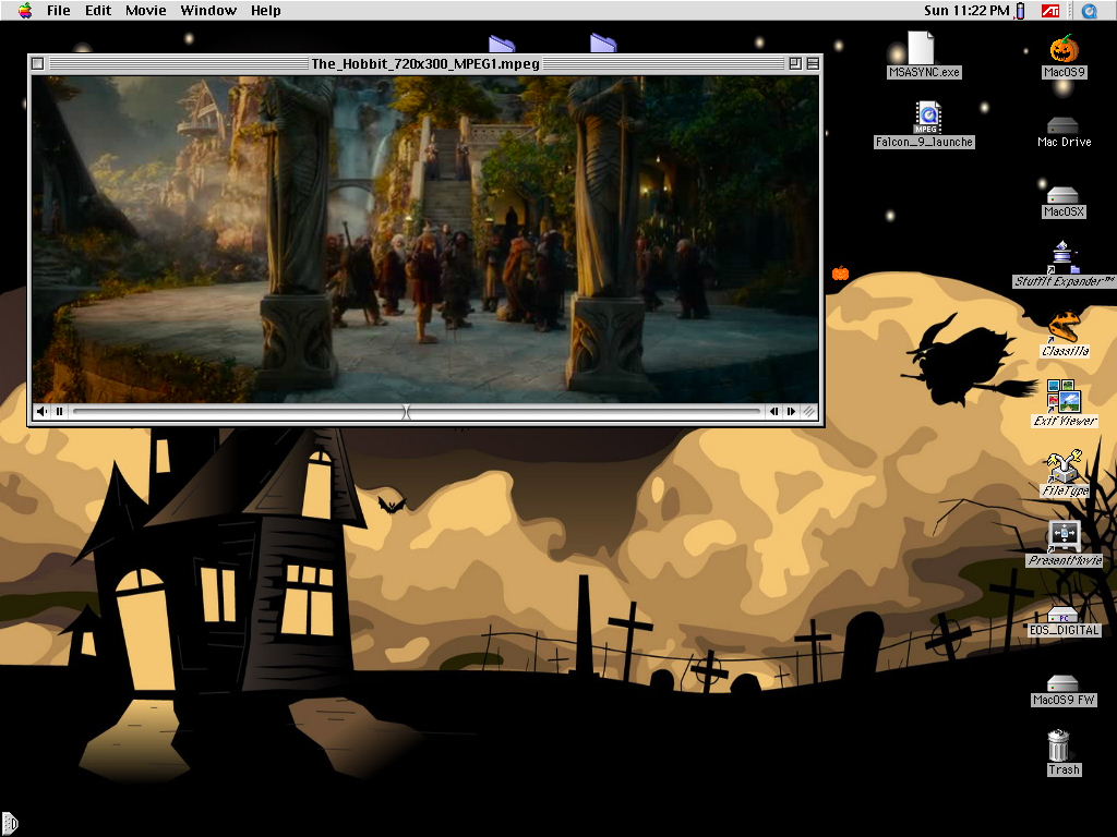

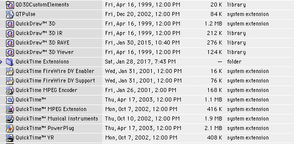

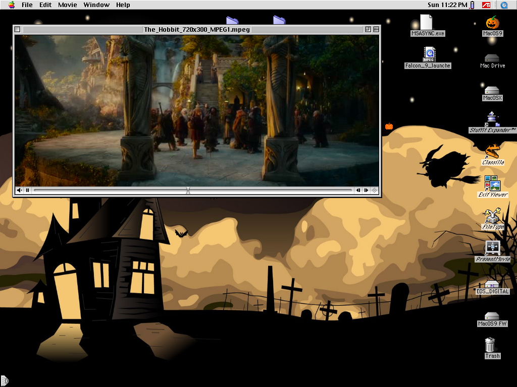

[doublepost=1546585708][/doublepost]Here is the Pismo playing a 700x300 MPEG-1 file.
I have all the extension you have apart from QuickTime MPEG Encoder.
I'm using QuickTime Pro 6.0.3 with the 6.1 Extras pack plus the Cornica pack, 3ivx and Divx packages.
Any idea where your extra extension came from - I suspect that's what's making the 3gp files reachable?
Got it!
Your original instruction to change file type to MPG4 I'd left in place but as your screenshot shows, it has to be lowercase, mpg4 - now it works!
This is incredible - QuickTime 6 comes with codec support for 3gp but Apple deliberately obscured it!

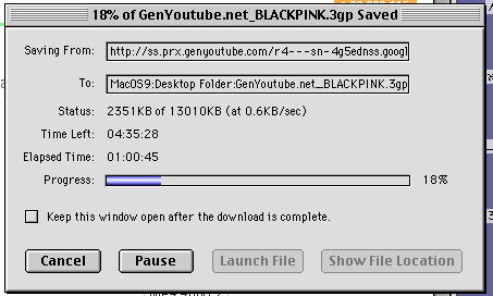

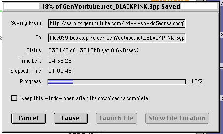

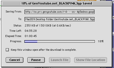

However, the genyoutube site is hardly reliable - sometimes the download starts within a few seconds, other times it errors out waiting and fails - I see on your screenshot the download is at 18% after 1 hour!
I'm going to have to resign this to a proof of concept as I'm having no luck getting videos from genyoutube.
