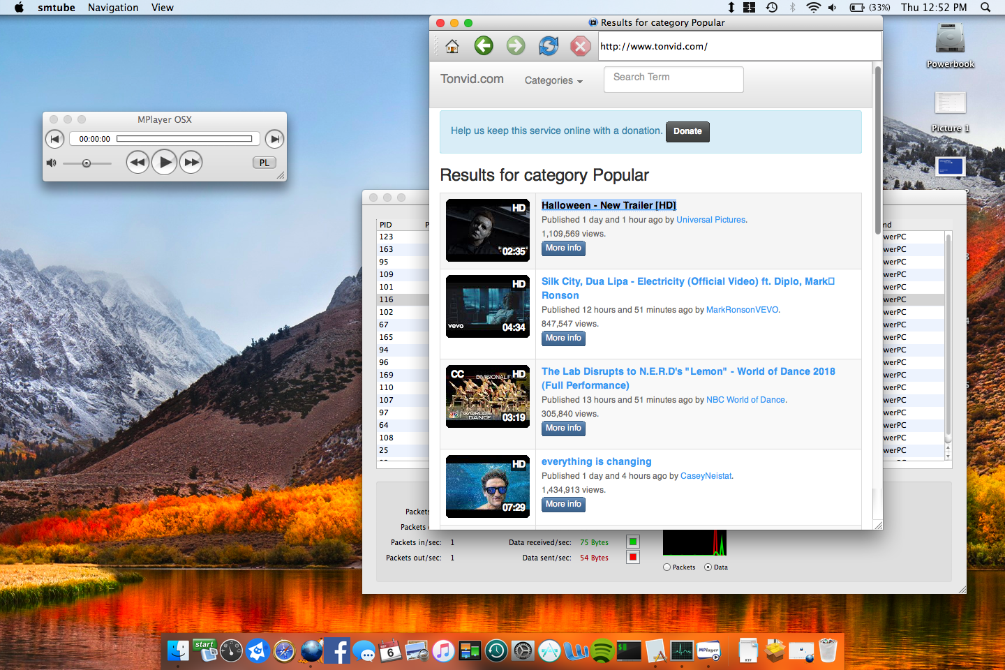

I finally got around to setting this up today, but I haven't been able to get it to work. When I right-click a video from TonVid in SMTube, and click "Open with MPlayer", Mplayer opens, but never starts to stream. Clicking play does nothing. Is there a step here that I'm missing or a log somewhere I can check to see what is happening?
Close all apps.
Can you open Applications/Utilities/Console.
On the left-hand side , under Log Database Queries, select All Messages.
On the toolbar, click on "Clear Display"
Next start up SMTube, try to playback a video with Mplayer , and close SMTube.
Now go back to Console , there should be plenty of messages
Click File , Save a copy as (make sure it shows All Messages) ,save it and attach it here
Last but not least , go to /Applications/Utilities/Terminal
Type ls -ltr ~/.config/smplayer/ , paste the output here and
type ls -ltr ~/.config/smtube/ and paste the output here
Lastic, it is way easier than that. He installed the wrong version of mplayer, an old one instead of the one you provided.
Thank you both for the speedy reply! I'm not sure what version I should be using? I grabbed mplayer from the dropbox link in the first post. The file is "MPlayer-1.3.0_3_OSX_Tiger.mpkg". Is there a newer link I'm missing?
[doublepost=1536255471][/doublepost]Nevermind that last question! I didn't remember installing MPlayer before so I didn't realize the version I had in Applications wasn't the version I just installed! Found the correct one in /opt/local/bin and working great!
Thanks a bushel for the help @pochopsp and @Lastic !
