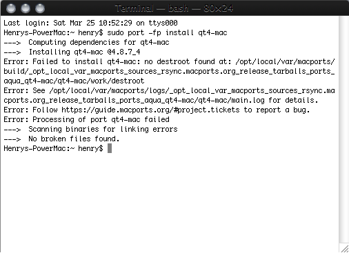

Might be worthwhile to check also the log if it fails again but can you try sudo port -fp install qt4-mac
[doublepost=1490455780][/doublepost]and can you tell me what port version and port installed show, only thing that is different from my setup is that it's trying to install qt4-mac 4.8.7_4 whereas I have qt4-mac 4.8.7_2 installed via macports , what does port list qt4-mac show ?

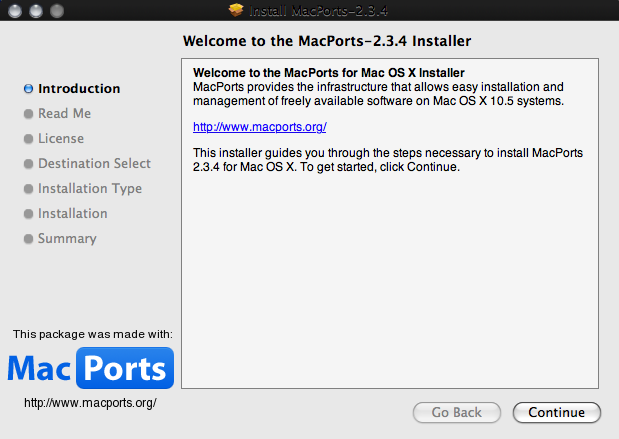

Already found the issue , your Macports version is 2.4.1 not 2.3.4 as linked on the 1st page .
Looks like either Macports proposed to update itself or you have installed a newer version ?

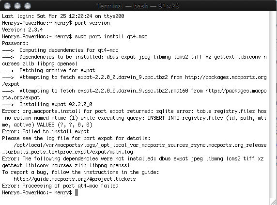

I downloaded the version linked on the first page. I'll just have to search for 2.3.4.
EDIT:
This is exactly what I've already installed. Maybe I should just install it again?
EDIT 2: After installing again, the version shows as 2.3.4! Now I'll try installing qt4 again.
EDIT 3: Still fails. :(
Yes, I uninstalled MacPorts using the command you linked and then reinstalled.

Strange because the download link is for Macports 2.3.4 , I've tried the link 3 times today ?
It could be that Macports updates to the most recent OS X 10.5 version but I told it not to.
I need the qemu version that is in the ports repository on Macports 2.3.4 so I stuck with it.
Maybe pochopsp installed Macports 2.3.4 , installed qt4-mac and then Macports updated itself ?

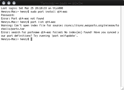

Tried on my iBook G4, still says not found. Port list qt4-mac:
Something is wrong with your Macports , it cannot find it's repositories .
Have you tried the suggestion : port selfupdate ?

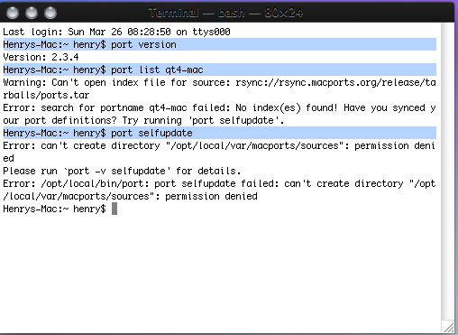

Strange as I have this problem on 2 different Macs. The command is an error, I can show it to you if you want.
[doublepost=1490537505][/doublepost]I just need a different way to install qt4
I will need indeed a screenshot or more info since I'm blind otherwise to what is happening.
A few troubleshooting commands which might indicate me what is happening :
port version ( to know which version you are using since you're doing the install on different machines )
port list qt4-mac
( to know wether Macports can reach it's repositories and the port is found )
port selfupdate
( will update the repository list via network )
The previous screenshot shows that it cannot connect via the network to it's repositories using rsync, does your iBook have a functioning network connection ?

[doublepost=1490538563][/doublepost]@Lastic I appreciate you looking into this.
I think the main problem is that we have to smooth out the install process. Really all that needs to be installed is qt4, however that needs Macports and Macports needs Xcode. If we can find a way to install qt4 without Macports and then combine it and smtube into an installer, more people would use this.
OK, try sudo port selfupdate
