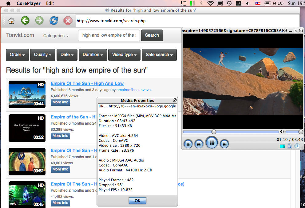

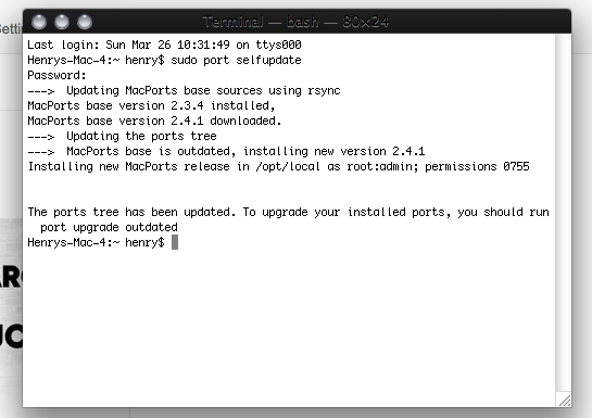

I'm on my G5 now, but the exact same results are happening, I tested it. Did a sudo port selfupdate, it appears to be updating to 2.4.1 now.

With 2.4.1 qt4 is now installing, as well as the dependencies. Now time to try on my iBook!
EDIT: iBook appears to be able to update to 2.4.1 as well. Thank you @Lastic!

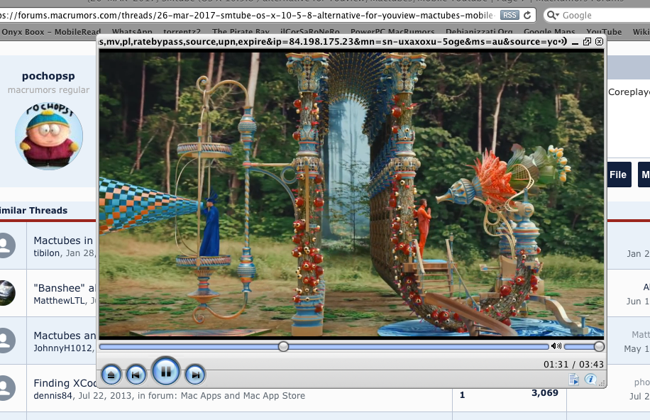

I keep having problems with this particular video. I click on it, coreplayer opens, but it won't load the video.

I did the same ,used SMTube, opened with VLC, Window, Media Information, copied the addres at the bottom
(Location)
{Removed link since it has my public IP in IT}
Opened Coreplayer, Open URL, copied the above URL and it plays.
Can you try to copy the above link and Open URL it in Coreplayer ?

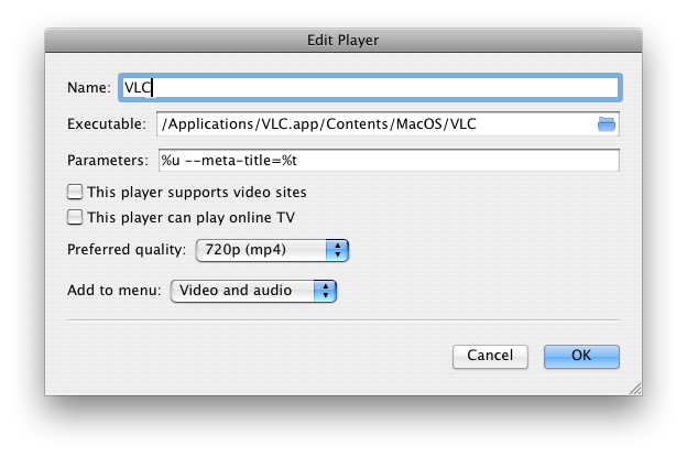

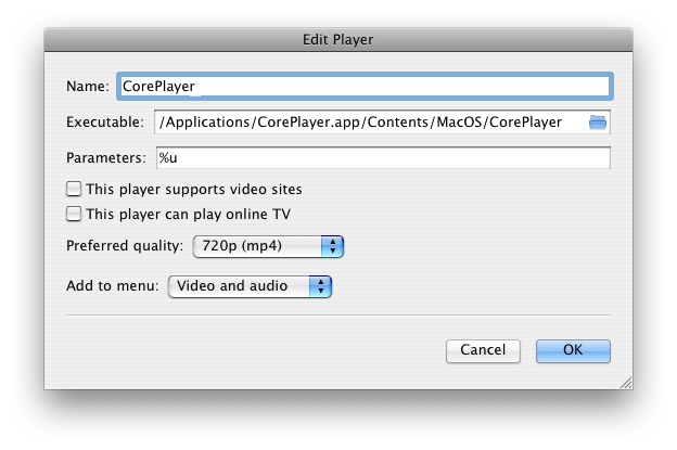

What are your SMTube, Preferences, Player, Coreplayer settings ?
Are both This player ... unchecked ?

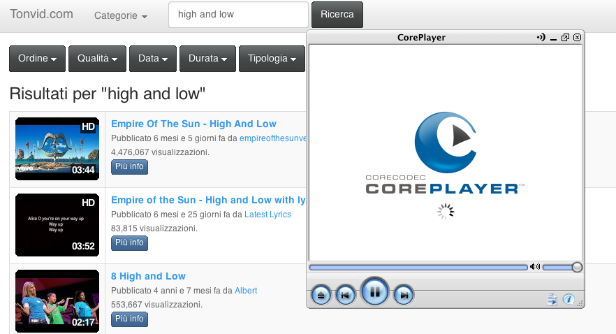

I've clicked on the first one. Coreplayer keeps spinning but the video won't start. Maybe a regional issue? Maybe an issue with my router? (I have problems in connecting with games on GameRanger too on my PowerMac)

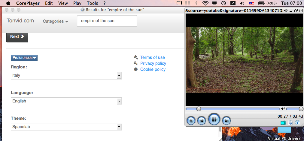

On the bottom of the SMTube screen , you can change your region in the Preferences settings.
I changed mine to Italy but for me it still works like when it's on my own region.

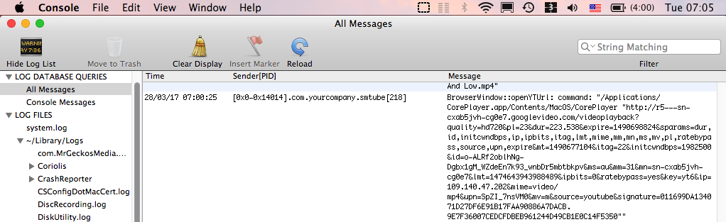

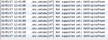

In the Applications, Utilties folder , You will find Console.
If you open this , select All Messages, you can filter/find all smtube logging and check what it is

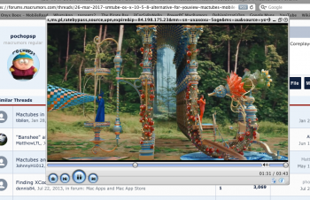

No, changing the region didn't help.
I made screenshots for both working video and not working video console messages
  • working video.zip
  • NOT working wideo.zip

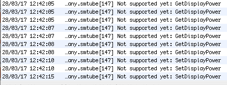

Console is generating an insane amount of log data using SMTube - is that normal? Using PPC Media Center or my custom player generates just one single line of data.
