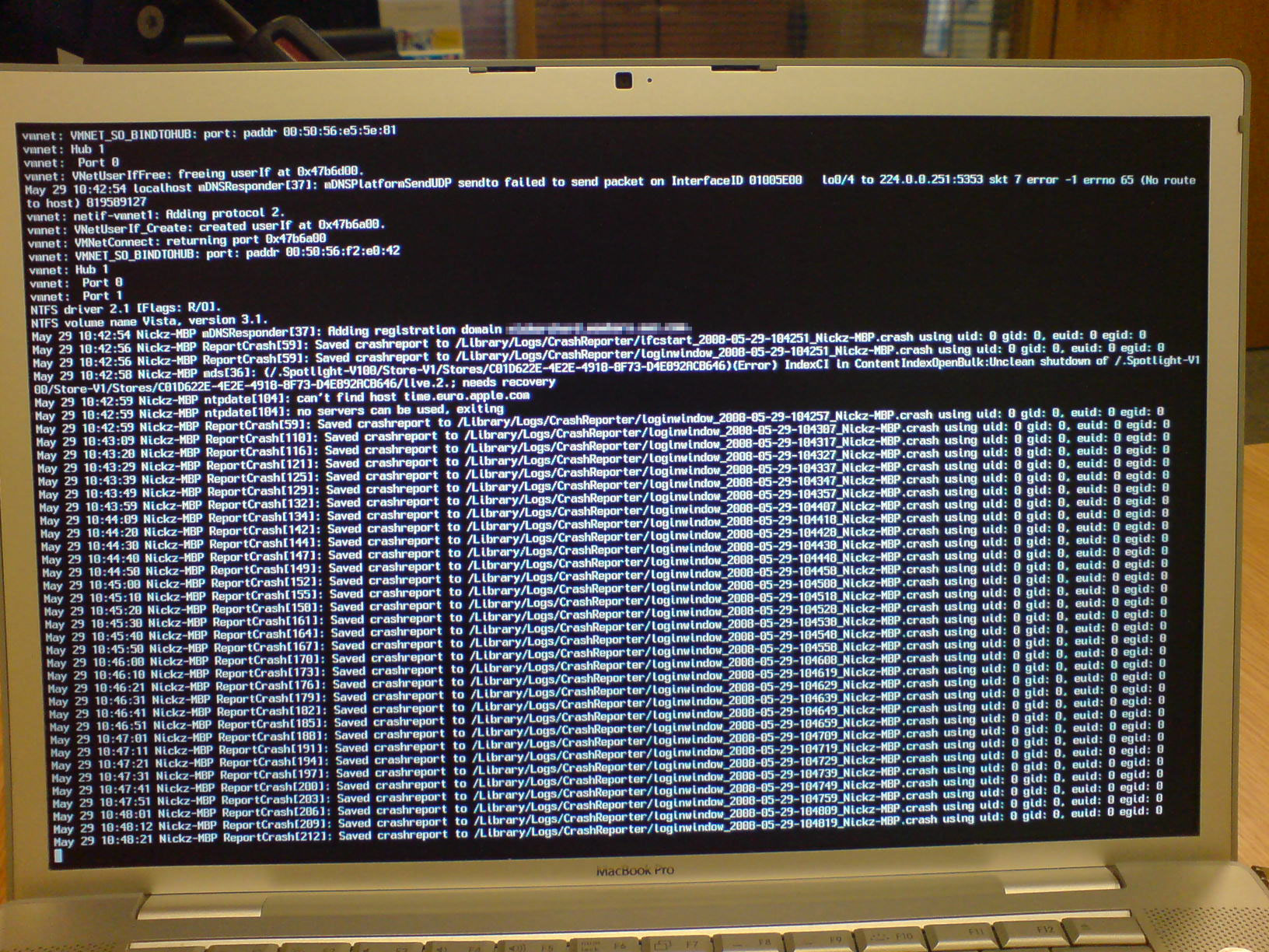

My Mac won't boot after the 420MB update 🙁 Just sits at the gray Apple boot screen with the spinning progress bar thingy. Left it for four hours last night doing that. I can hear my hard drive doing all sorts of things but it just wont boot. 😕

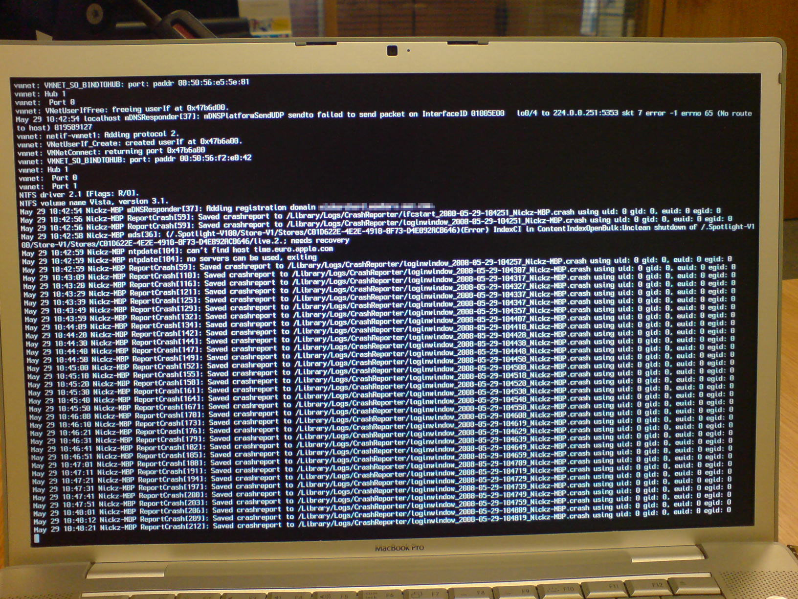

OK an update. I've booted into Single-User mode and run FSCK from the command line. It found some errors and successfully repaired them. However, my Mac still won't boot. It seems to be stuck continually writing crash logs to disk. I took a photo, hopefully its clear enough for you to see.

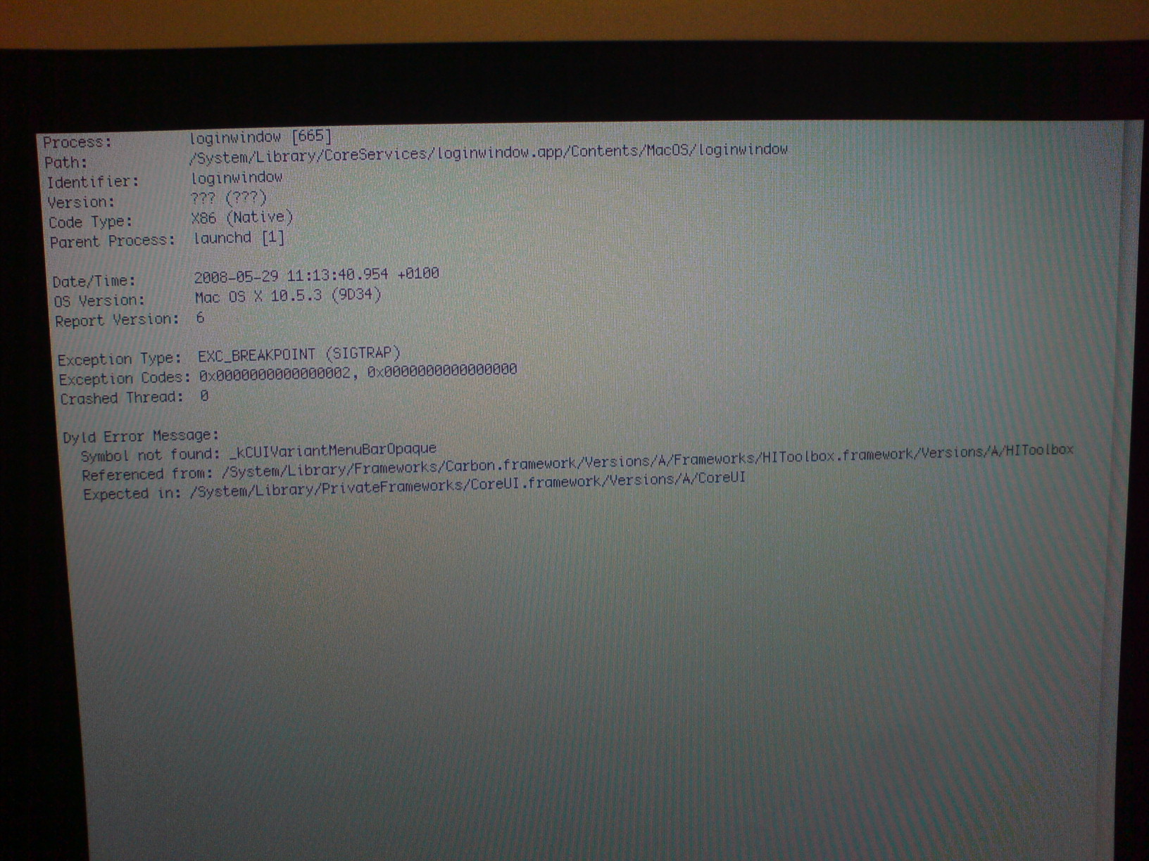

[EDIT] Managed to find out what the crash log says.
Sorry, I dont know how to help, but can I ask if your computer came with Leopard or if you upgraded to it from a previous version of OS X?

Shipped with Tiger. I clean-installed Leopard. 10.5, 10.5.1 and 10.5.2 all worked fine.
Hmmm... I think problems like yours may only be on computers that were updated to Leopard... I may be wrong, but that is a pattern I am seeing.
Good luck with fixing it, hope all goes well.
Well I've just done an Archive/Install of 10.5. Will update using the combo updater after it downloads.
