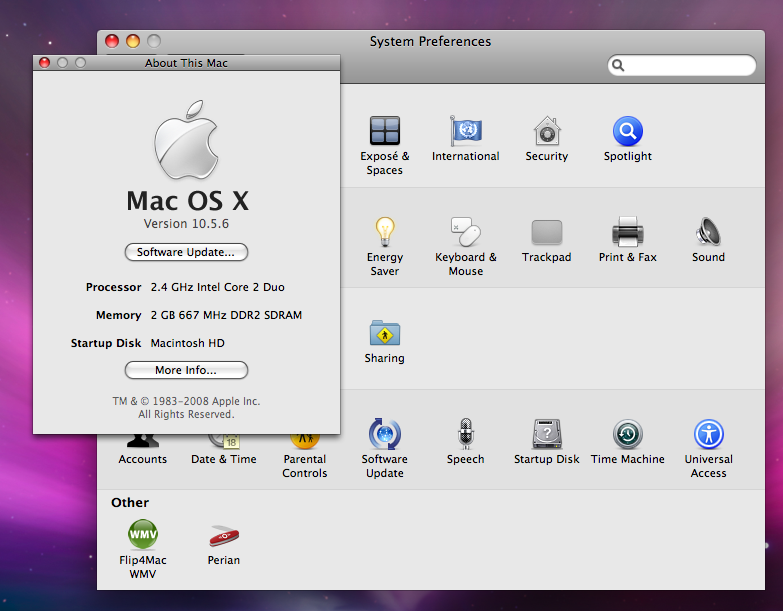

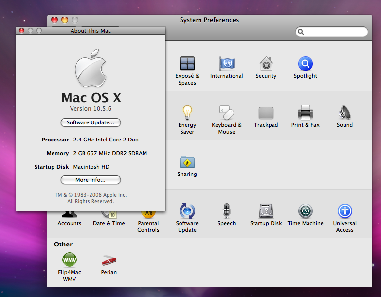

Actually it is fluorescent now in contrast to incandescent as it used to be. 🙂
10.5.6 update did not change the icon for me. I've only seen this icon on a Unibody Macbook personally. I don't think this update changes the icon to the new one used on the new Macbooks.

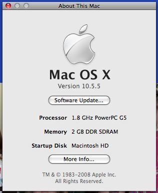

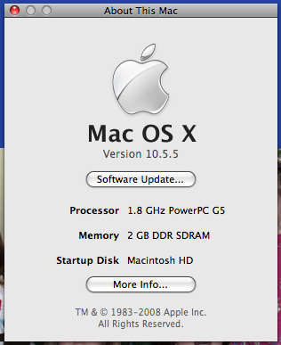

10.5.6 Not Installing
It sorta goes through the install process then I get a message saying there was an error.
Any suggestions?
tia, Bob
