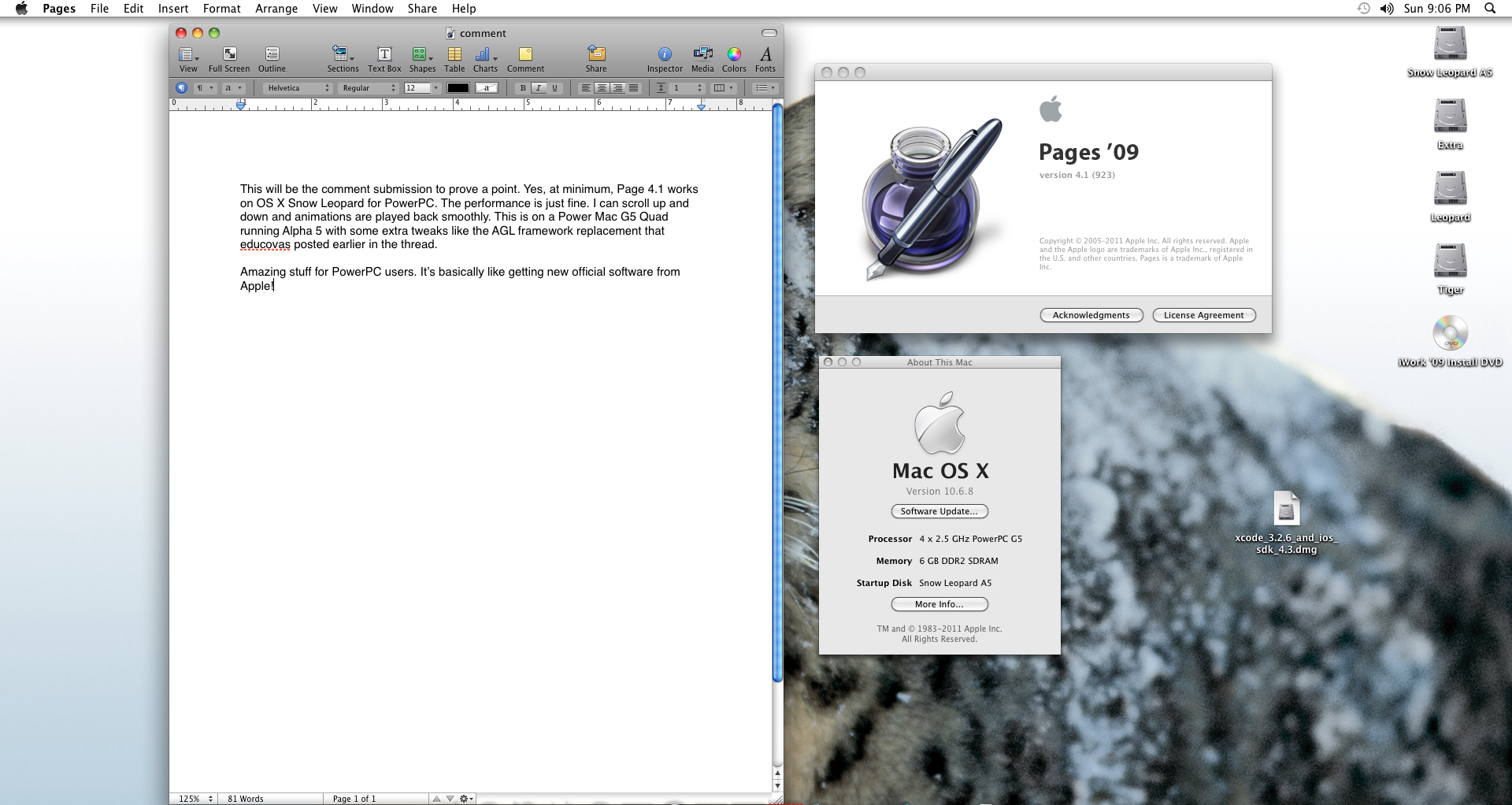

Just to make sure, do they actually work? I recall installation was fine on 10a190, but apps did not launch.
To be clear, "at minimum" just means that you can only see Pages working in this screenshot. Keynote and Numbers work well too.

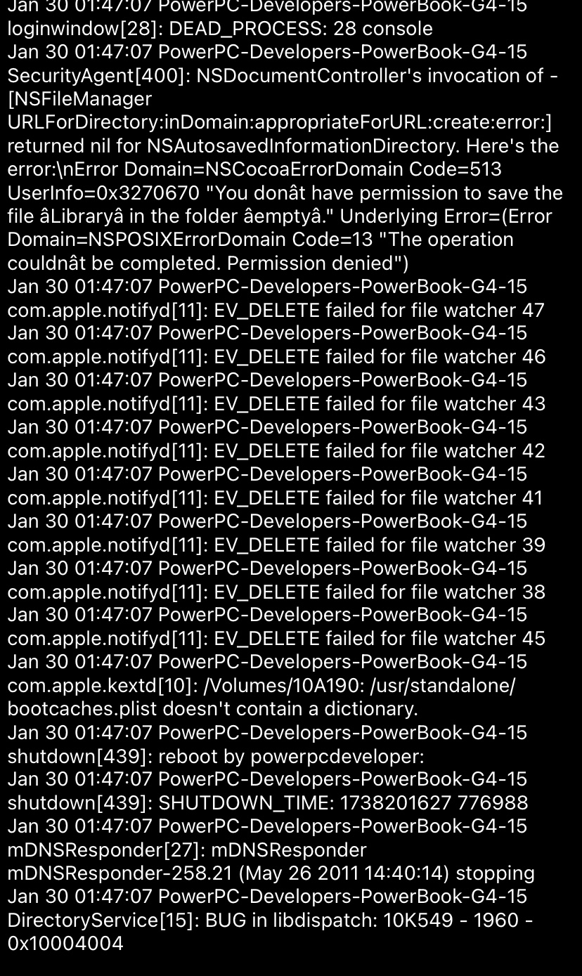

After cloning the image to my 1.5GHz PowerBook, it does this and just shuts off.
Edit: added logs
Could you clarify what is it supposed to boot from? And does it have any peripherals connected?
(Sorry, I have little idea about what normally these logs look like, but those attached appear strange.)
It could be worth trying to boot from a FW drive to see if it fails in the same way.

Hi @Project Alice
Your kernel log seems to be failing when trying to load the version of pre-linked kernel and or kext cache based on my system - those are the references to ‘PowerPC Developer’s PowerBook G4’.
Try deleting the caches and it should generate fresh ones for you and hopefully boot successfully.
The other warnings and errors noted in the System log will need to be investigated, especially the ‘BUG’ with libdispatch.
The image should boot from internal drives and external Firewire drives but external USB drives are unsupported without manually doing so in OpenFirmware.

It’s kernel panicing because when you restored the image, you didn’t select the ‘Erase and Restore’ option. I made the same mistake, but you must select this option during the restore process; otherwise, it doesn’t copy block-for-block, which causes the error. If you’re left with the drive name you assigned yourself, that’s the issue. After the restore is complete, the drive name should match the Snow Leopard ISO name.

I will give this a shot. Its the internal drive.
And I don’t ever USB PPC lol
I erased the partition, and then used CCC to clone the image to it. Should be a foolproof way. Disk Utility almost never successfully restores images.
That doesn't work either, and resulted in a KP on my 15" PowerBook.
When I used Disk Utility to Erase and Restore the image booted fine to my FireWire drive 😉

Hmm. Well I'll try restoring it in DU then. I rarely have success with that though.
Hi @Project Alice
Deleting the caches didn't work either. I will try what Highmac suggested and use DU to erase+restore instead of the CCC method.
