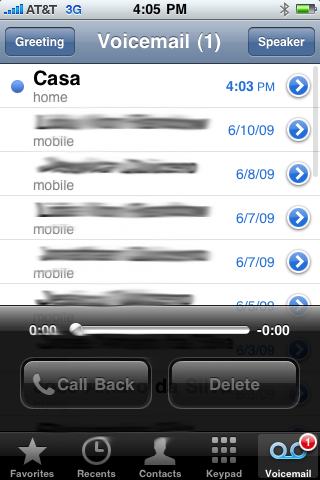

I can attest that Darknight's way works 100% and does NOT disable Visual Voicemail. I will be using this from now on.
However, they will probably charge us for the data even though we have unlimited data, just because we are tethering.

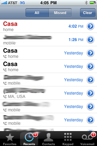

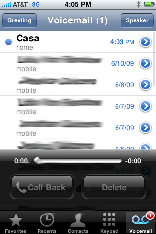

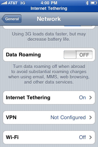

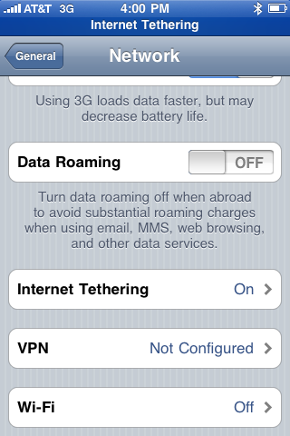

here are the pictures to prove!
My VVM works fine!

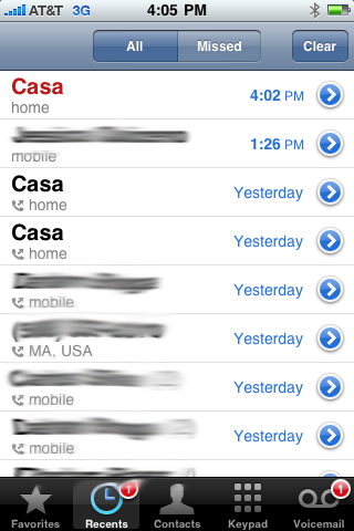

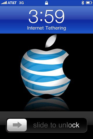

My VVM works fine!
Question... what ATT carrier file are you using? I had 5.0, but now back to 4.0. Curious because I see in your pics, as well as mine, there is no Cellular Data Network slider tab. I had this before. I still have tethering and MMS, tethering works, so does VVM.
I wonder if it's because I re-installed BenM.at's mobileconfig file after going back down to ATT_US.ipcc 4.0?
