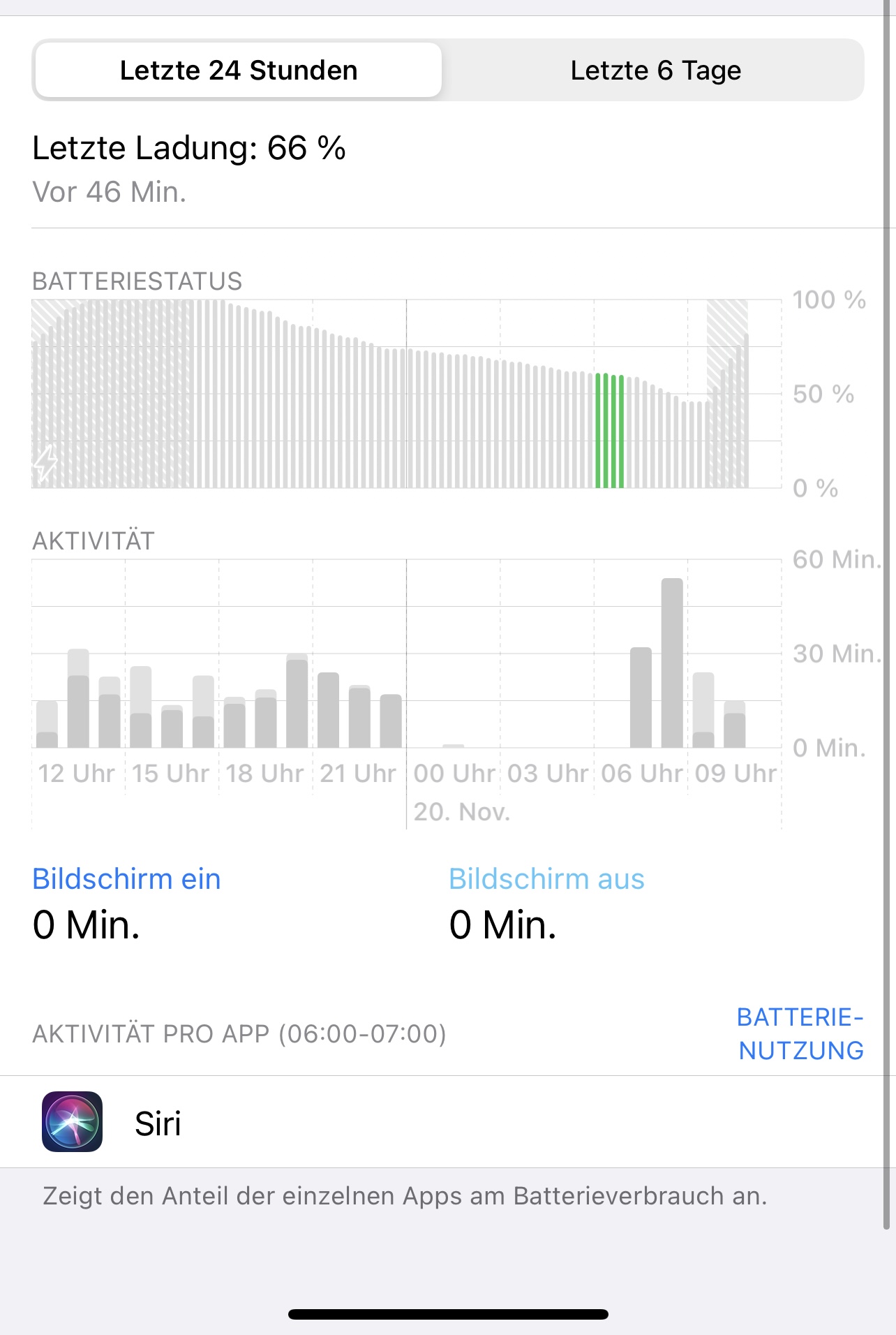

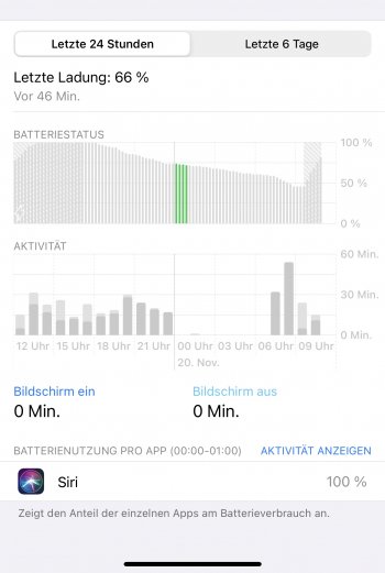

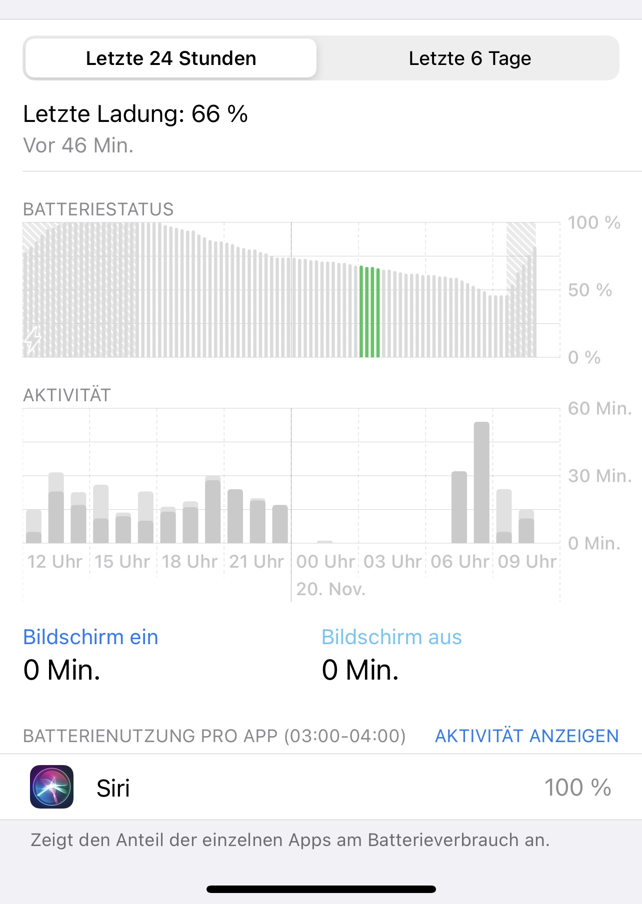

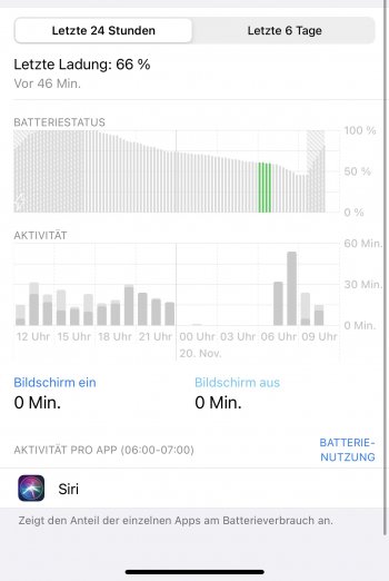

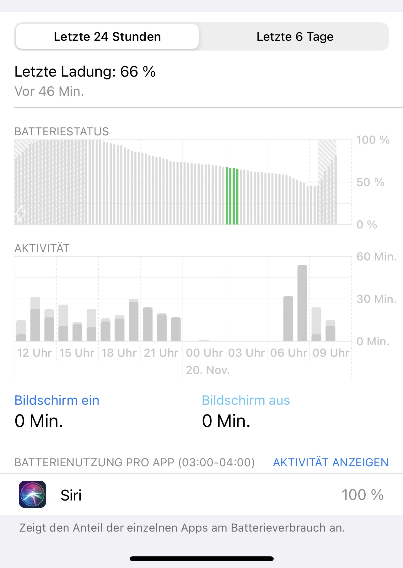

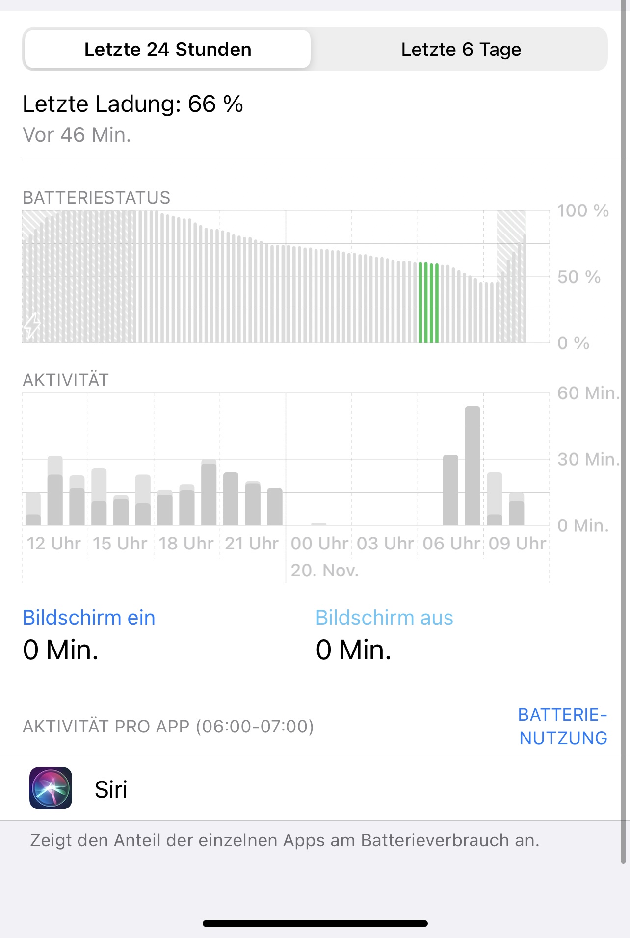

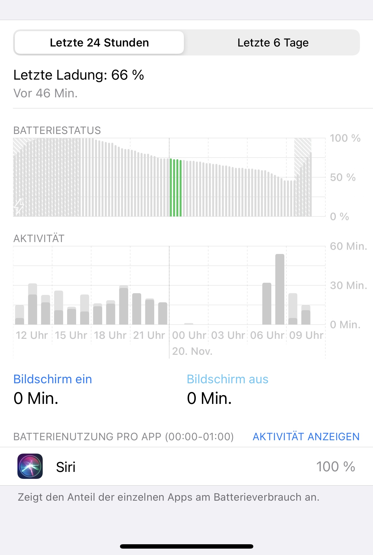

Just checked again and the only thing I see is Siri randomly showing up three times last night. I deactivated Siri completely now. Let’s see what it shows tomorrow morning

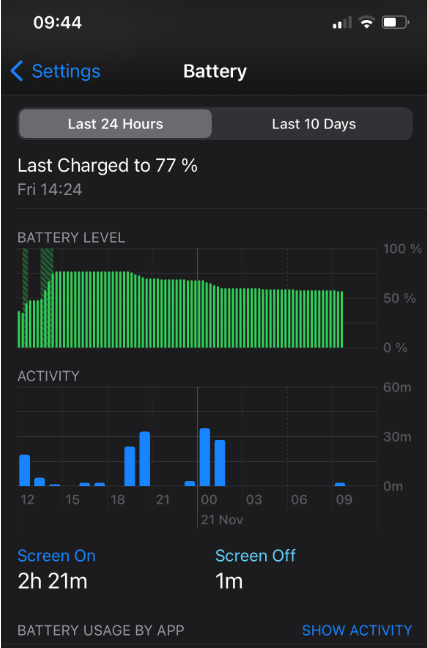

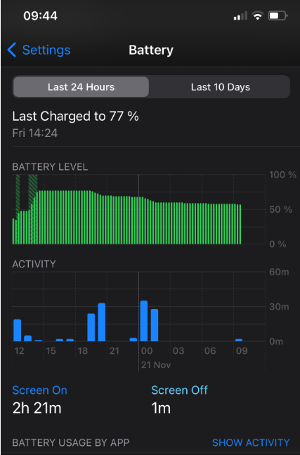

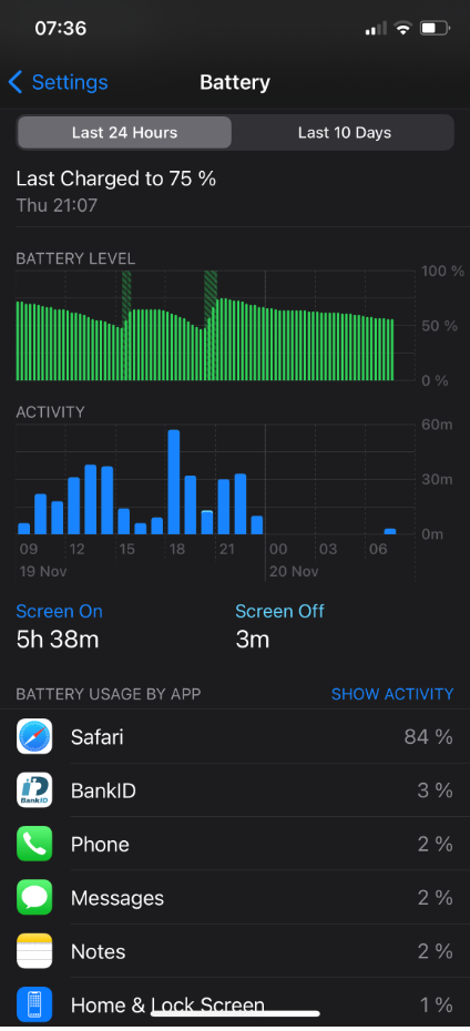

This in a screenshot of the battery consumption this night on my iPhone 12. It went from 69% -> 56%, a 13% loss between around 23:50 and 07:00. At the same time my wifes iPhone SE (First gen) dropped 1% and my work Android, two years old also only lost 1%. And I have NOTHING running in the background on my iPhone 12.
Similar to mine when not in airplane mode. Lost 8% a night with only Wifi on and no notification nothing and 27% one night with only LTE on and about 5 notifications.

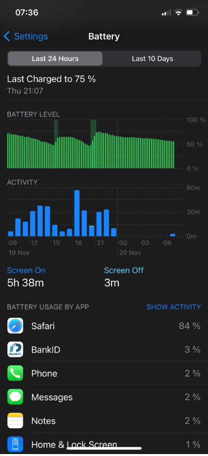

My iPhone 12 Pro max went from 94% to 88% overnight in the same time frame (7:30 hours). The iPhone 12 has a smaller battery percentage wise the difference translate into a smaller variation in mAh / energy consumption.
