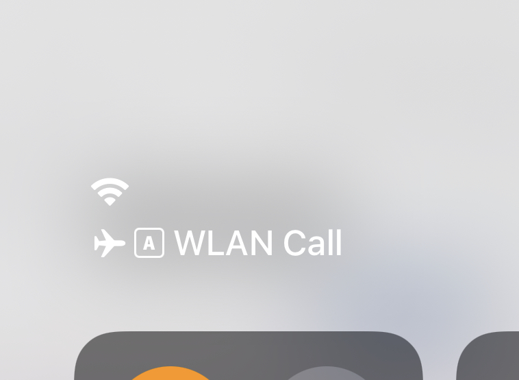

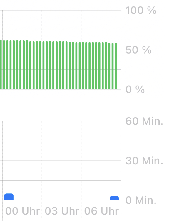

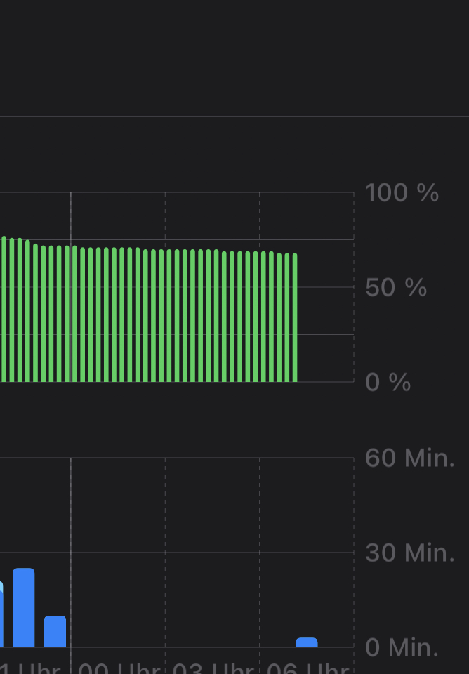

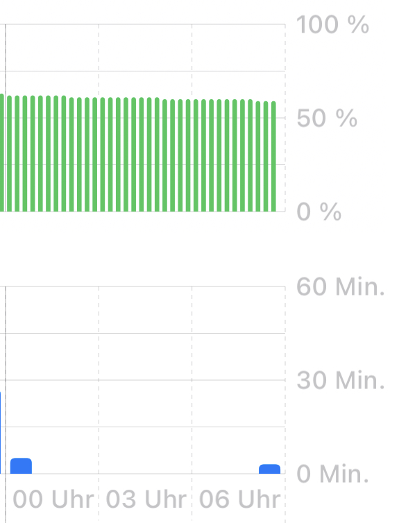

i changed carrier which supports WiFi Calling and therefore decided to just leave my iPhone on airplane mode with WiFi enabled when I am home (which is like 90% of the time thanks to COVID) and my nightly battery drain has completely stopped.
this leads me to believe that the issue is either the modem or at least software related to the modem and not an app or anything like that. At least in my case (12 Pro Max)

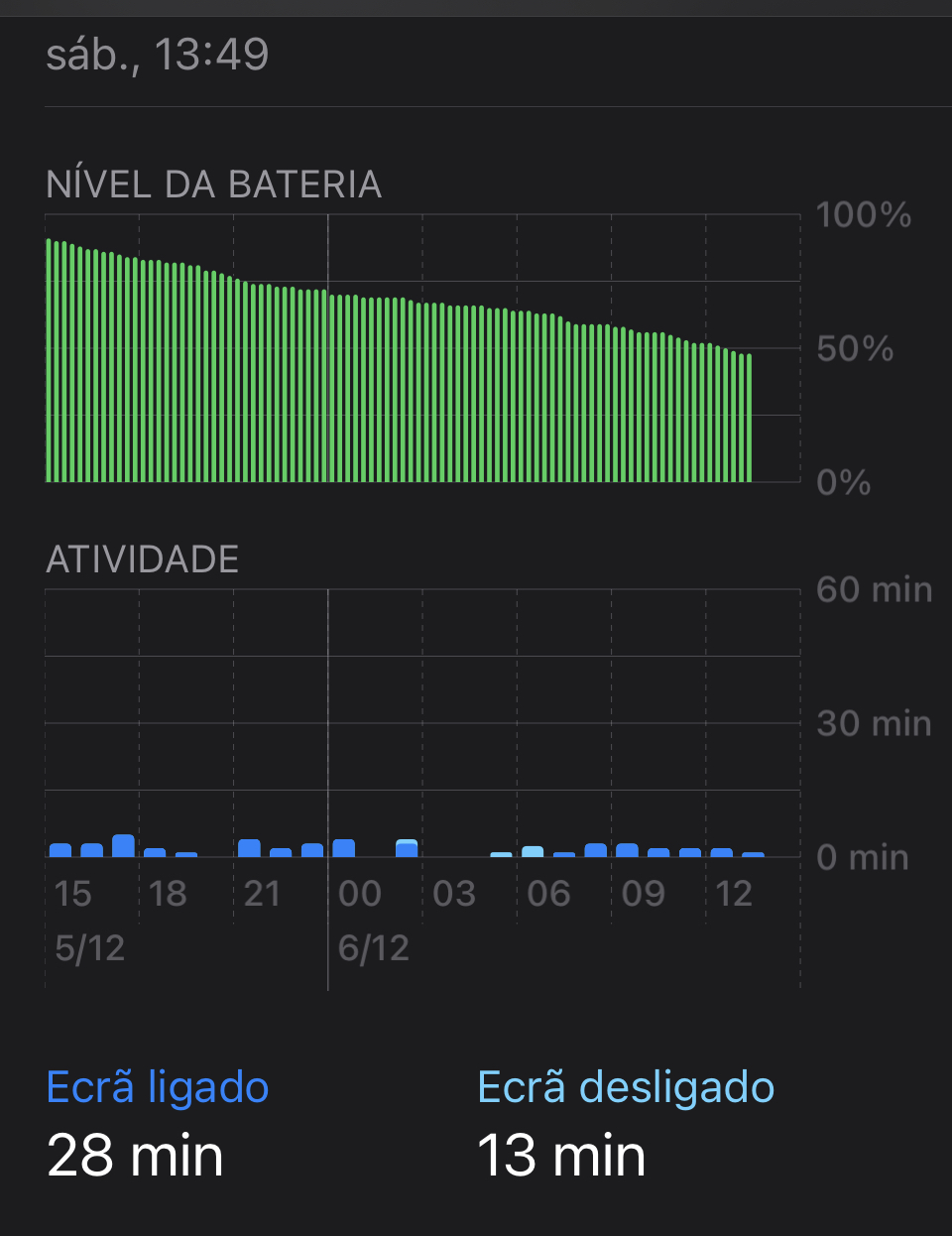

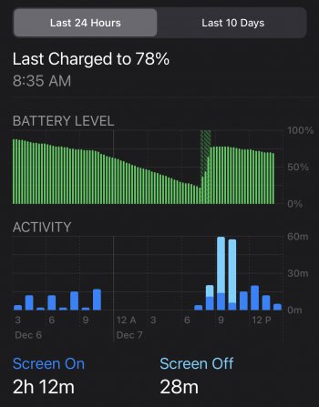

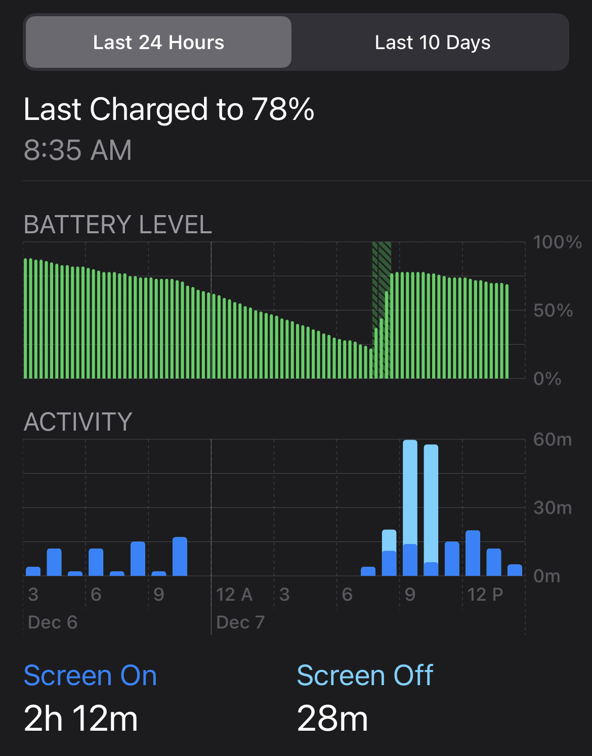

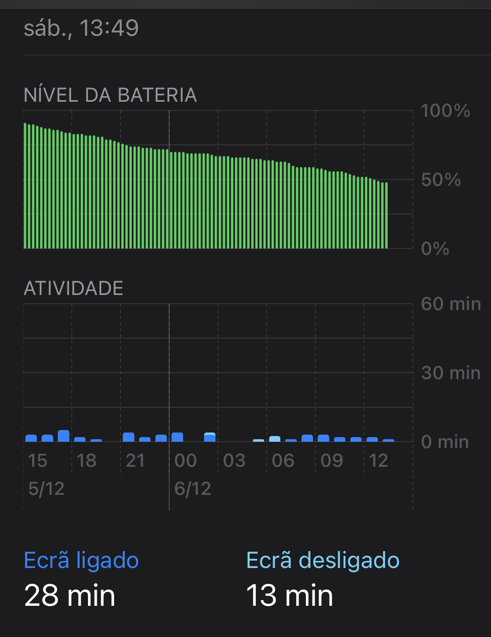

I did this experiment, has now passed 24h since i put the pho down and i only used to check the battery and email entry, So, i have 28 minutes with screen on time and 46% battery...Please!!! this is not normal behaviour !!

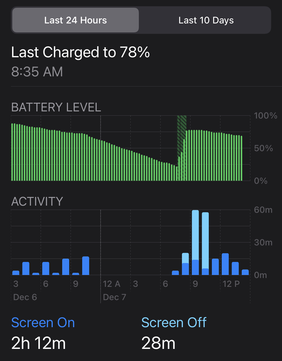

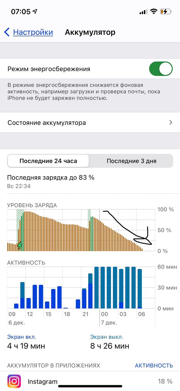

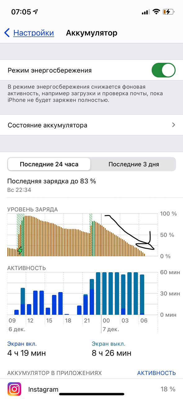

Battery drains faster when I don’t use the phone. 😵

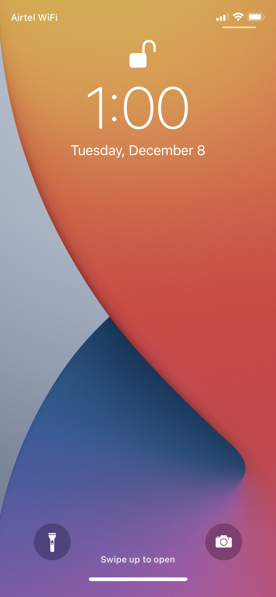

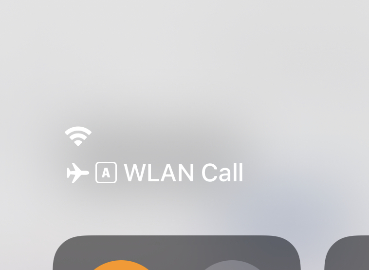

Does it show WiFi Calling in the status bar? Just because you have the setting, doesn’t mean it is actually supported by your carrier. Therefore flipping on that toggle doesn’t necessarily activate it.
Hi. in india, we get to see Airtel Wifi. Screenshot attached.
Airtel is the service provider for me.

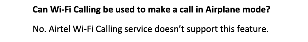

Okay, I may have an answer for my case; ended up speaking to the tele-support and was forwarded 1 document.
Seems, my service provider - Airtel doesn't support making calls in airplane mode. :-(((

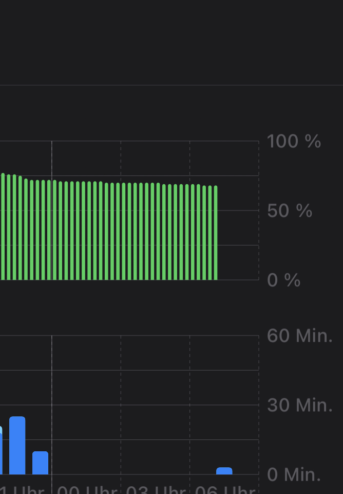

When I go to bed I’m normally at 45% and with the 20w charging I haven’t charged my iPhone overnight.
When I go to bed at 45% and wake up usually 6 hours later battery hardly moves, maybe 43 - 44%.
