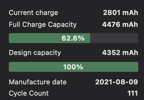

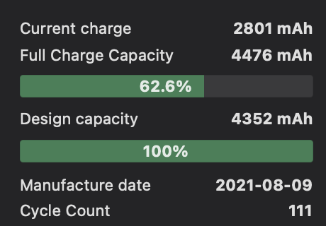

I highly doubt your battery health will go back up again. And I don’t think it is a software bug. Hard to say what causes the drop on battery health. My suggestion is to install the Mac app CoconutBattery, connect your phone via Lightning cable and see what the more accurate battery health of your phone. Might want to consider installing iOS 15.3.

Coconut shows more solid mAh values. What is better beetwen 20 or 12W charger?

What would be interesting is to see what the difference in the battery percentage for iOS vs CoconutBattery after doing the calibration.

Reference, coconut battery reading v others. Perhaps compare it also with what the aggregated log file says ? Just an idea.
