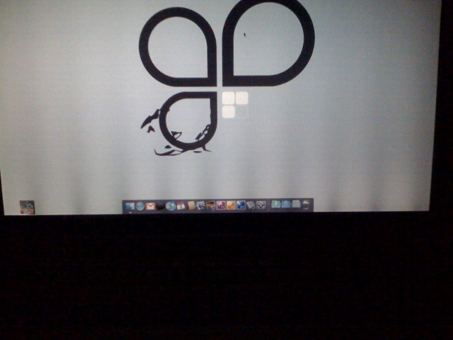

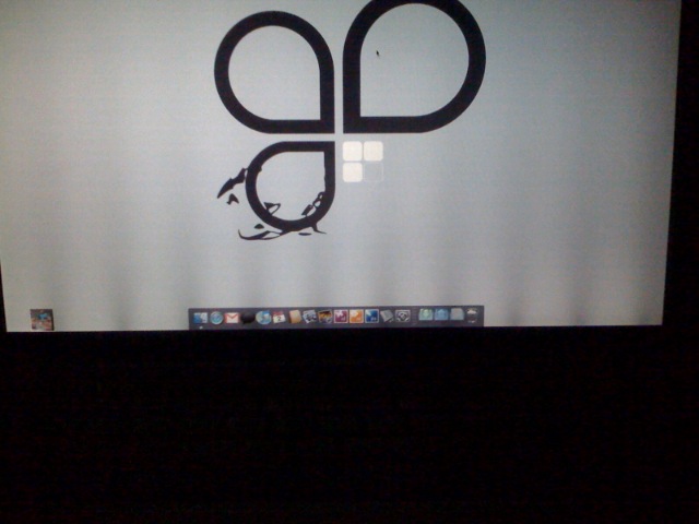

Grrr... So it wasnt just my eyes after all. I was all happy that I didnt have the yellow issue and I could swear something was off about my screen. Although not as bad as the OP's attached pic, my display does have that shadowing thing. I always felt like my screen had uneven lighting when it arrived. And then I do a search and find this post =\. I can bare it for now, if it gets worse, I will contact apple.

I just wanted to let you know that my screen distortion was not as bad as the photo suggests the photo makes it look a little worse than it actually is but it was still very noticeable

same here, less than a month old 15" machine, purchased in the netherlands.
the problem just appeared out of nowhere. Dimming the backlight all the way down didn't help. Later I tried closing the lid because I remember it was a bit flakey from the start (about 2mm extra spacing on left side between palm rests and display when closed). It felt as if there was was something stuck to prevent the display from closing completely (about 4cm left). I then opened and tried again, this time it closed okey. then opened again and display problems where gone...
strange.

Yes, it did it again. Only once.
The conditions were low light with half a battery charge. The lid was closed and the laptop was asleep. It happened again. After reading the posts I manually put it to sleep without closing the lid. I woke it up again and it was fixed.

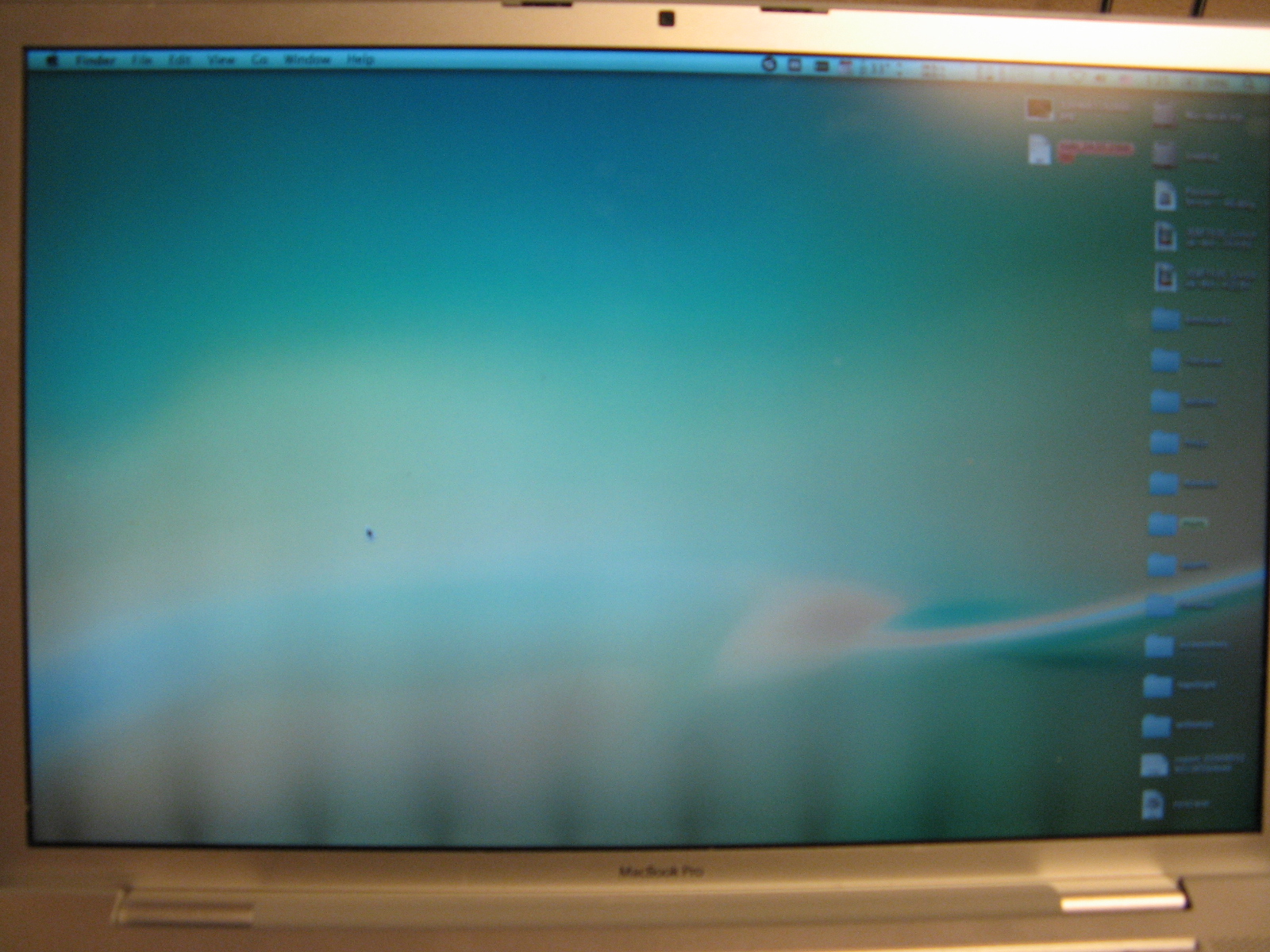

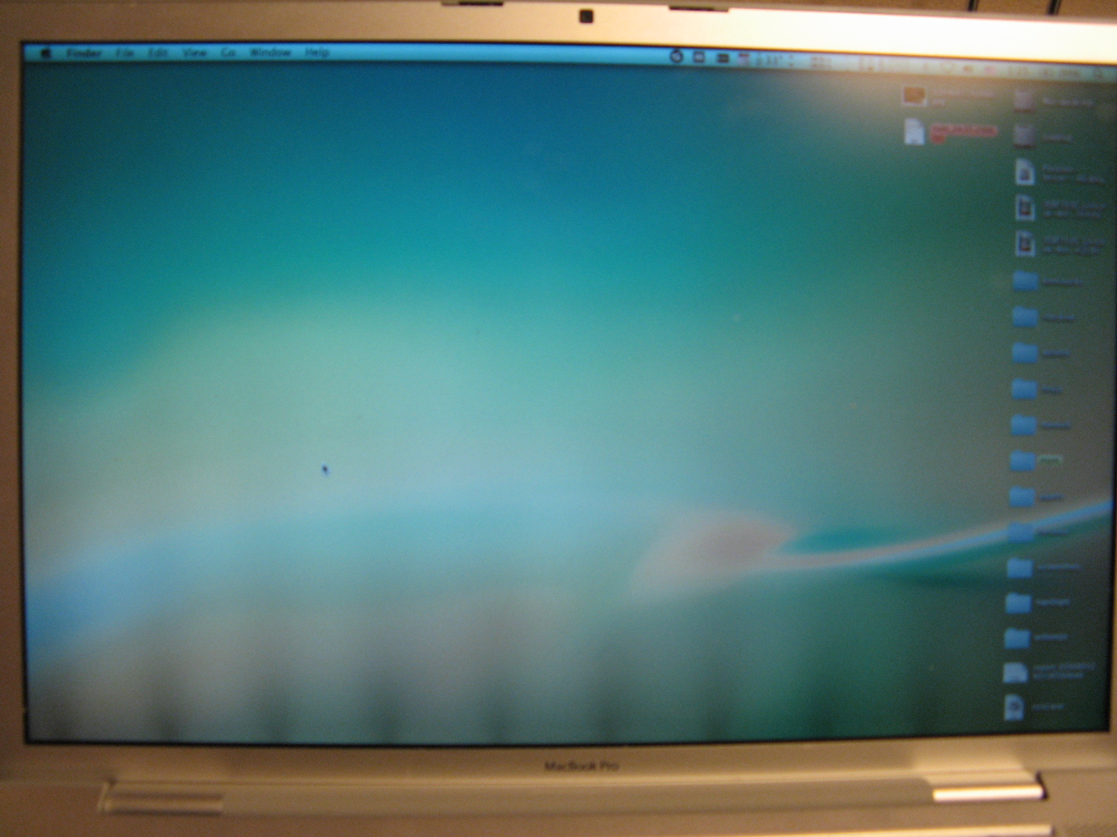

Same problem here on a 2.2 SR MBP with Leopard 10.5.2 and all updates.
I can reproduce the beam lights dimming the screen all the way down and then going back. With the beam lights bright increases are not smooth and there is a screen buzz, higher with higher brightness.
To fix it I just put the screen to sleep using an active screen border (in exposé preferences) waiting 6 to 8 seconds. Then everything is normal again. Smooth bright steps, no screen buzz, no light beams. 😕 To me it seems to be a software issue with screen dimming.

3: And now today these dark spots (excactly like the pictures) appeared when i opened the lid. Disappeared after after reboot..

That's funny! Did what you described when i read it this morning - And bingo, the dark spots appeared! They went away after opening and closing the lid.
But now when i try, nothing happens.
Called Apple Store, and they will replace the Mac with a new one 🙂
