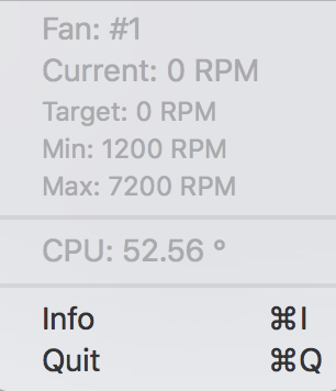

I have a 2016 nTB (i5/16/512) and it is definitely NOT loud and noisy, even at low RPMs. The fan is at 0RPM with a low load and goes up to about 1200RPM when at a higher load, but even 1200RPM is inaudible. My machine rarely goes above 1200RPM.

Like OP ones, but try to connect an external 4K monitor and you hear it screaming.... OP MBP reaches 6k RPMs.

What do you do that your machine rarely goes above 1200 RPM? Simply using FaceTime or Streaming Twitch will get my fan in the audible range.

I only have my 2016 nTB to compare it with and it has been just as quiet as any Mac I've ever had (except my now sold 2015 MacBook, which has no fan). It runs on average at 0RPM for a lot of my workload and goes up to 1200RPM if it is working a bit harder. I don't have access to a 4K monitor to see if that makes the fan spin up more and this is a test I'm curious to run.
I work a lot in office applications, Internet, mail, prototyping software, light image editing, light coding, and iTunes for music. Right now I have Safari with 6 tabs, AirMail, Word, Excel, Axure RP, and Numbers open and my fan is at 0RPM (and has been at 0RPM all morning). I've attached some images and you can see it's not a big load on the CPU, which is probably the cause of the low fan. When I have all of the previous applications open and then also run image editing software and iTunes the fan might go up to 1200RPM (which is inaudible in my working environment). I don't hear the fan 95% of the time when I use the machine.
I don't FaceTime or stream video on my machine regularly. I'll do this as a test to see if it makes the fan noise any worse.
