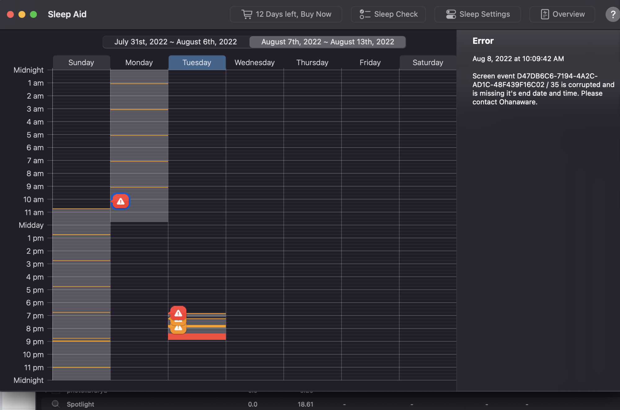

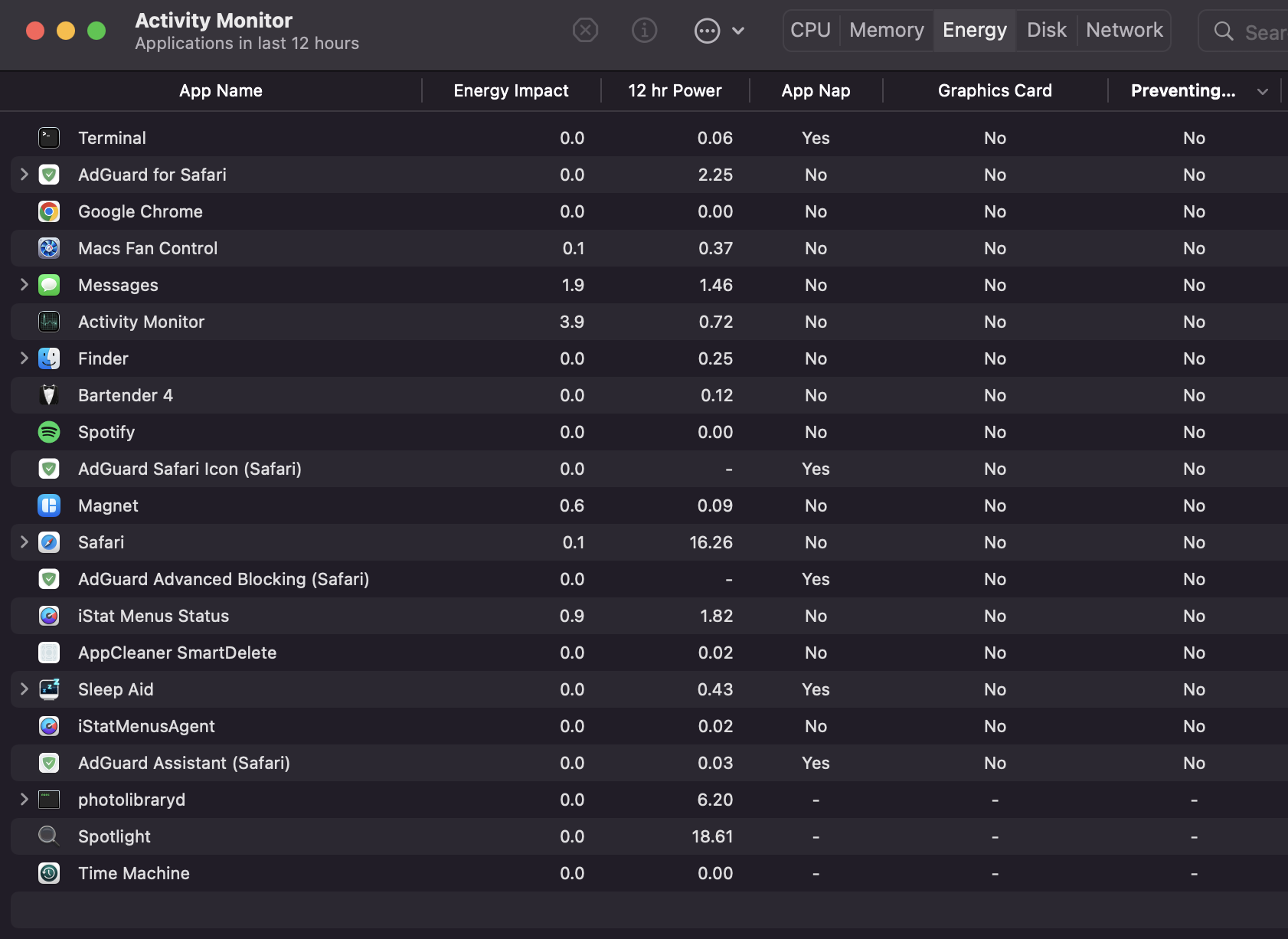

I'm not sure what the exact day is when the battery died but I closed the lid on my computer for like a day I'm estimating and I still have mostly full charge. But then I leave the lid closed for 2-3 days and when I wake the computer, the battery is completely empty. It's drained to the point when pressing power doesn't even light up the display showing the low battery icon and charging from the first USB-C port doesn't even charge the computer. I have to charge it with the second USB-C port. Is there a way to figure out what is causing this drain as activity monitor doesn't seem to report any apps as keeping the computer awake. And I tried using an app called Sleep Aid but it can't generate any logs because of the fact that I can't get it to wake up before it drains fully. I've installed all updates but nothing seems to help.

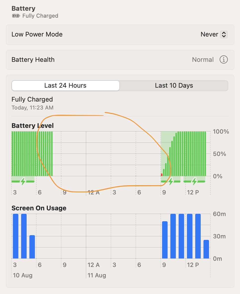

This may be an intel-specific issue but I've been using my MBP for more than 2 years. I always fully charge it before close the lid and head home. This is the first time it drains from 100% to 4% in 12-ish hours on sleep. I had also closed the lid and let it sleep for a week without noticeable battery drain.
I believe the beta 5 comes with a heavy background process that runs on sleep by default which does not work well with intel Macs. I'm going to ignore it and see if tomorrow the battery would unexpectedly drain out again.
Probably need to set Low Power Mode to "Only On Battery" instead of "Never"

I'm not even on beta software so I don't even know why this is happening. It's so weird I go to check after 12 hours the battery has barely moved then I leave it for an extended duration then it's flat.
If you're going to "leave it" for a day or two, why not just shut it down (all the way off) and leave it?
This indicates to me that your MacBooks aren't actually going into sleep mode. It sounds like they are staying active, but probably with only the screen being shut down. This definitely isn't normal behavior.
You may want to check and verify that your sleep settings are configured correctly. You can do this using the PMSET command in Terminal. You'll need to search for how to do this and what to look for.
Otherwise, I'd reinstall MacOS to see if that takes care of the issue.

People were saying SMC/PRAM reset and some were saying clean install. I did both and it appears my issue is fixed. Not sure which one fixed my issue but I guess that's solved.

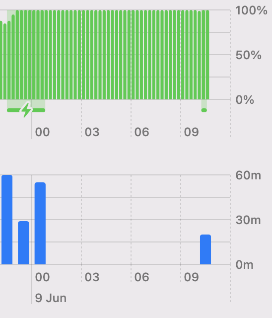

I was having an issue with my 2019 i9 MacBook Pro draining battery after a few days. I turned off screen time, wake for network access and Power Nap. Battery has been lasting days off charger now without drain

So far - so good! Thanks for solution. For now MBP seems to stopped to drain battery even in hibernation mode.
