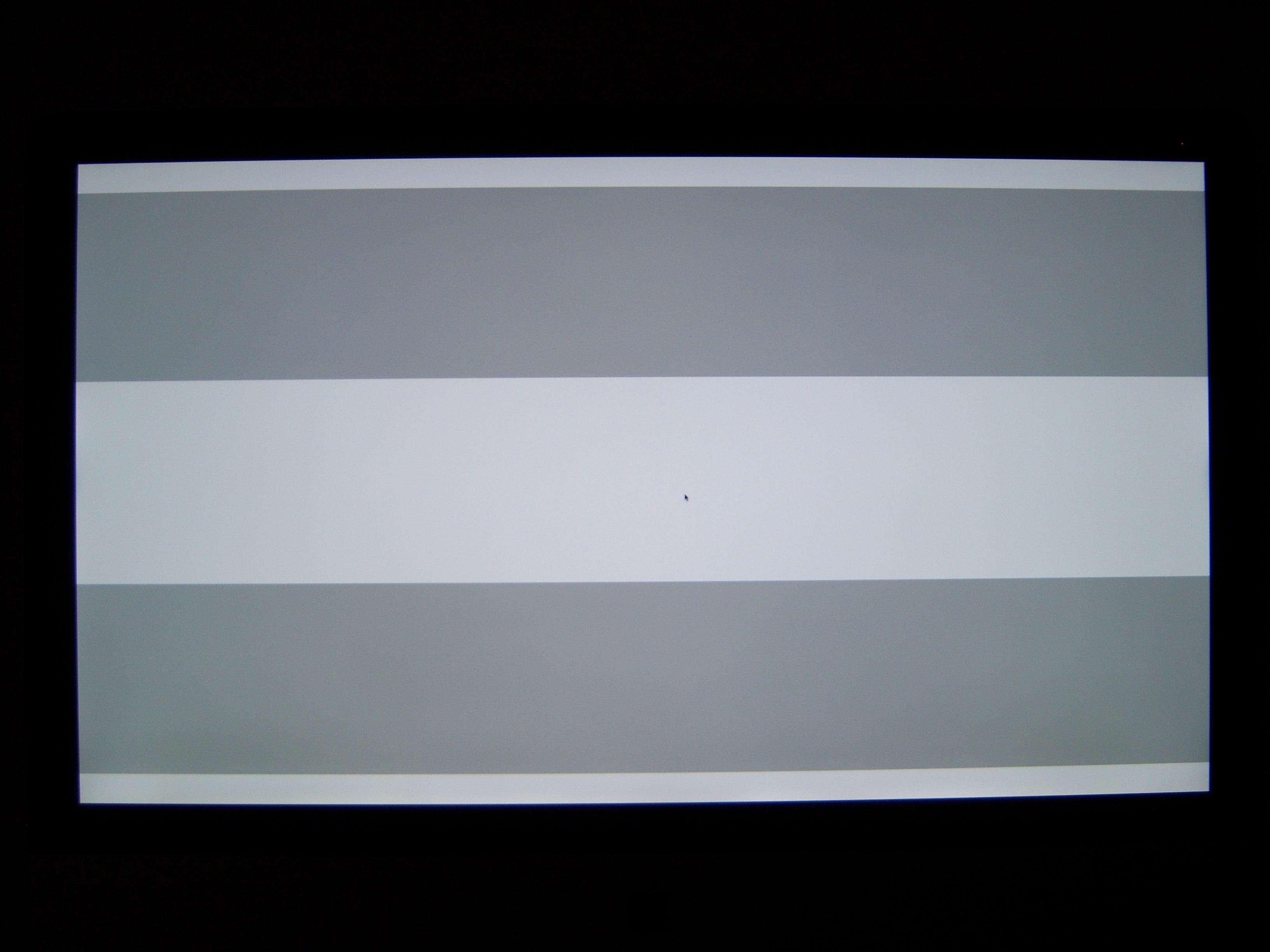

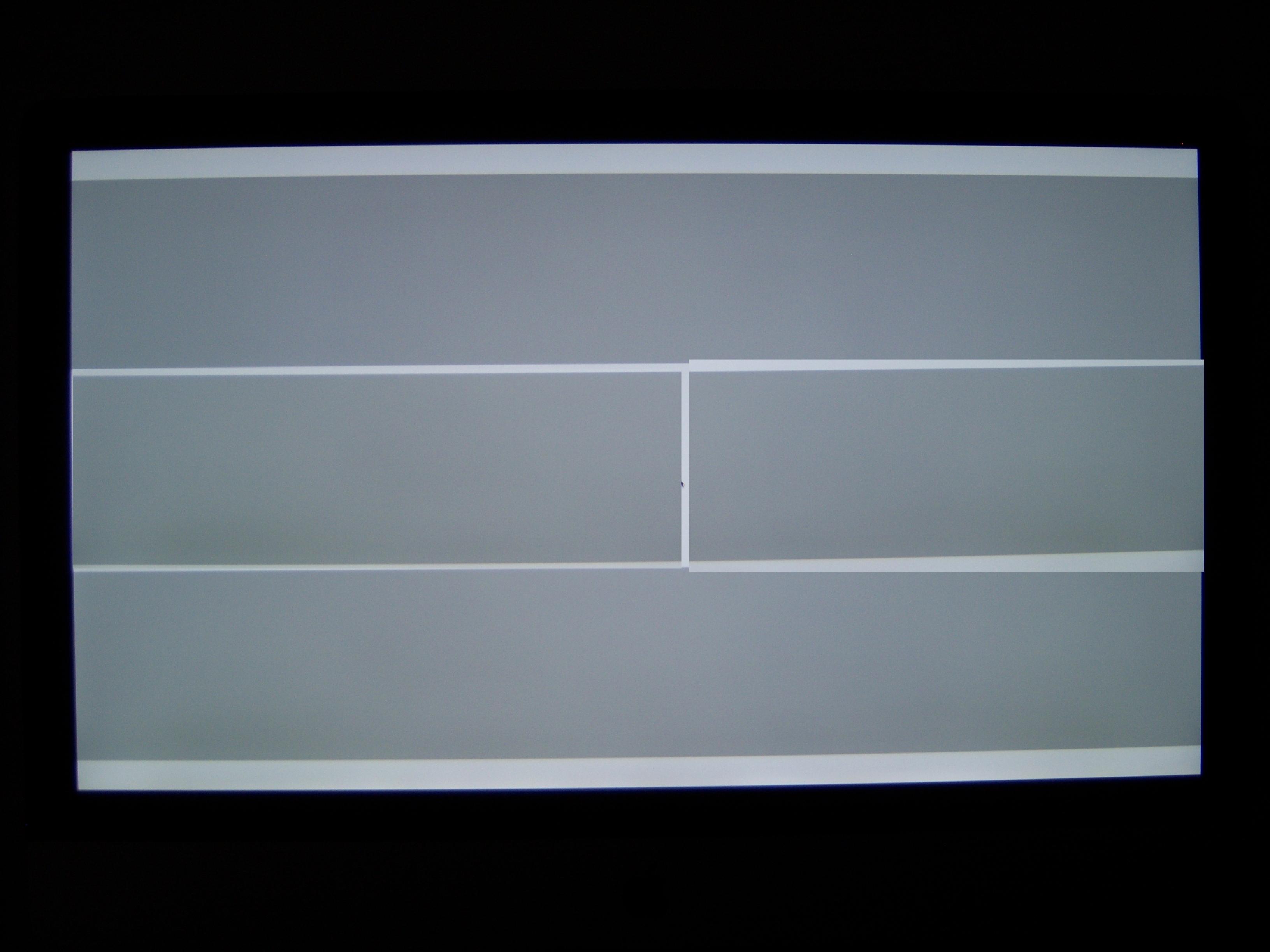

I just received my iMac last week and I can already notice the yellowing across the bottom. What do you guys think of the pictures? In the first picture I copied the bottom bar and moved it into the middle. Is this worth going back and forth with the return process or should I just get my money back? Does it get any better than this?
It seems that viewing this forums really emphasizes it. You can see the difference from the very top to the very bottom.
I had a look at the second picture with my Photoshop and don't really see yellow tinge, but (after adjusting image to neutral grey in the middle) and can measure 5% to 10% green and cyan tinge around the edges, bottom corners being worst (some of the effects may be coming from the camera and not perfect photographing conditions, however I didn't see any reflection on the screen).
Yep, the same old, the same old, but overall not the worst screen I've seen.
