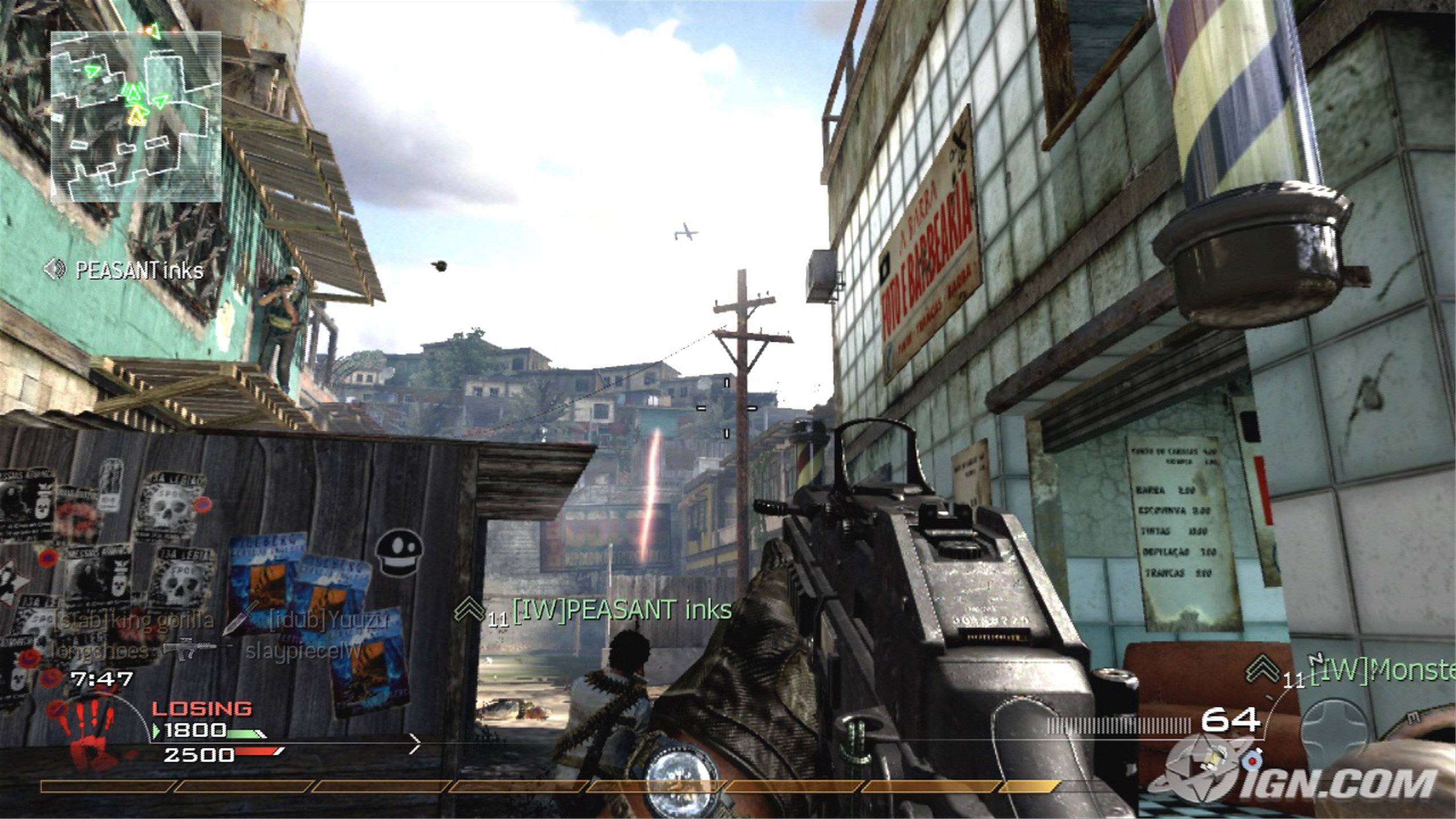

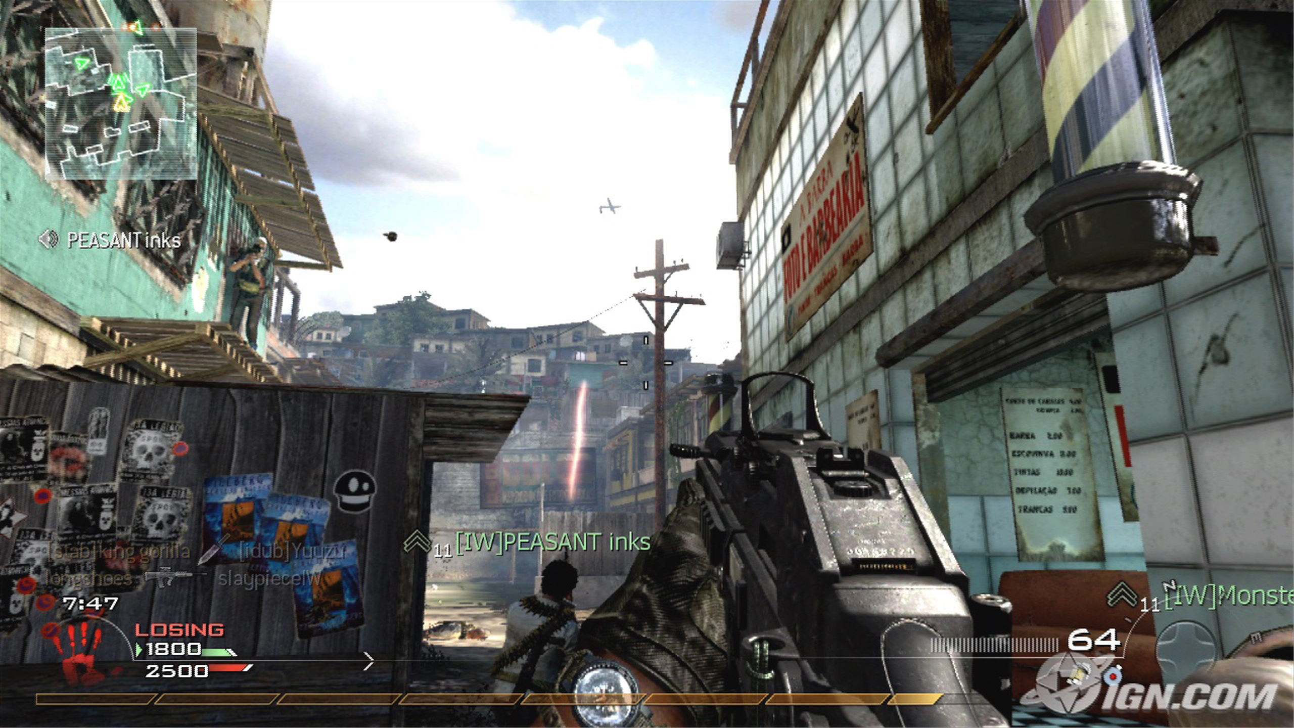

I reproduced the look in afx for you guys on a 720p still from ign.
This is how it look, just show it fullscreen on your imac and decide for yourself!
