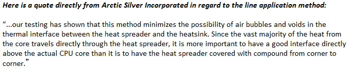

The pea size method is easiest and produces the same result as the line method. Both, however, are good and either will produce good results. Just know, spreading it all over is a bad idea, not only because spreading it is time consuming and messy, but simply because it doesn't work as well. I have attached a chart comparing the two ways - spread versus dollop/line. And also a quote directly from Arctic Silver Incorporated.
Here is a chart comparing the effectiveness of spread versus dollop/line:

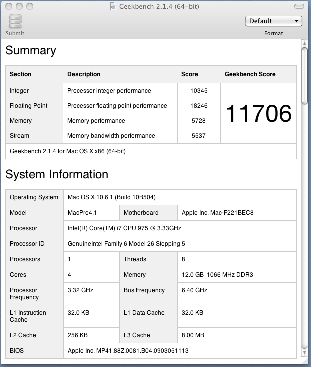

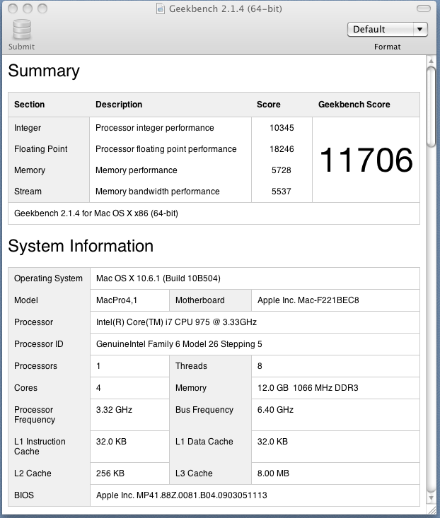

I'm glad you were able to get a refund. I am wondering about the lack of performance you've mentioned. Did you run the latest GeekBench on your 975? What numbers did you get? How did you quantify this lack of performance?
The numbers I'm getting are 15-20% higher than 2.93 GHz numbers posted online, and my CPU clock runs 14% higher at 3.33 GHz. I've read that on Nehalem, when you increase clock speed you actually get back more than what you'd expect from just a linear scaling of clock speed. What I see with my numbers seems to support this, but obviously there are many variables involved. My Cinebench scores are pretty much comparable to those of AppleWorking, who is using a Nehalem Xeon @ 3.33 GHz. Your 975 should have been able to deliver comparable results.

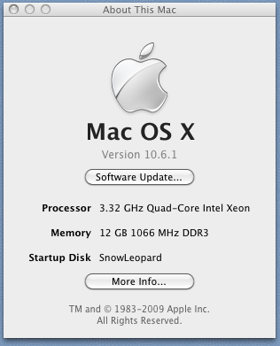

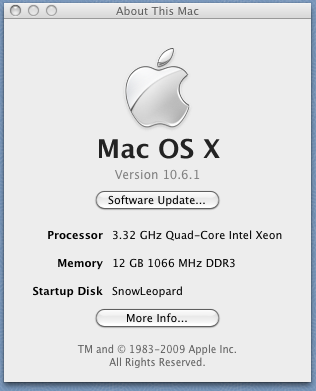

Just upgraded.. Took a ton of photos... I've uploaded the most important one 1st. After the install, as a precaution, I reset the SMC.
Happy to report sleep mode works..
